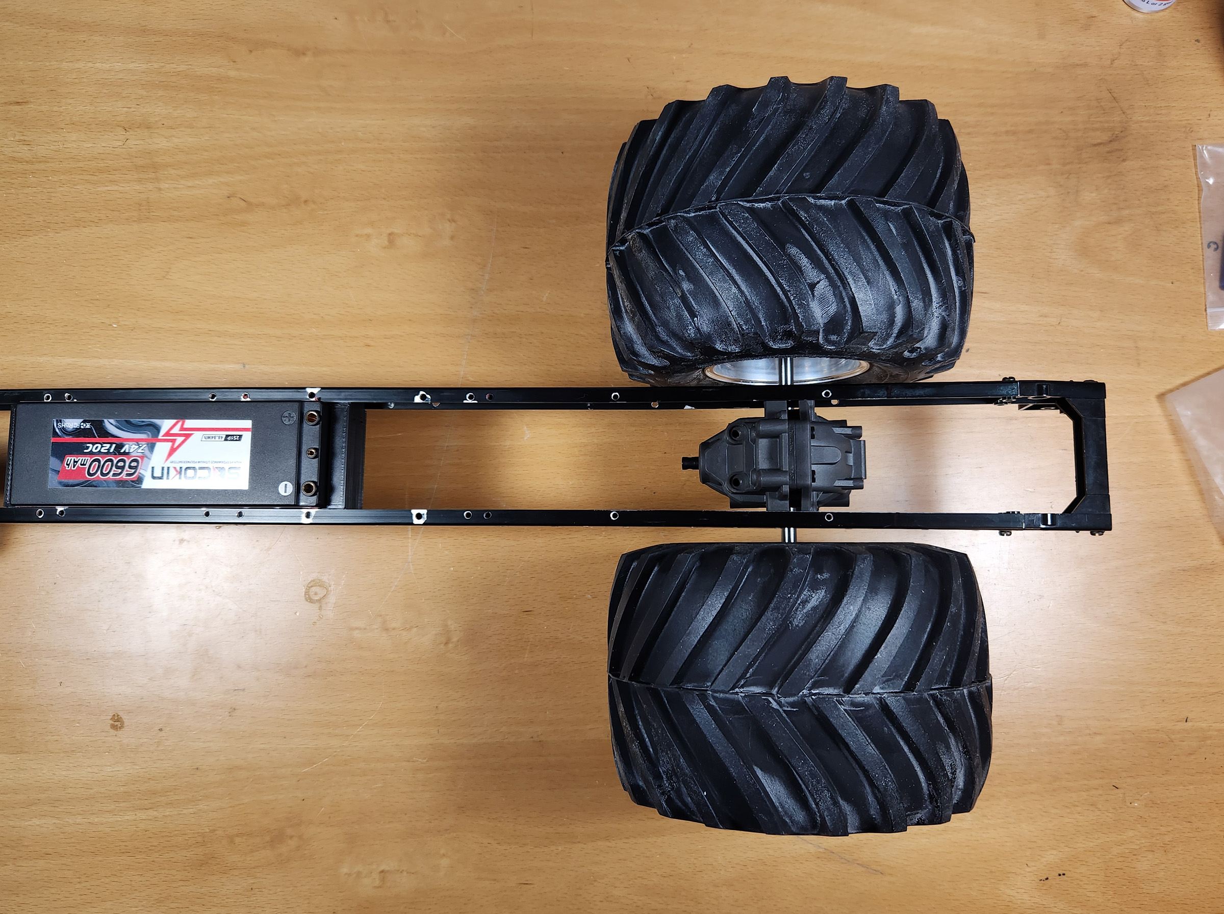

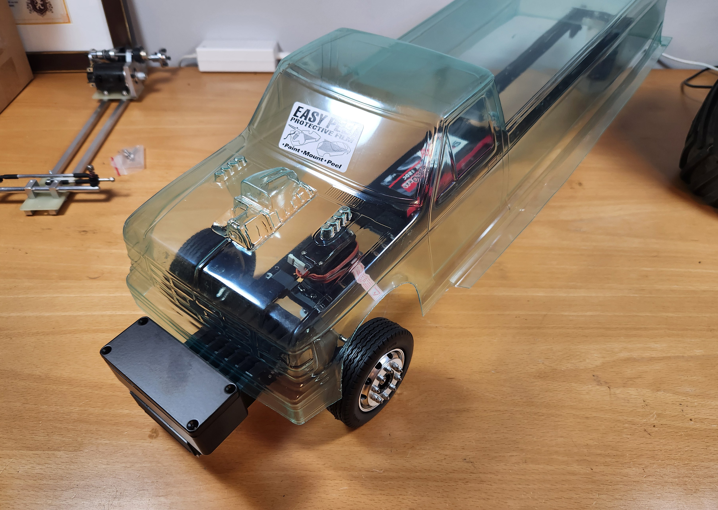

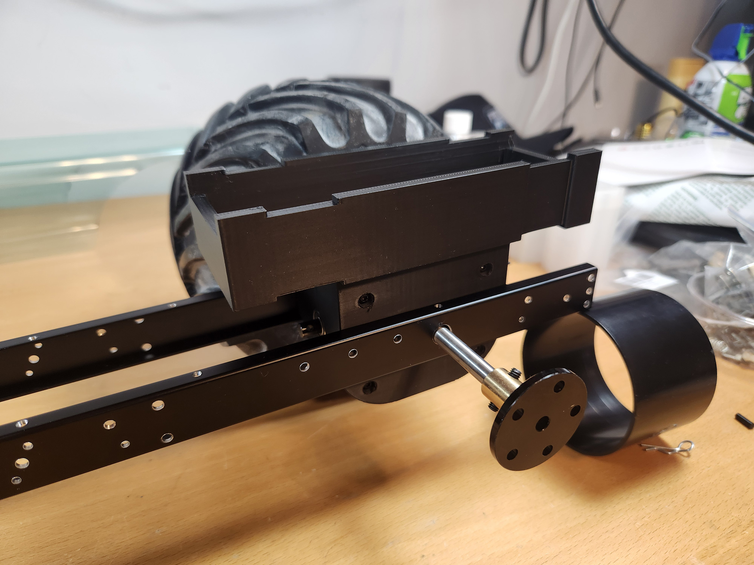

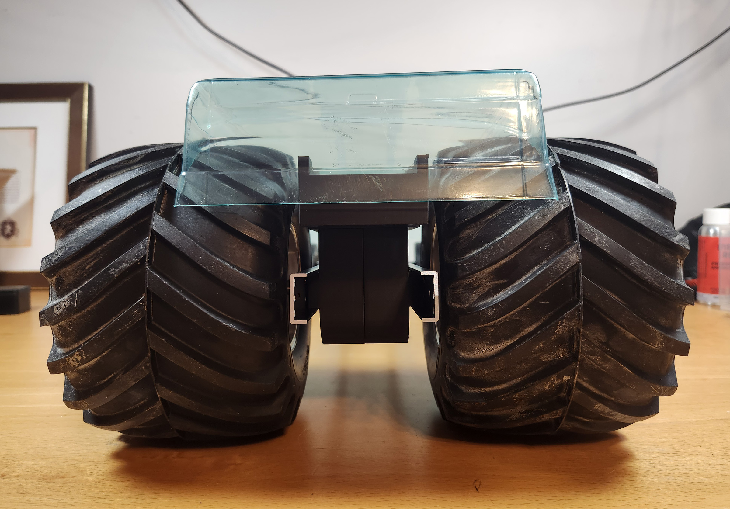

While I wait on some rear end parts, I am just experimenting with other things. I realized quickly that most people build pullers on a simple aluminum plate, and there is a reason for this, it is simple! You want something here, you screw it down there. I thought I was making a mistake with the ladder frame c-channel, but now I am digging it a bit. I am just going over board on the printing stuff, and some may or may not hold up, but it is fun to play with for now. Now that I have a template for parts fitting within the ladder bars, I can just adapt that to whatever the design need is. So, now I have semi SFA mounts, steering servo mounts, lipo mount (which can be moved forward or back depending on weight need and screwed in), and a front weight mount within the chassis. The weight mount can hold pieces of 1/2 steel bar as needed, and will have a steel plate installed on top of it. And then a weight box (just an aluminum project box) will be mounted on top of that for added weight as needed.

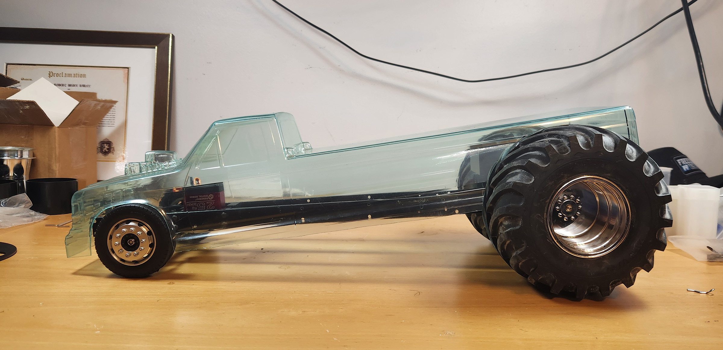

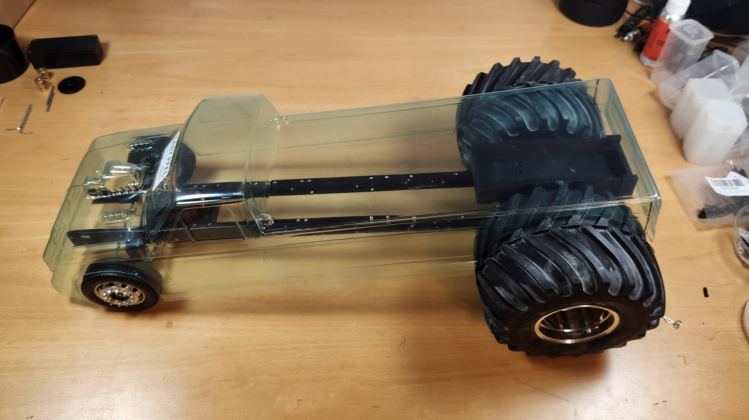

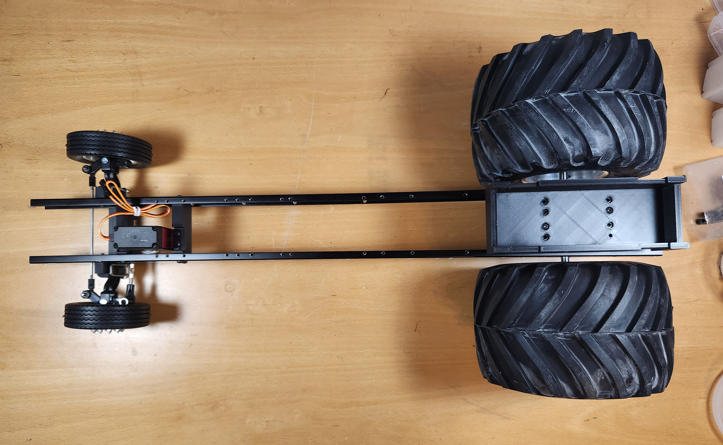

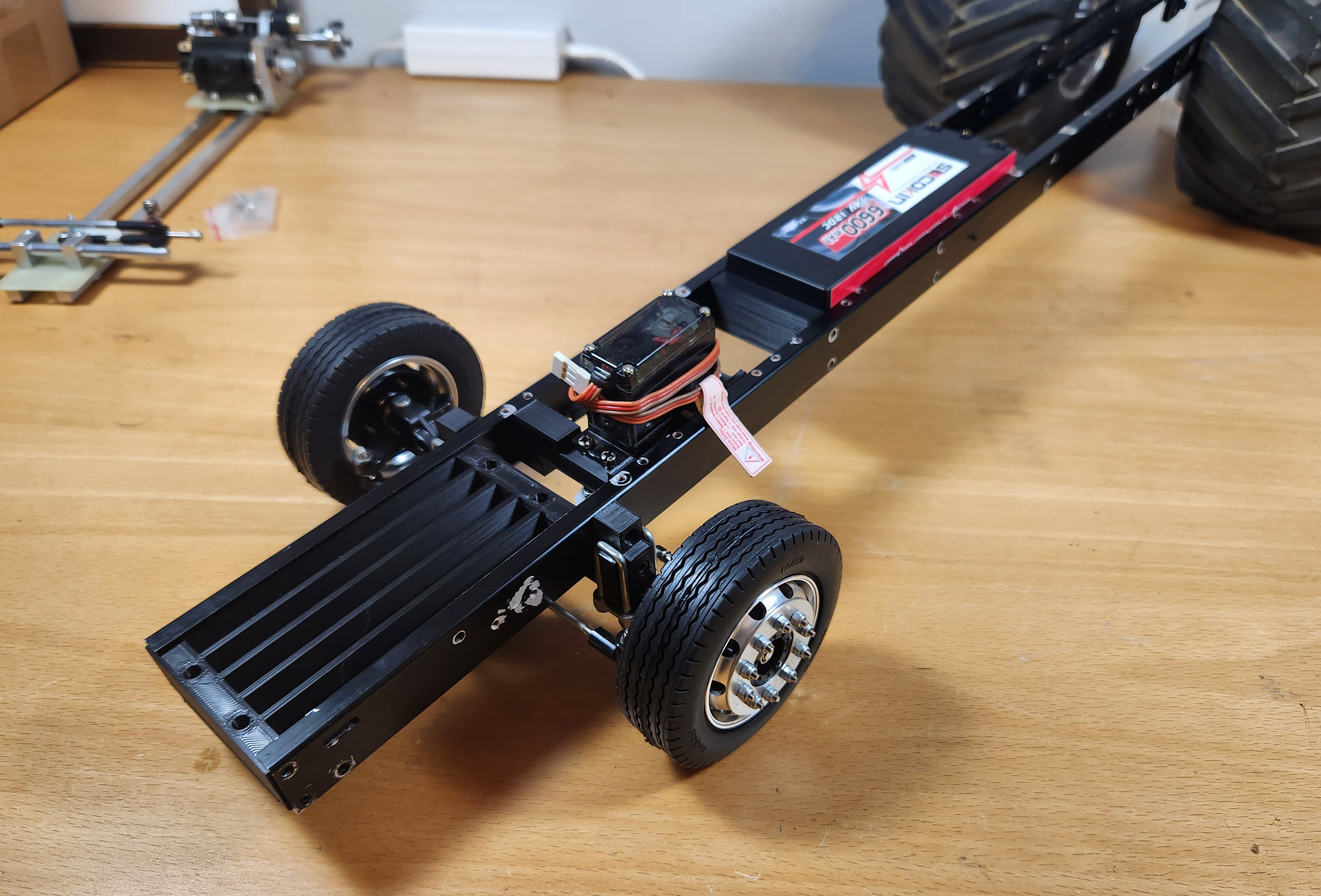

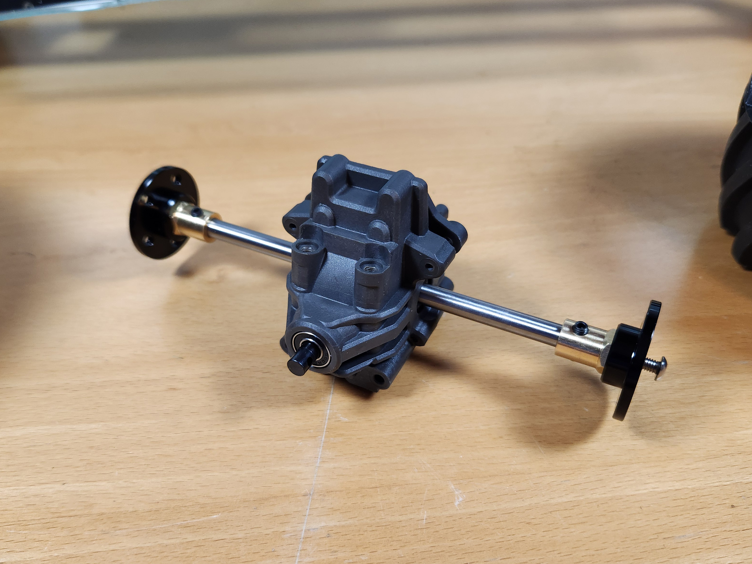

So, for the rear pumpkin, the current plan as of 1936 EST 5/15/24 is to run a Traxxas Sledge differential, with a spool, and 7mm HSS driveshaft to 12mm hex couplers and aluminum Clod wheel adapters. This will probably change, but it is the current plan. I am thinking about just designing / printing a pumpkin case for the diff to directly fit into the chassis. I would love to run the driveshaft under the chassis rails, but I think that puts too much angle on the pinion. The current plan is to put a couple of holes in the chassis, and run the ds through it. This would also allow the highest strength case mounting to the chassis rails.
Who knows, I am just making this up as I go at this point. :wink:
Yep, too much reliance on printing, but I like the idea of trying it and seeing what breaks, and can I make it better. I wasn't planning on this being such a print-centric build, but I am growing into the idea of it. An aluminum ladder frame and a lot of plastic between it.

I played around a little earlier and started designing the rear pumpkin. This is a mock up piece, just working out dimensions. The final product will be much beefier.

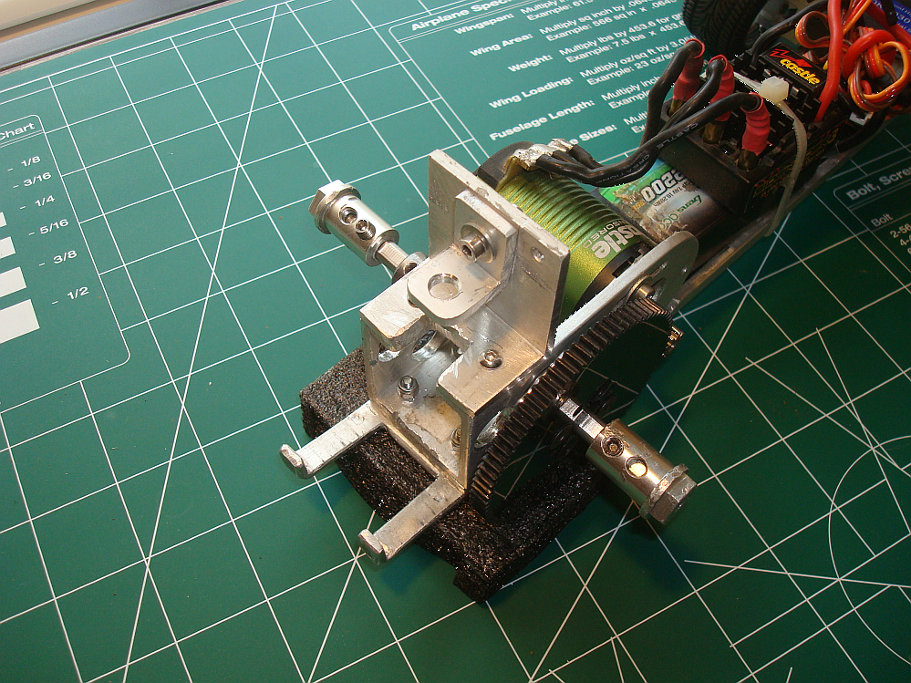

In order to get onto the track quicker, I decided to look into building a Slash Class puller. After looking into a couple of things I would do to a used stock Slash, I decided it would just make more sense to start with a Drag Slash (especially with a C10 body) if I could find one on FBMP for the right price. So for half the cost of a new one, I have a Slash that really isn't all that far from being a puller. I already have some WW2 wheels and tires for the rear, and some Losi drag fronts that look better than Traxxas ones. Need to lock up the suspension, at least the rear. Raise the rear body mounts to clear the tires. Figure out hitch and weights mounts, and then start looking into electronics.

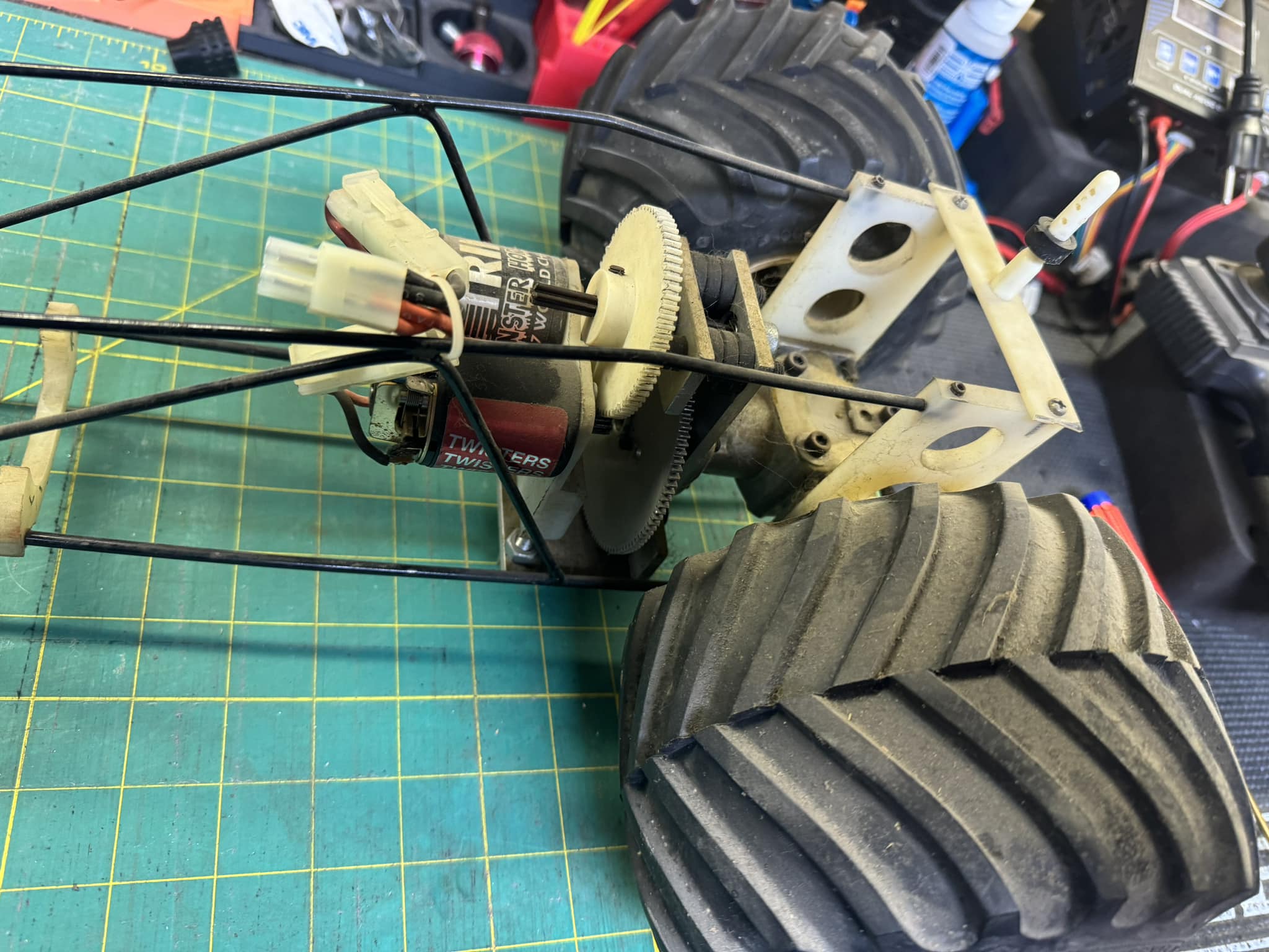

Ran across this rig during my research tonight and it made me giggle a little. The gearing set up is what caught my attention, but the motors are the prize.
RC10th
Posts: 4705
Has thanked: 50 times
Been thanked: 1495 times
Re: Let's Talk Tractor / Truck Pulling
Post by RC10th »
That's cool !
Do pullers suffer from torque steer with inline motors like that or is everything too "slow" for it to be an issue?
I wonder what their reasoning was behind mismatched motors, or more a case of one died and it was to finish an event, or just put whatever in it to sell.
And seriously.... Tamiya plugs?
