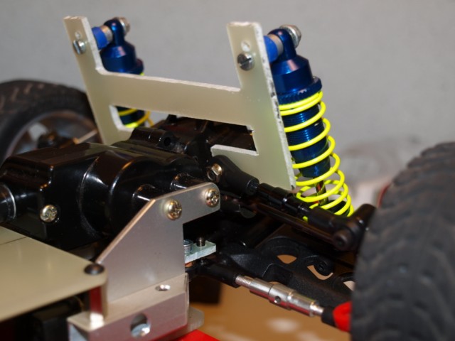

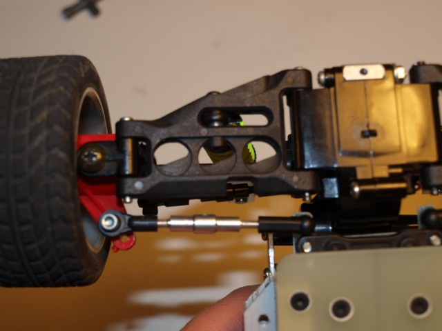

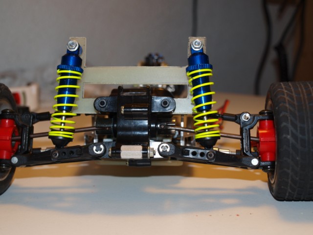

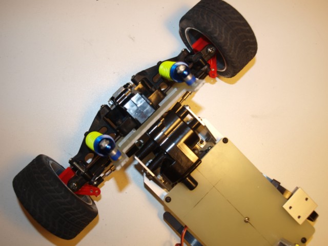

The front axle is ready. I made a shock tower and adjusting the steering. I am very curious if this solution to the wobbly front suspension of the Boomerang was ever tried. I do not have a large selection of machines and I've been looking for something that I could use, without great cost and processing. I found after long search, a very promising combination. The new front axle is made completely unchanged parts of Kyosho Ultima and Tamiya TA01.
But let us rather have fun and talk about the progress with the Boomerang. I'm really excited about the firing motivating comments from you all. If I find time tonight, I'll submit some photos. I have indeed done something at the weekend.
Re: neighbour killed my boomerang ! The resurrection
I'm back !
As promised, the pictures of the front axle. I used Ultima suspensions and the TA01 steering knuckles. Both matches without having to rework something! The drive-bones come from a Hotshot 2. I thought these were the same as the Boomerang, but they are about 1mm shorter and work in this combination better than the originals. Could be coincidence. The shock tower is made by hand and later worked even better. The dampers are 70mm long and are soon replaced by others. The colors do not please me and I have not the right sleeves to fix them up correctly. But they are good to measure the distances and see the ground clearance. And YEAAH !! The suspension works completely neutral. Just as I wanted it. The straight line is not changed during compression.
Check it out !

These front arm mod is excellent. I would love to do the same for my hotshot but sourcing ultima arms is more than a challenge to me.
The real problem is that I would be left with 2 sets of hotshot front arms in my parts bin...
