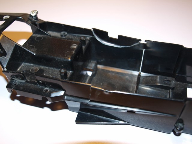

My first one was stolen and now my " new " boomerang is distroyed while the first testdrive. My neighbour knocked the Boomerang down by his 1:1 car.
But, what a pleasant surprise ! The only part which looks irreparable is the chassis !! My neighbour hit the car exactly in the middle.

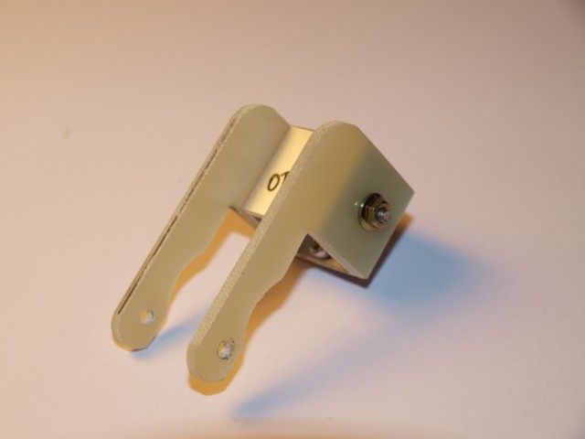

But then I decided to build something unique. A chassis without the negative parts of the original. Better steering and improved front suspension.

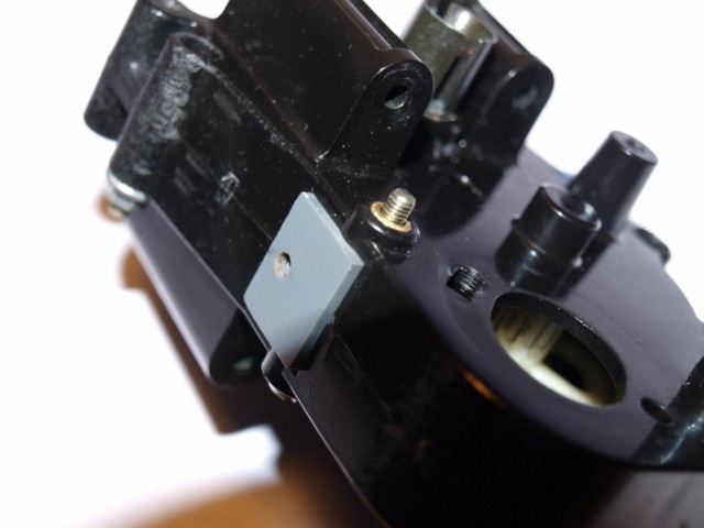

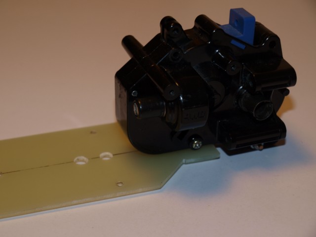

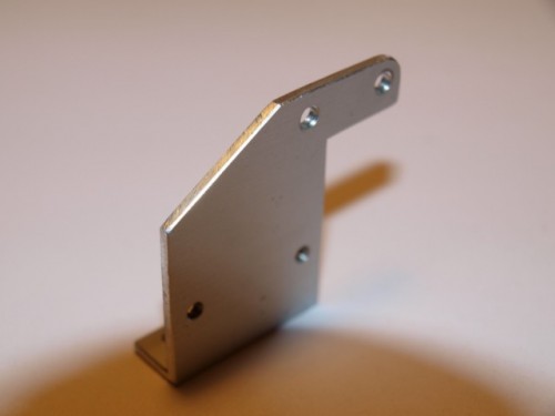

Then I thought about how I could fix the rear gear on a base plate. This is my solution.

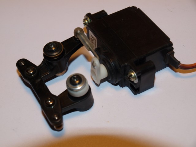

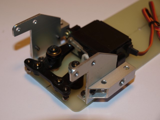

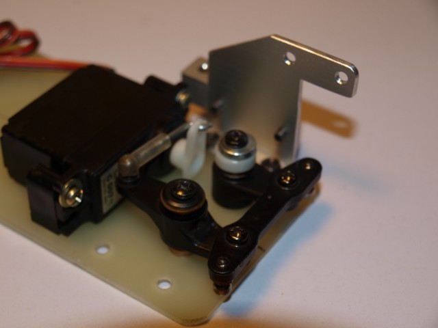

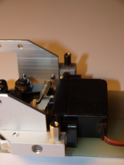

What steering would fit ?
After many, many attempts. TA05 ( Upside down ) is the right thing!

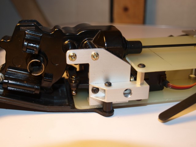

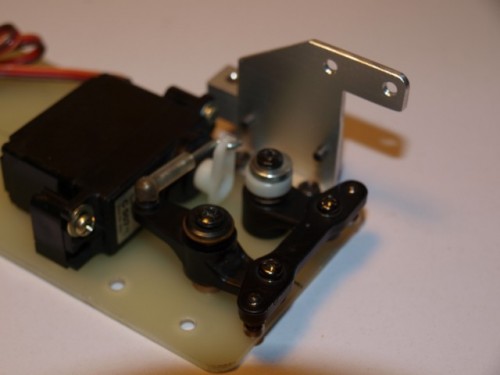

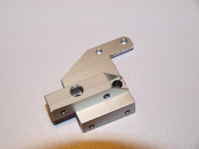

Then the question is how should I attach the front gear housing and bumper? 2mm aluminum angle, a file and lots of patience!

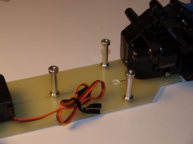

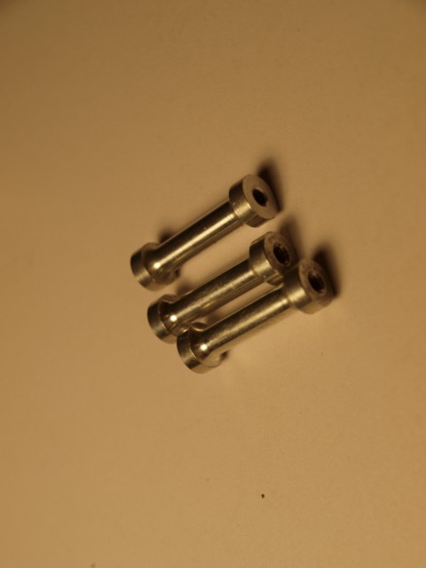

Now I installed the top plate. I used three bolts from the Kyosho Ultima and two 3mm internally threaded bolts.

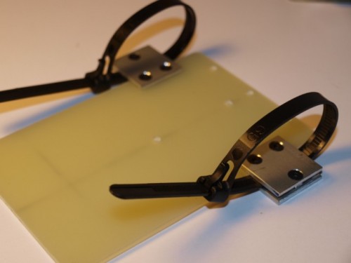

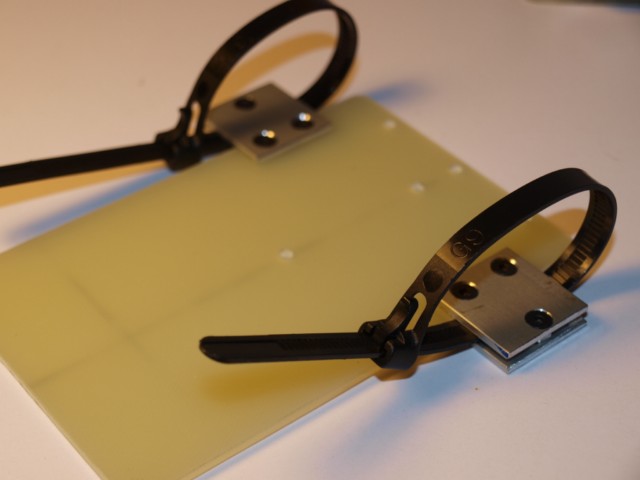

Always a very difficult question. how secure the battery? I opted for a homemade Ultima holder.

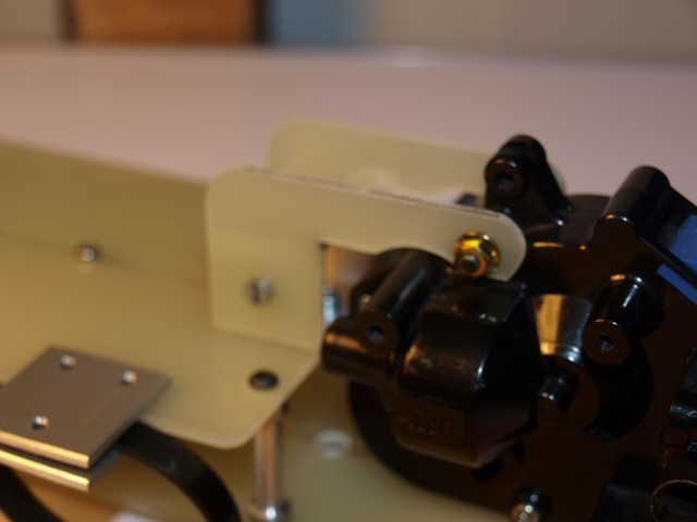

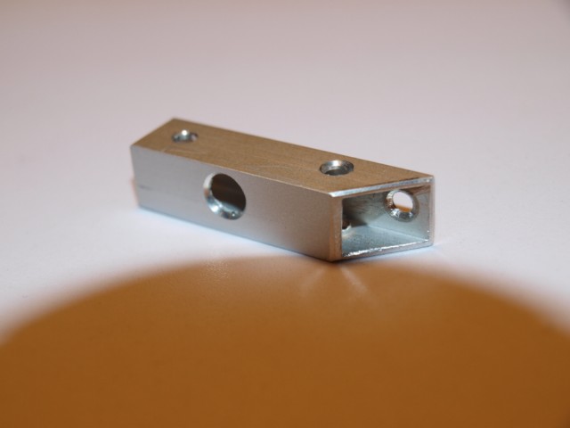

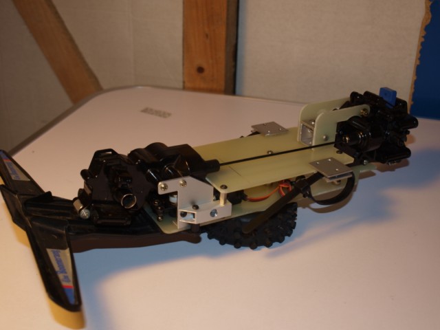

Next Step. The connection of the upper plate to the rear gearbox. I have spent hours, measure out this part right. Many attempts have ended in the dustbin. But now it finally fits!
Re: neighbour killed my boomerang !

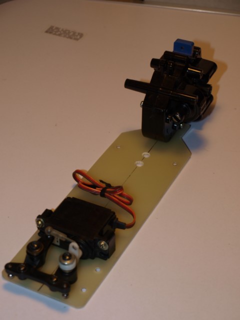

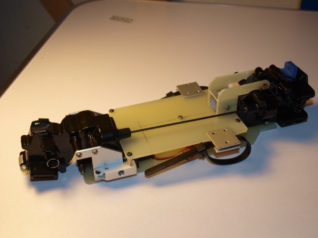

Here now some pictures of the current status. I hope my little picture story makes some fun of you. I would be happy to receive suggestions . As I said, I still do not know what shocks and I'm looking also for the right body.

nice job!!!!! way better than the factory, that is for sure......

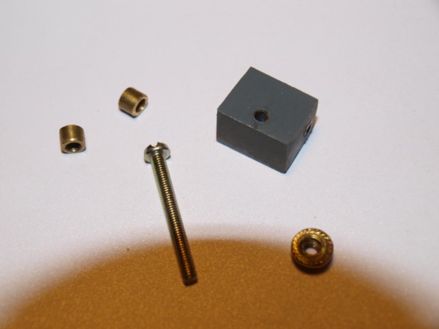

the only thing I would advise to change is on that small block that fits in the transmission. I would give it at least 2 screws to mount it to the chassis, not just one. this way the trans will have a harder time twisting on the chassis. If three would fit, I would do that.

Nice fabrication. I daresay there's not much Boomerang left in that build....
