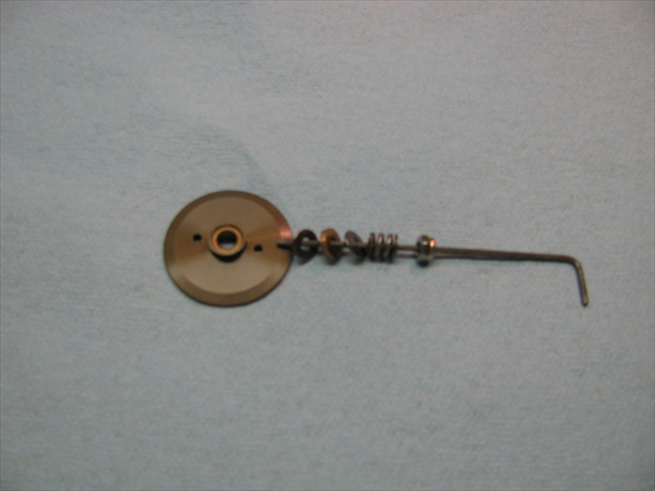

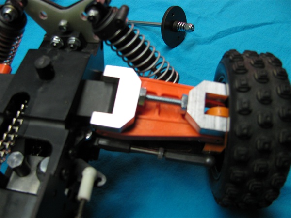

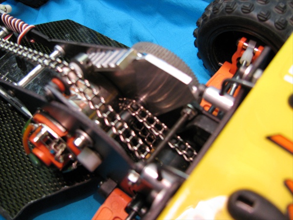

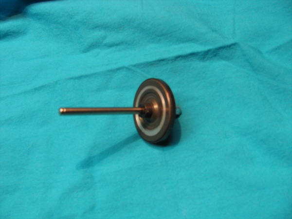

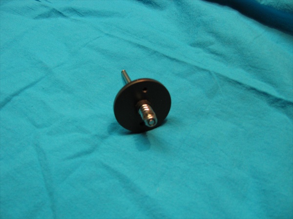

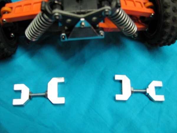

Well here are some pics of the slipper ,motor heat sink and some adjustable top arms I'm working on. Some would say I'm lucky Jason but you guys and your get togethers and friendships that's lucky.I can run all day on my track but with out other guys that want to run vintage like we all do it's not as fun. on the slipper I used a schumacher disk with a 4 by 8 bearing and 1 brass washer 1 steel washer to slip on like the later stealth had. I'm not sure how the top arms will work I hope they hold up

Thankyou for the pics of the slipper Tony. I was thinking of running a Schumacher slipper set up but wasnt sure which shaft to use. Did you custom make your shaft?

Yup! the original stealth slipper had thrust bearings then they changed to a brass washer to replace the bearing. I thought at the time that they had gone cheep on use but it worked well
this is a pic of the slipper off my rc 10 ds

Hey Jason yes I made my on shaft it is a 4mm all the way through I used a traxxas spring a 4 by 8 mm bearing and steel brass steel washers like the stealth ds used
if you need a shaft let me know ill get one shipped out to ya
