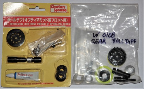

I've been a little vague because I wasn't really sure of what direction I was going with the gear/ball diff decision.
Story is that I got a large grab bag of RC parts and low and behold there were front and rear ball diffs for a TOMSE in the mix, what are the odds of that?
I was not necessarily intending to go ball diff but I guess they are more original/preferred, not that the rest of the car is original. Seems as if I can't leave well enough alone anyways.
I had just gotten the SG25 set up for gear diffs and was headed in that direction. Already had all the new internals for the front and rear gear diffs.
Now I will probably go with the ball diffs because it seems I've got all the pieces.
To try to answer your question.
The rings for the rear diff are appx. .67mm and the spacers for the front ( if they were eliminated) are appx. .2mm.
Though I haven't tried to assemble either diff, it would seem as though adding rings to the presser plates would be too wide. Unless the presser plates were machined for the additional width of the rings.

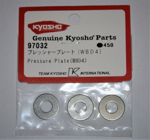

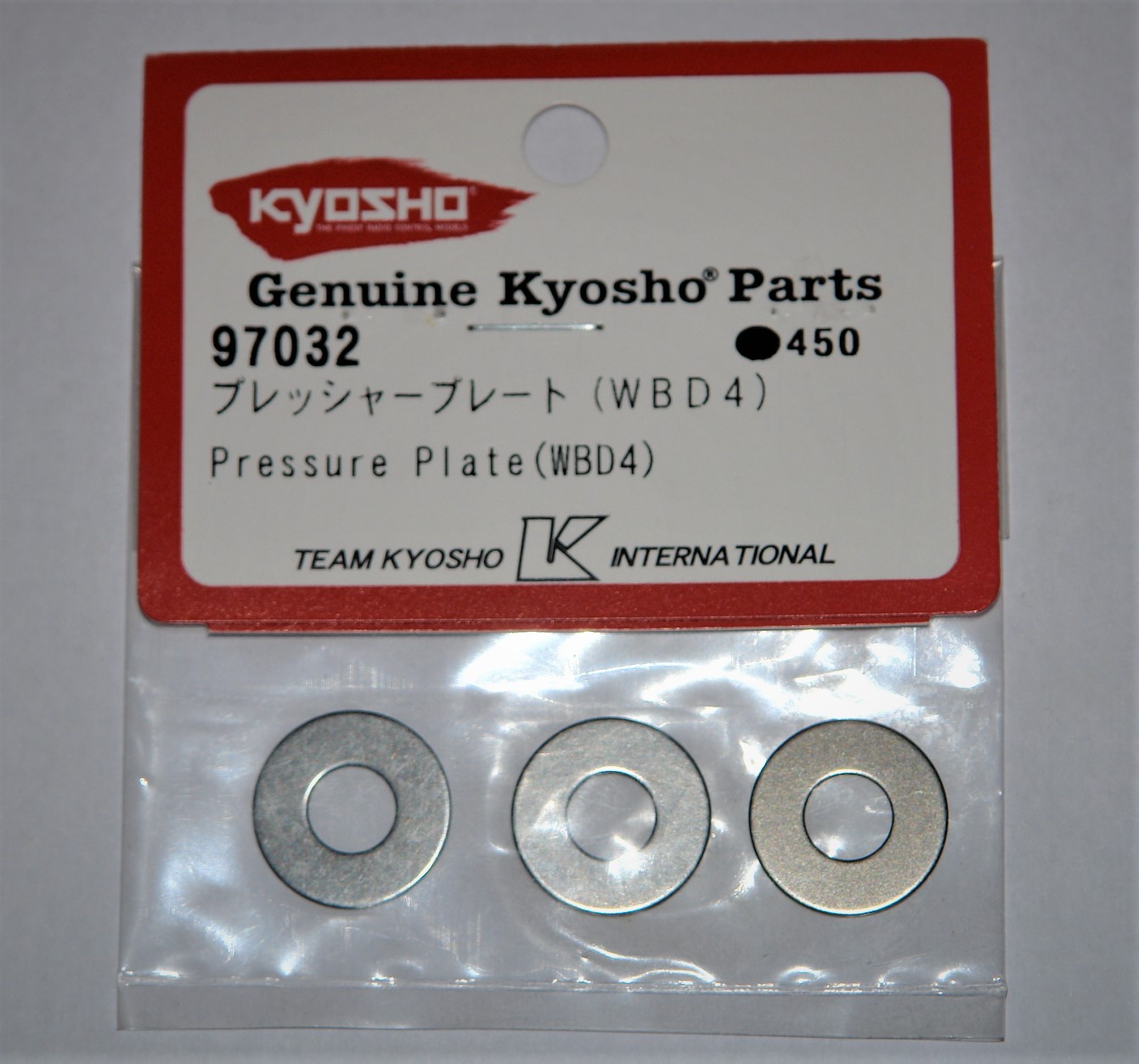

I got the Kyosho WBD4 pressure plate rings in the mail today.
OD matches exactly. Thickness matches exactly. ID is slightly ( .02mm) larger.
I would say that they will work just like the original ball diff rings.
The ring on the right is OEM.

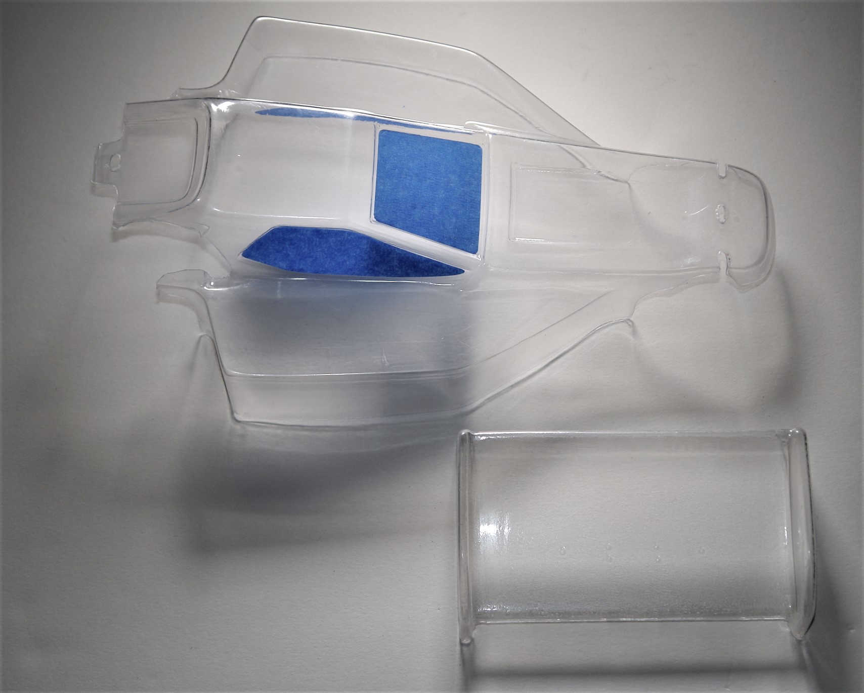

Update...
I trimmed the body and wing finally.

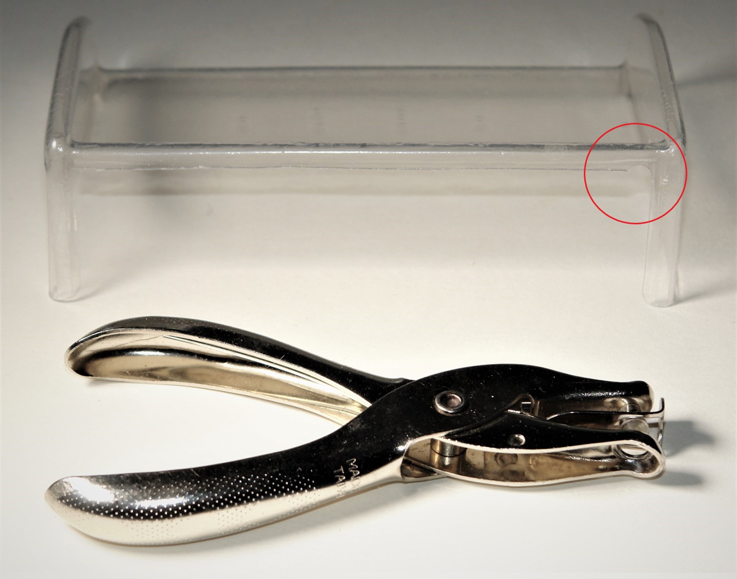

The wing shows a method I have been using to get those pesky corners started without a lot of effort.
Not the final corner but a good start.
The paper punch is also pretty handy for getting a nice round end to the slots cut for shock towers etc.

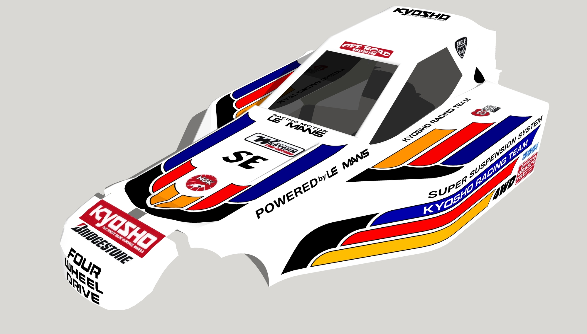

I had also been trying to decide for a color for the body when I remembered something.
In the middle of page 4 of this thread XLR8 posted an amazing rendering of a white TOMSE.
So I stole his image and opened it in MS Paint. Thanks Doug!!
From there I just started flooding the white areas with different colors.
This made it so easy to visualize against the decals, it was like cheating. Thanks again Doug!!!
And I found the color I really liked.
Did I say Thanks Doug???
Chuck

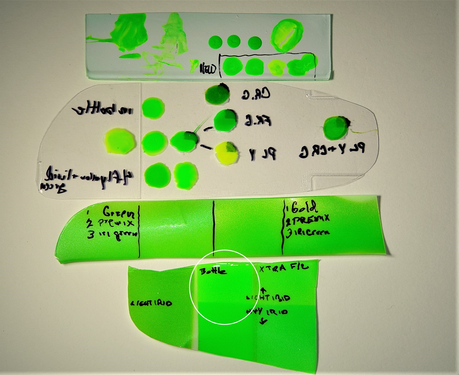

So then on to recreating the color.
Though I have 40 or more colors of paint nothing came close.
So mixing drops then small batches of paint was next. After getting an idea of the correct mix I went on to spray.
Spraying samples on scrap lexan with different thickness of paint and amount of backing paint.
I settled on approximately
1st coat
75% Createx Fluorescent Yellow
10% Createx Flourescent Green
10% Createx Base
5% Parma Fascolor Faschange Green (for a slight pearlescent addition)
Backing coat
90% Createx Iridescent Green
10% Createx Base
2nd Backing coat
100% Createx White

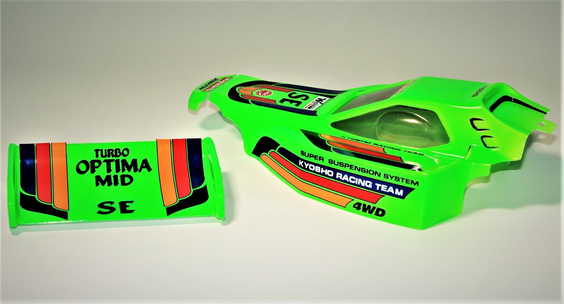

Got some paint and decals on it.
Still needs all the edges sanded and a little more trimming.
