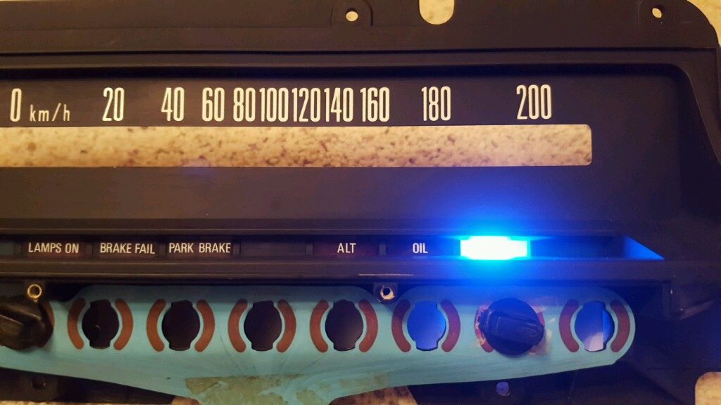

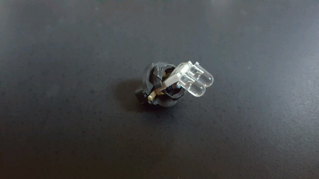

Nothing much has progressed with the rear end due to lack of funds, however, I've finally started on my shift light project. I wasn't happy with most units on the market so I decided to make my own. Being a semi-sleeper I wanted to keep everything as stock looking as I could.
The end goal is an adjustable shift light that you'd never know was there. Luckily there was an empty warning light socket that was taped over from the factory. The incandescent light bulbs were too dim so I expirimented with an LED. I figured out how to fit the LED and resistor into the bulb holder so I could still use the factory circuit board and connector.
I just need to make a yellow lens for the cluster and get either a white or yellow LED to replace the blue one.
I'm not sure how fancy I want to get but most if not all shift lights give you a cap for night. I may try to use a dimable light of some sort and use the headlight signal to dim it at night, or at least while the headlights are on.
This was just a test....

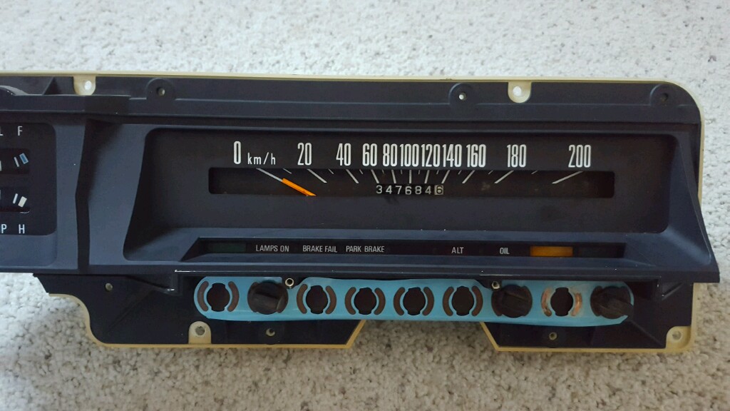

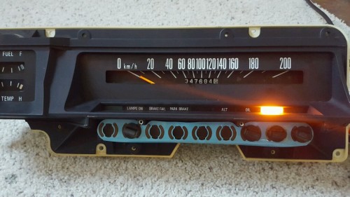

I made my amber lens and after testing an array of LED's found a combination I like. I just wish the lens was a little darker, but it will do.

It's a balancing act between being opaque enough yet bright enough. I must have tried half a dozen LED's to get it where I was happy enough. All the yellow ones 3mm, 5mm and 10mm from their catalog were all too dim and needed to be brighter. The ultra bright whites were good but washed out the color of the amber lens and looked crappy.
I stumbled upon the ultra bright yellow by fluke which gave the best result so far. The next step would have been to try and paint an ultra bright to see if it was effective.
The yellow led that I'm currently using is 23,500mcd and the brightest white in their catalog is 45,000mcd. Fingers crossed smoking the lens doesn’t change it too much.
I think a mirror black type reflector is a good option as when the LED is off the lens will appear dark, when it's on hopefully it will reflect enough to light up almost as good as the white. Making a test filter to slip in behind is easier then making a new lens.
