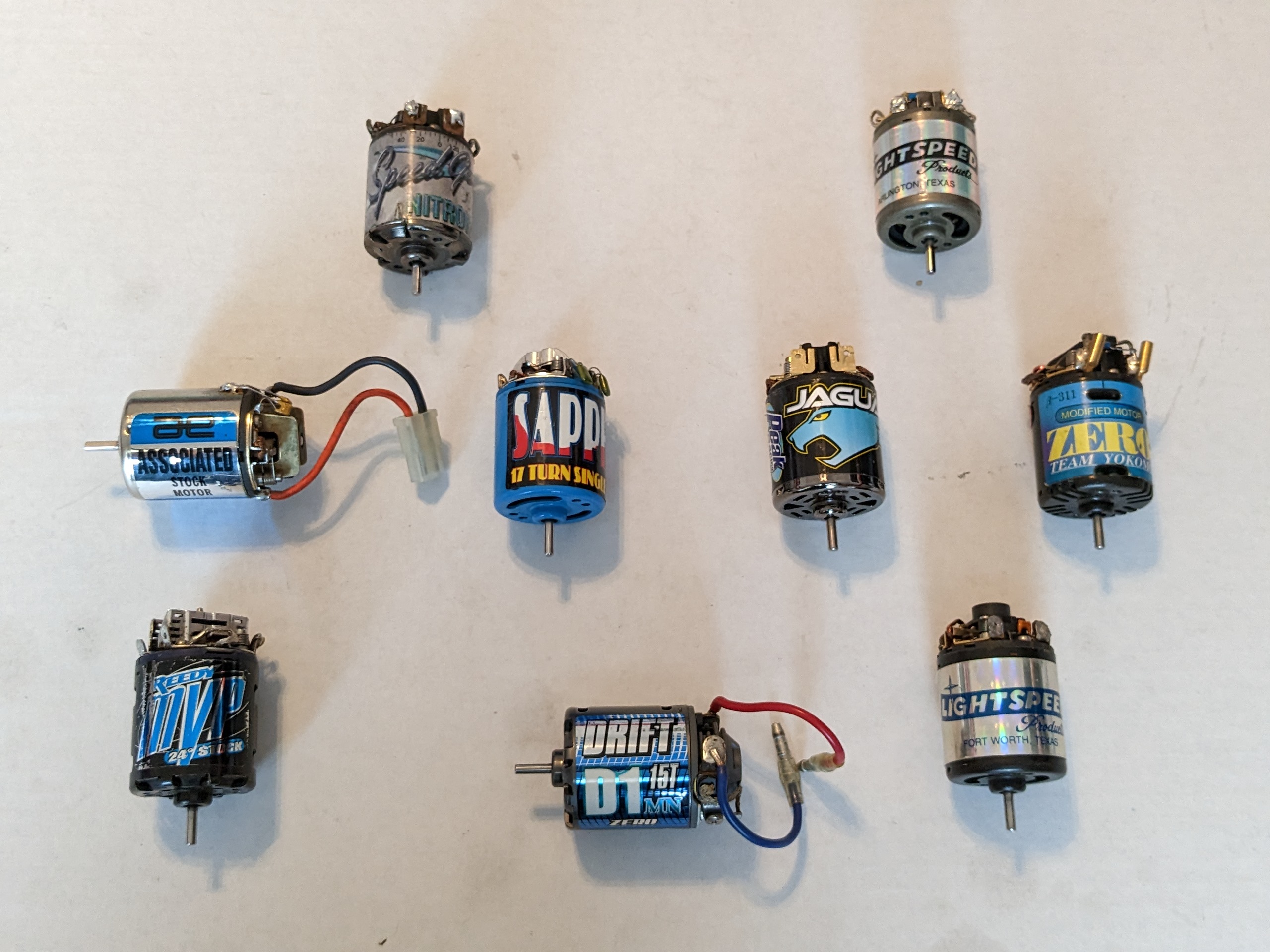

I'm assuming that this car will never be seriously ran, so it wouldn't matter if it was slower. A Tamiya Lightly Tuned motor has a light blue endbell and black can. You could even put a 480S decal on it.radioactivity wrote: ↑Thu Apr 06, 2023 11:36 pm Probably should have bid on the Ebay lot that had the 480s but I got a really nice 240st slated for the motor most probably.
- radioactivity
- Posts: 856
- Has thanked: 384 times
- Been thanked: 618 times
Re: Turbo Optima mid SE
Yeah it won't be a race car.
How bout a nice old stock AE motor, the blue on the decal almost matches the chassis.
Wouldn't that just burn someone's bacon
Chuck
Chuck
- coxbros1
- Posts: 2495
- Location: Energy, Illinois
- Has thanked: 2758 times
- Been thanked: 2407 times
I really think an original 480s is the only option for this car...u can get one and restore it and put a new decal on it...will look awesome in there!

Motors that could be good options...

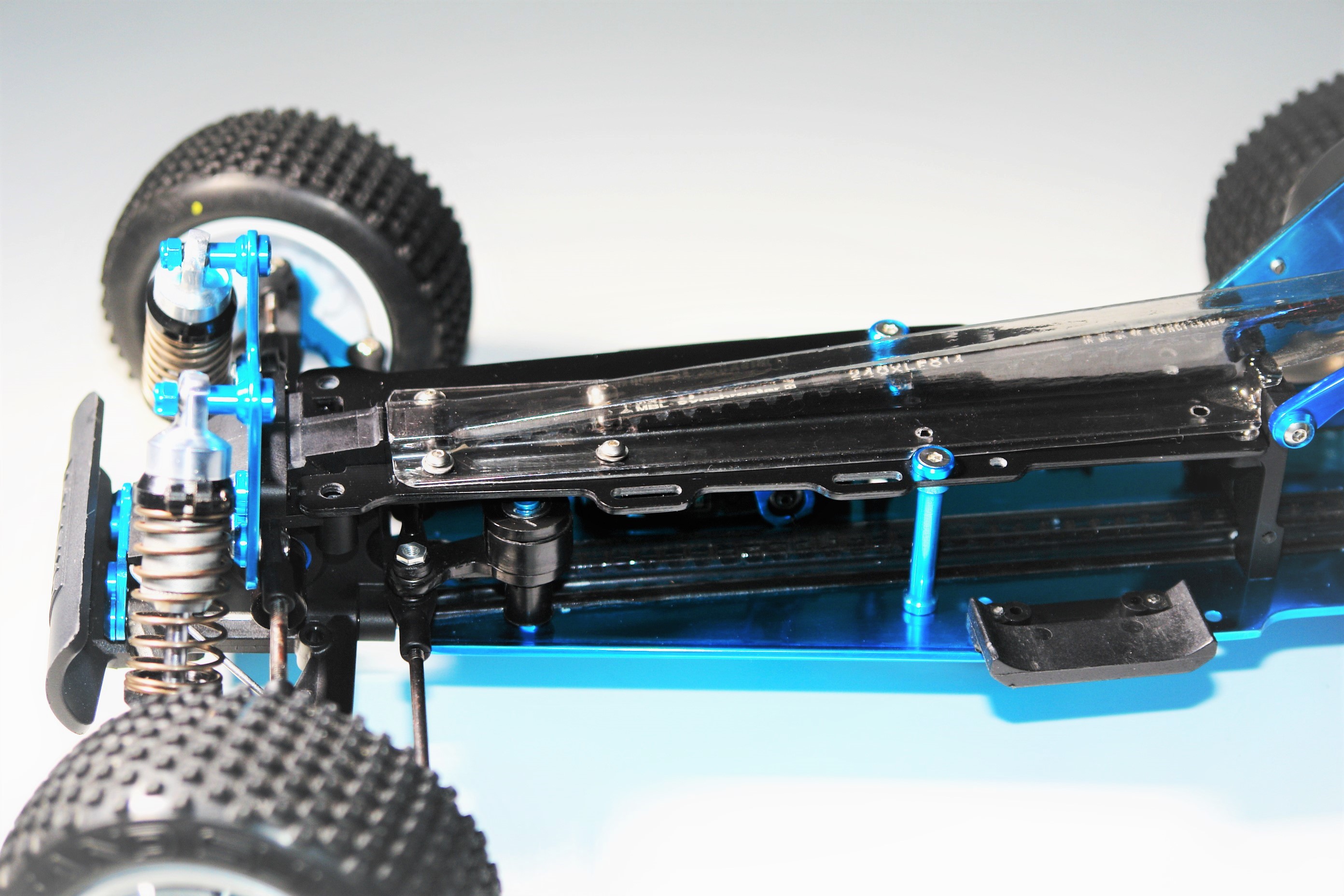

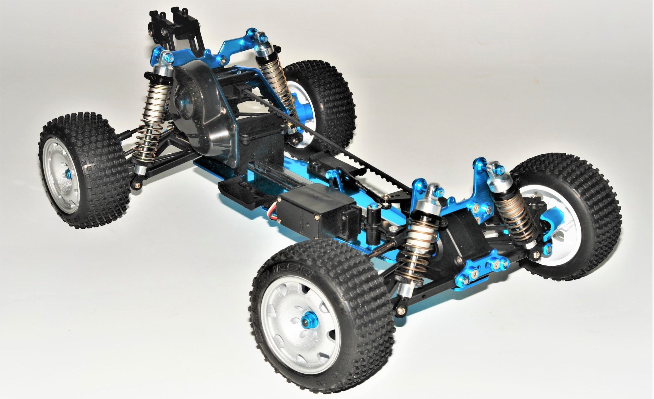

Still raining outside...
So a few more items added to the car.
Suspension and front CVs mostly.
Still need a few small items before thinking about motor, esc, receiver and wiring.
Chuck
Chuck

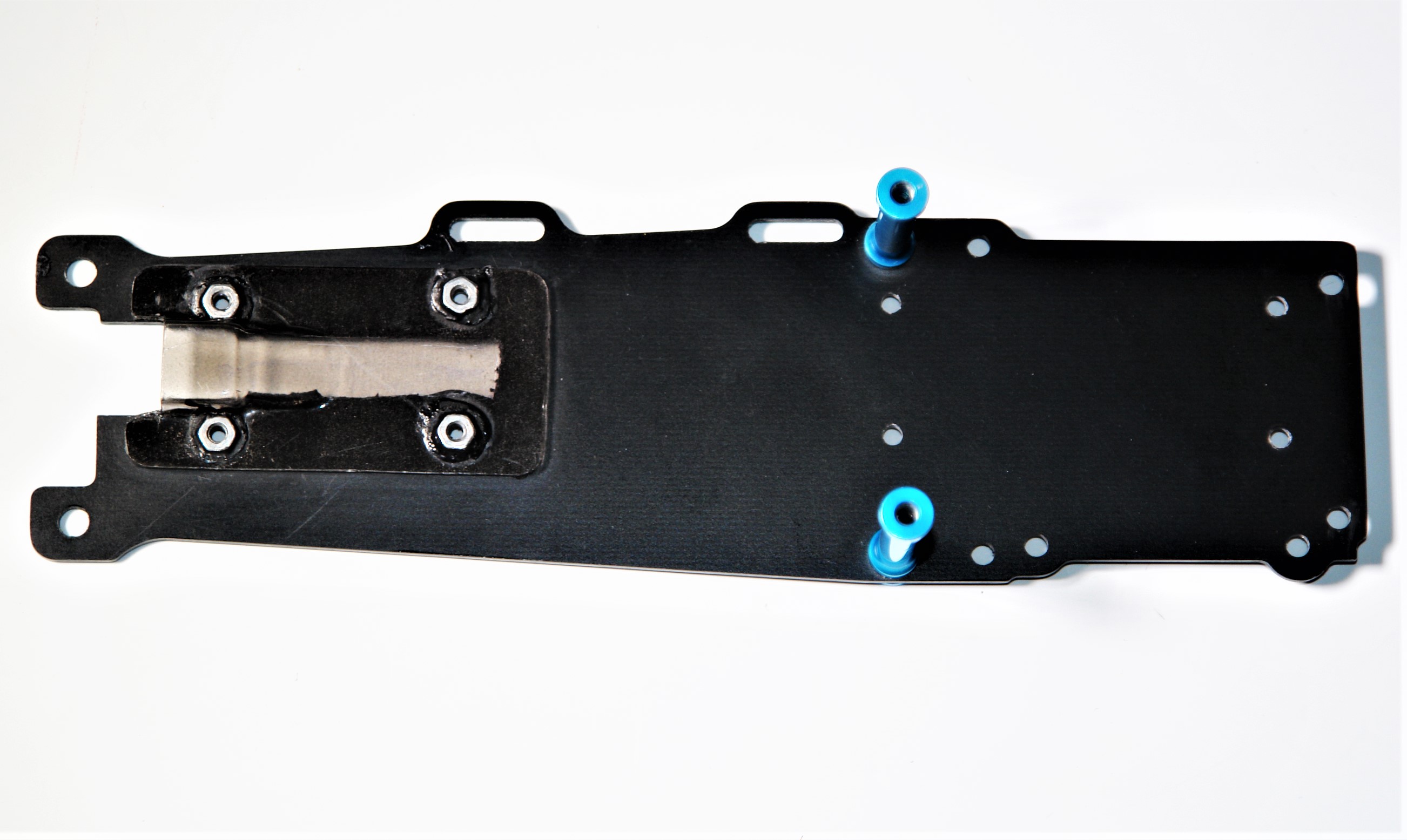

Started to test fit the upper belt covers.
Ran into a difficulty trying to get the nuts on the screws that hold down the front of the top cover.
My fat fingers just can't hold the nuts in place while screwing the screw down, particularly the four front screws.
Probably brought this on myself by using stainless hardware.
While off the car, I installed the small lexan cover that goes on the bottom front of the upper deck with servo tape.
I screwed the four front screws and nuts down snug against the lexan cover and heated the nuts with a solder tip.
This melted the nuts into the lexan leaving a nice hexagonal recess to keep the nuts from spinning while tightening.
A bit of CA glue locks them in place.
Overall it doesn't seem like much but for me it makes installing the cover waaaay easier.
Chuck
Chuck
