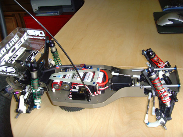

Re: What was old is… still old, but a lot newer (Update 2/20
So i see the original ball studs are smaller than modern ones. What are these translucent white ball cups in photo and do they fit the old or modern ball studs.
also, i have not figured out how to install an original ball stud into the front arms for sway bar (as pictured) because the ball has a socket hex and cant be countersunk. Was going to try new lunsford ball studs but the flange is huge and the ball is too big for the sway bar cups.
- Posts: 16815
- Has thanked: 36 times
- Been thanked: 1318 times
they're stock ae ball cups.
as for the sway bar, just use a ball stud with the hex in the end that is long enough to put a nut on the back side once through the arm.
http://www3.towerhobbies.com/cgi-bin/wti0001p?&I=LXZEM7&P=SM
Thanks scr8p
i bought some old swaybar sets from associated and used the hardware. i had to unbend and then put new bends in the wires. thats not ideal but it will get me started.
are original ball cups available? i have the black ones from the team kit but would like the white.
i never have luck searching for the proper wire. what everyone calls piano wire. google sends me to all the wrong places...
