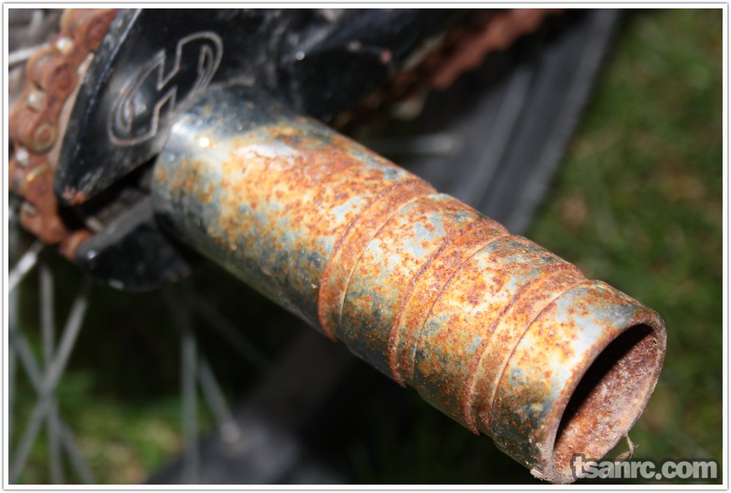

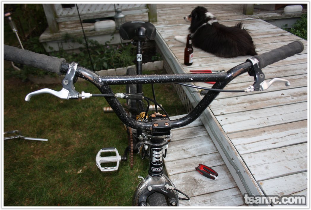

I picked up a couple of BMX's yesterday, but both need some TLC. (Like I need another project) One of them is a Haro Function F2, and the other is a bit more of a mystery. The only tag on it is on the frame under the seat, that says "AMS". It also says something about Vancouver... 'designed in Vancouver' I think.
I'm giving the AMS bike to a buddy at work to fix up, but my plan with the Haro is to make it rideable. However, I would like to one day have it look better than new.

I'm trying to find out a little more info on both, but I'll start with the Haro. From what I've found out so far, it's somewhat of an entry level bike, 'sold only in bike shops'. As for the year it was built, I'm getting conflicting years. Wikipedia says it was released in 2009, but I found a forum post from 2005, with a guy talking about buying an F2. (Maybe there is a difference between an 'F2' and a 'FUNCTION F2'?)

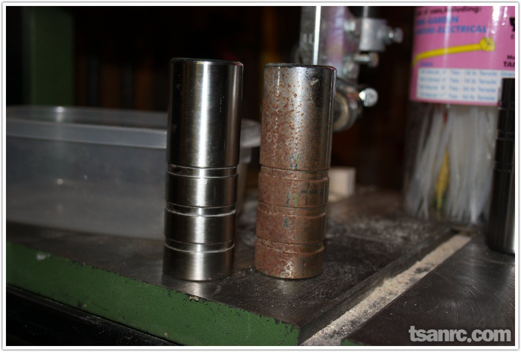

I did some work on it last night. I had to steal the handle bars from the AMS bike, because the Haro's were bent. I took he pegs off, and gave them to my Dad to polish for me. He turned them on a lathe, and using a fine grit sanding pad, managed to get them looking pretty sweet.

I don't know if I'll put them back on the Haro. It's already a fairly heavy bike, I don't know if I want to add a few more pounds to it. Not to mention they'd only be for looks. It's been well over a decade since I busted out any tricks, I don't plan on doing anything like that these days!

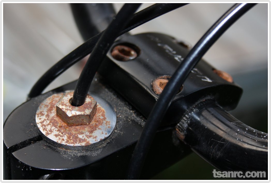

Does anyone have any tips to getting the rust out of things like goose neck hex screws? Maybe polish them with a dremel? Or is there a good cheater method, like soaking them in something?

removing rust you can use either phosphoric acid, or electrolysis....either way will make the finish a dull gray or even darker, then you have to apply whatever coating you want before it rusts right in front of you again....
lots of different stuff around....search 'electrolysis for rust removal' on the 'net, or any of the rust converter/remover chemicals(all basically phosphoric acid) even coke works for the job, believe it or not, but it's slow.
naval jelly, rust-mort, etc etc.
more importantly, come up with a oxidation coating to preserve the finish. polishing will work if you wax, or you can use a black oxide, or just clear coating them.
eastwood makes lots of different coating kits, so you can restore that kind of stuff if you want.

tsan, for rusty stem bolts I usually just hit them with the WD40. Get a Q-tip or a bunched up rag in the hex area. I rub the rust out, wipe the WD40 off and they're fine. They keep their original finish and any patina and don't rust again unless they're getting wet a lot. As for the rest of the bike, you can do a search on bmxmuseum or bmxsociety.com there are plenty of solutions for getting rust off of frames, bars and bigger parts.

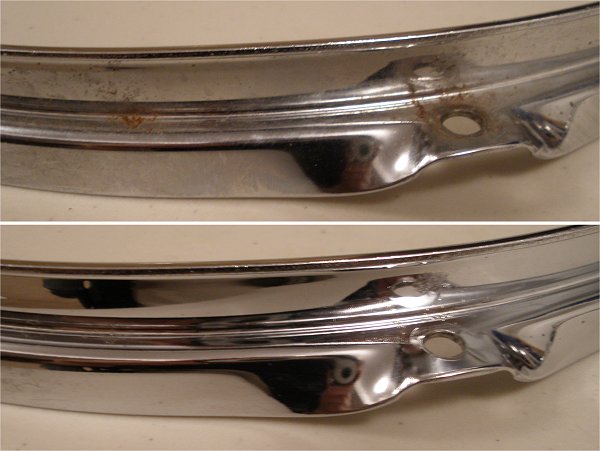

tsan wrote:Does anyone have any tips to getting the rust out of things like goose neck hex screws? Maybe polish them with a dremel? Or is there a good cheater method, like soaking them in something?
I'll share a trick for removing rust from chrome that many won't believe, I didn't myself when I found it while Googling rust removal, ironically I discovered it on a vintage bike restoration forum...don't ask why, just do it. You'll thank me for it's cheapness and effectiveness. It of course won't do anything about pits left behind by rust, but it'll remove any and all surface rust surprisingly quick.
Buy yourself 2 things: a roll of aluminum foil, and a 2-litre bottle of Coke. Roll up wads of foil and dab them in a bowl of Coke, then rub the chrome with it. Trust me, you'll be amazed at how quickly it comes off. I've restored some chrome snare drums from the 80's and you'd be blown away by the before/after pics.
As far as explanation goes, what I can say is that the foil is harder than the rust, but not as hard as the chrome, and there must be some form of galvanic reaction between the acids in the Coke & the rust; therefore it removes the rust quite effectively without scratching the chrome. One warning I can say, do NOT use any kind of steel wool to remove rust from chrome. You'll score and scratch it.
If you want to remove rust from something more difficult and small, soak it in the bowl of Coke for a few hours, then scrub it with foil. 8)
