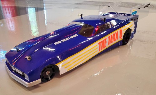

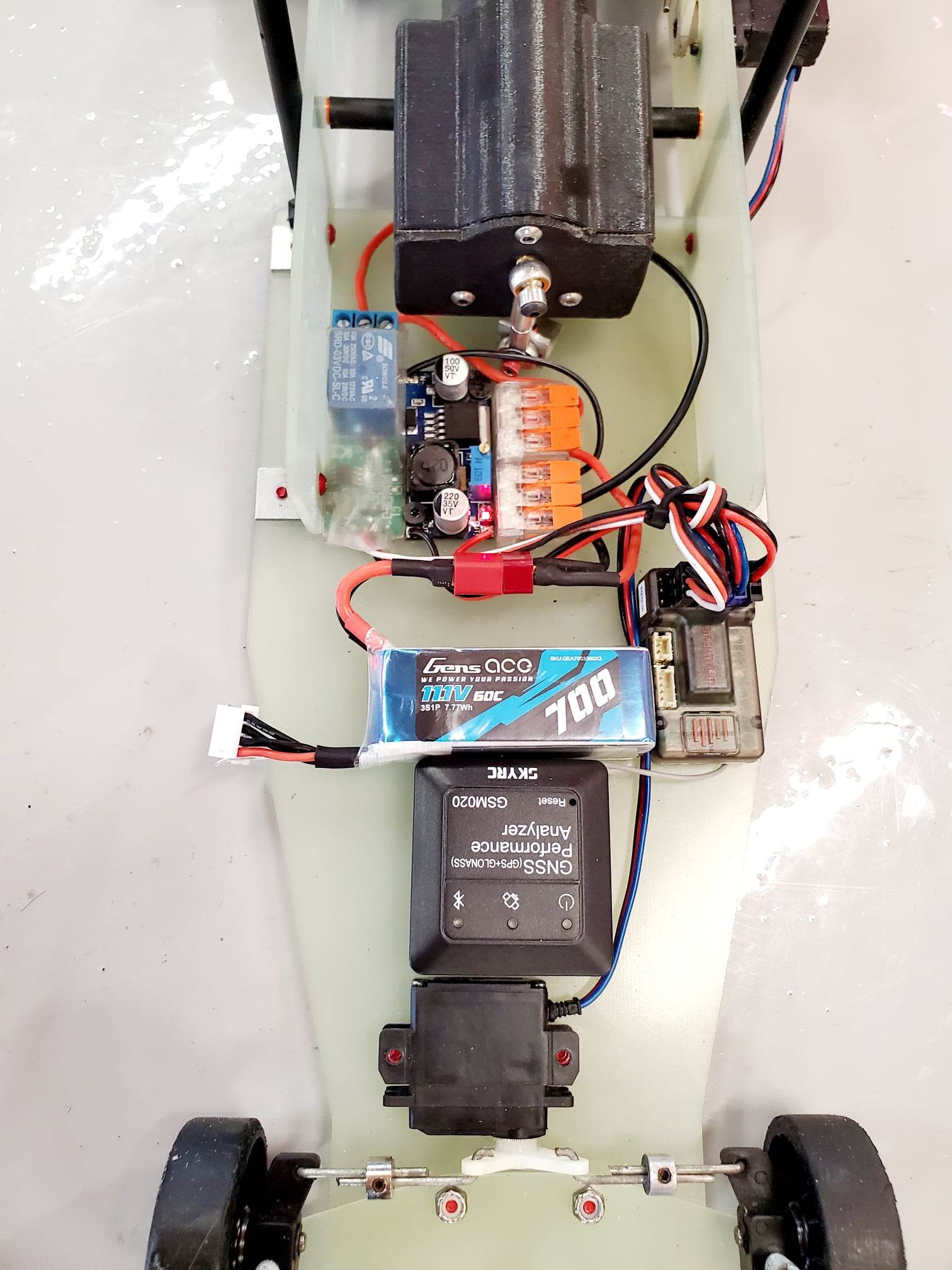

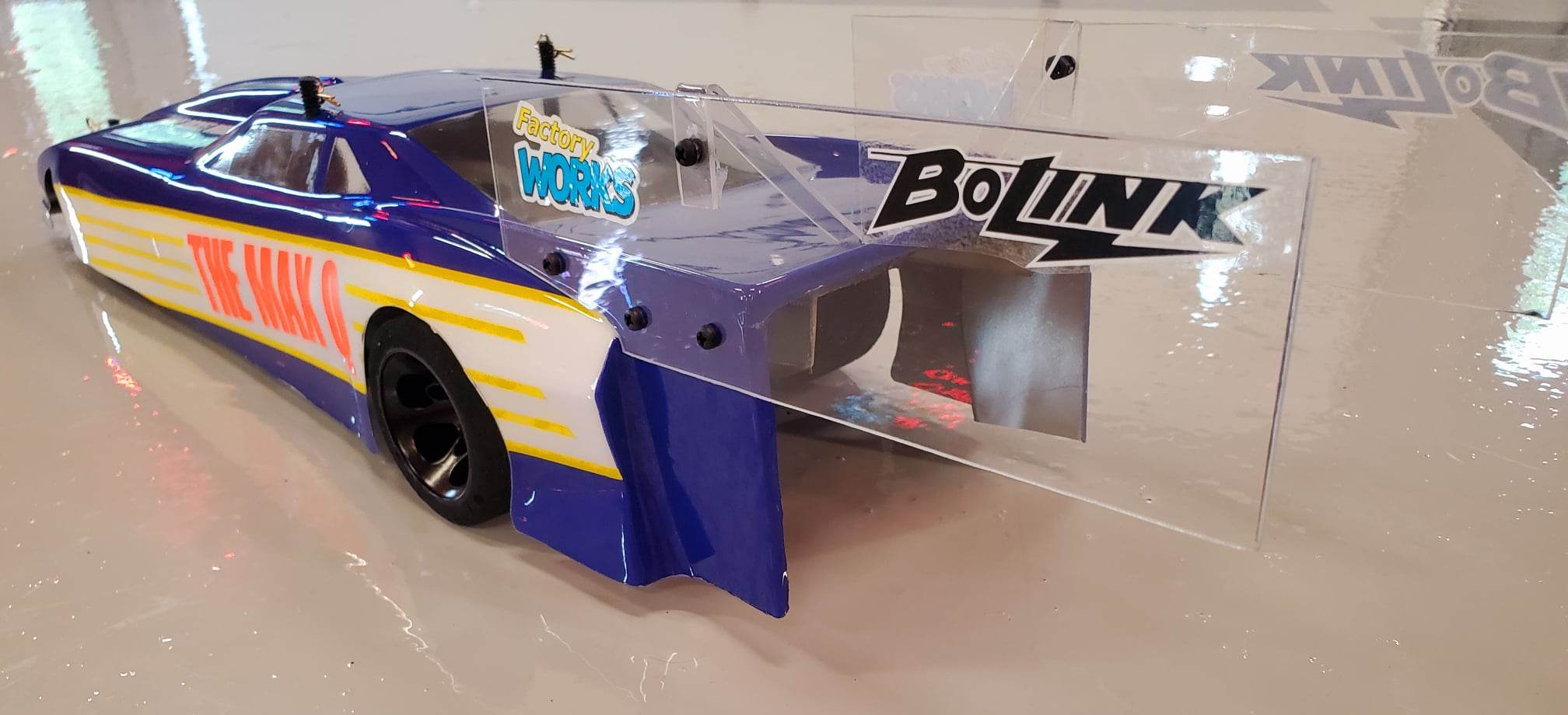

coxbros1 wrote: Thu May 25, 2023 4:53 pm All wired for 12volts, F26 Composite engine installed
Houston....we a have a go for main launch

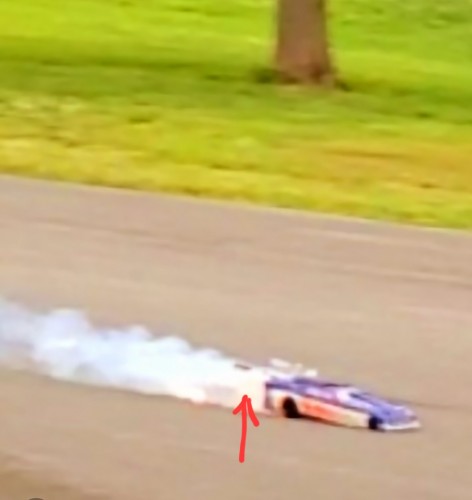

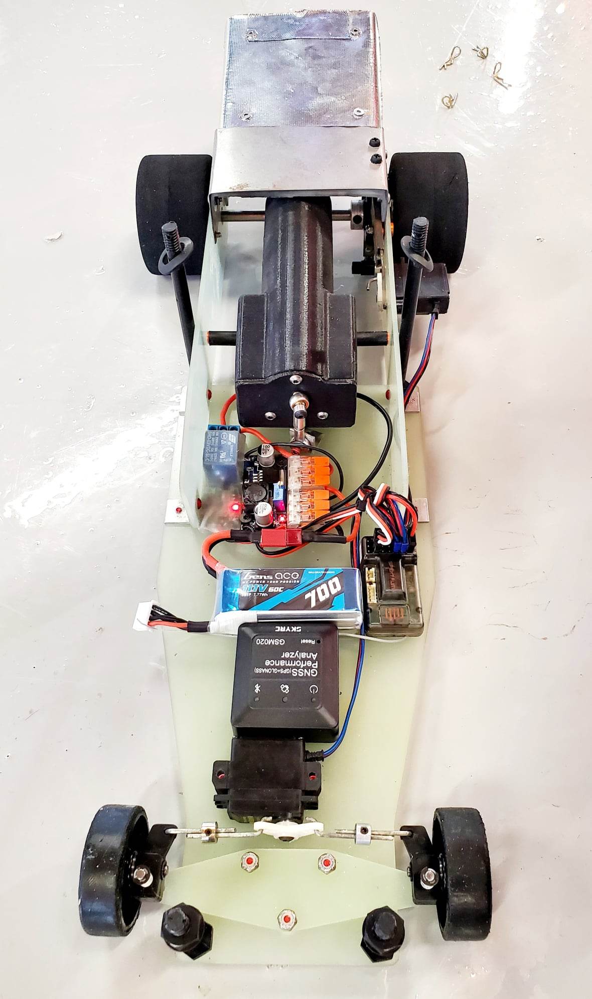

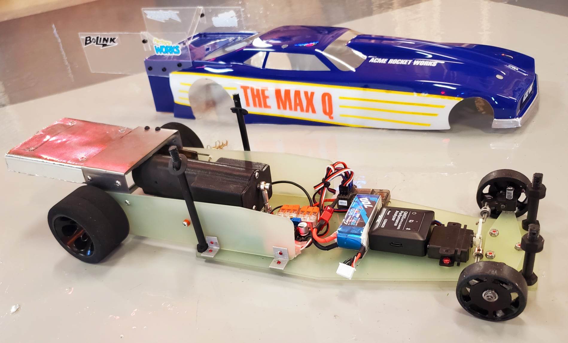

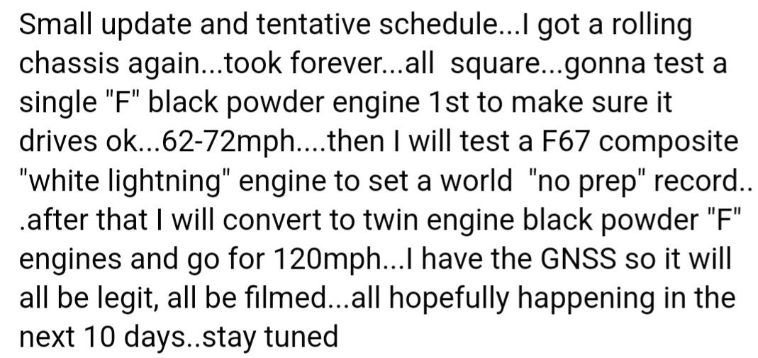

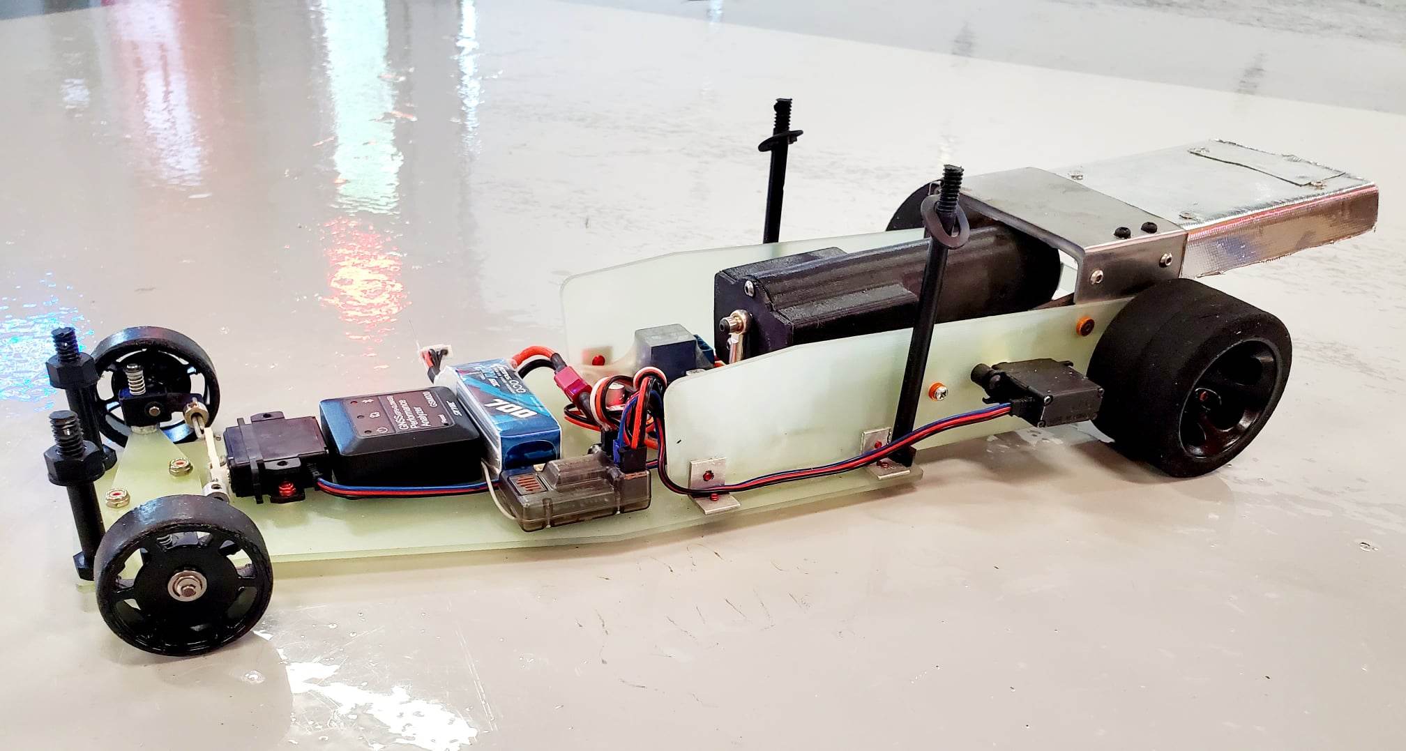

Made a safe test run...had some issues...
GNSS is hard to use, keeps losing Satellite signal...so i don't have those numbers yet...still learning that thing...anyway..
Rocket mount came loose, steering setup was off, hard to drive straight at beginning of run, brakes failed...it did run 62mph as predicted...I fixed all issues except the gnss, that's gonna take some playing around with....next run will be a very powerful Aerotech F67 that only burns for 1 second...need it to cover 132ft in 1.3 seconds or less to get the record

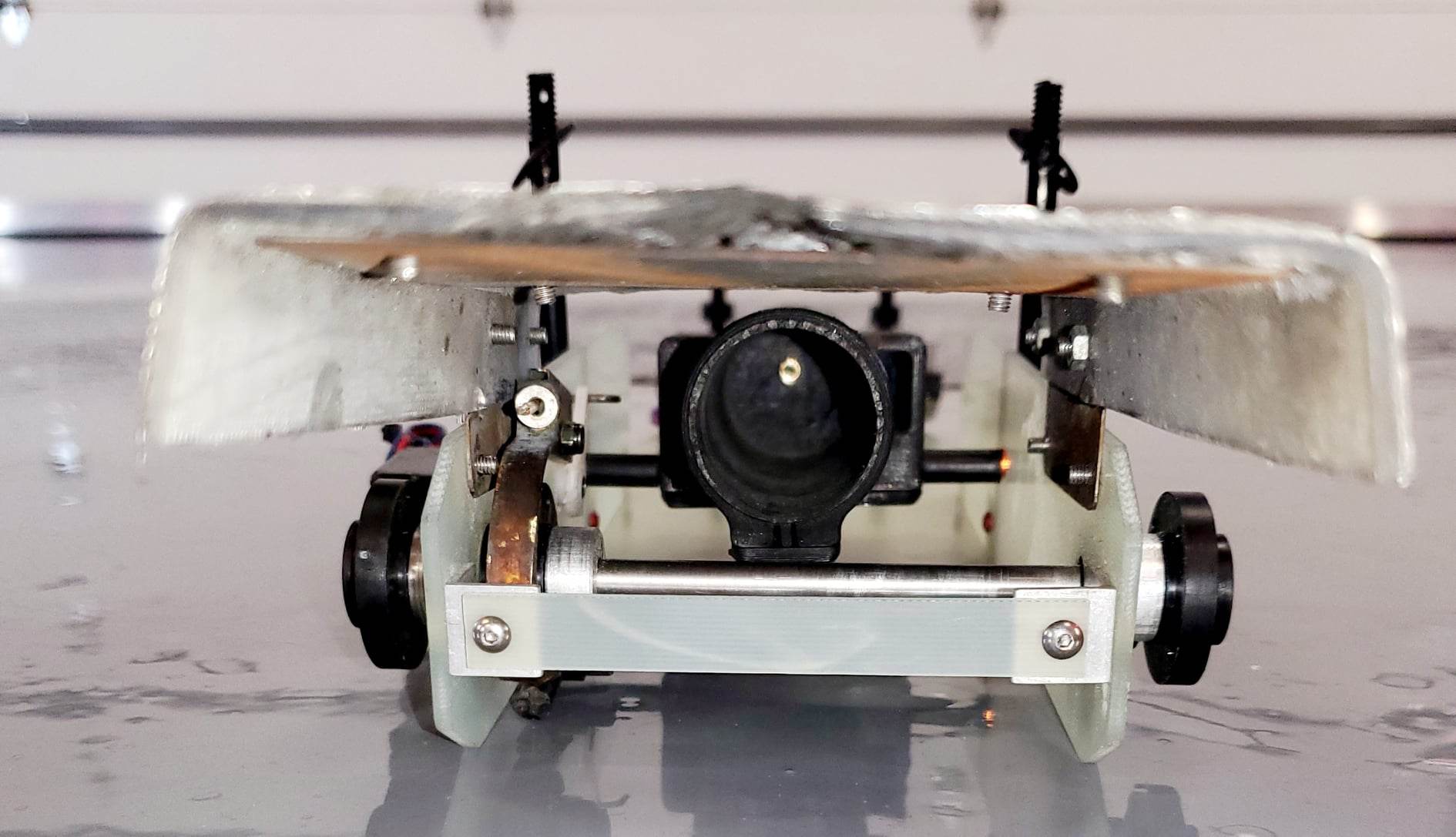

Teaser pic: "at the end of run as it's ejecting the engine"
