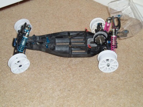

Re: Mid motor car question
pic from oople..........
this is supposed to be an x-6 squared. i guess that's the new one?
as you can clearly see, the motor is installed from the right. being this way, i can fully understand the need for a 4 gear trans. but it wouldn't seem like the rotation of the motor in that configuration would be promoting more rear bite.
i'll understand it eventually...................
alright, i think i got it now. it's supposed work under the...... every action has an opposite reaction.
being as though an armature spins counter-clockwise (looking at it from the pinion side), if you were to hold that, which way would the can spin? clockwise. so, they're using that clockwise force of the can to transfer weight to the rear, because it's bolted down (unlike the armature), that force is transfered into the chassis.
i think that's it anyway...........................

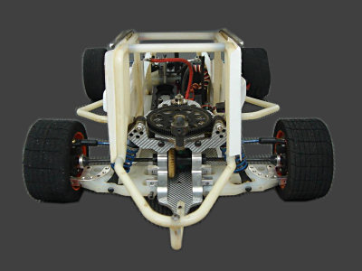

Have you ever seen the Dynotech delta sprint car where they stood the motor up to help utilize the rotation of the motor to rotate the car in the turns?

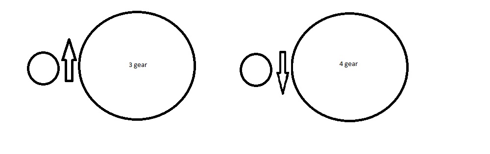

Maybe this will help some....with a 3 gear trans, your spur rotates opposite as the rear tires, 4 gear it rotates the same. Your motor rotates "up" with a 3 gear, "down" with a 4 gear. Something like that...maybe I have it backwards, but I know the 4 gears helps push the rear end down during acceleration.
But lets see if my little graphic helps...

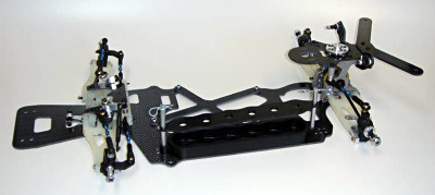

I always wondered why they stood the motor up on the Dynotech's, makes since now. Definately a different design and way of thinkingSoloGraphix wrote: Have you ever seen the Dynotech delta sprint car where they stood the motor up to help utilize the rotation of the motor to rotate the car in the turns?

Having race B4 and X6,im thinking that the dynotech car would be realy touchy to throtlle input.im not convinced of the design.
they do make super a-arm for rc10 thought...
