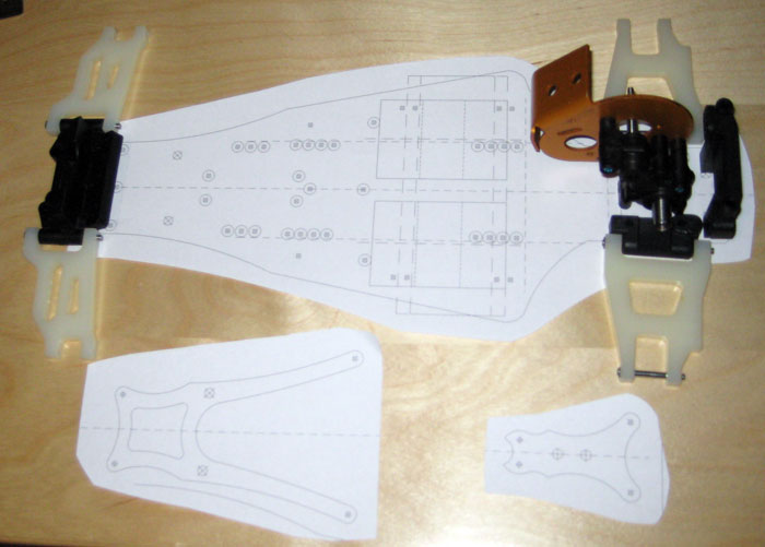

Good stuff guys, how about the wheelbase on mid motor cars. How does this affect the handling? Should this car be a bit longer or narrower than regular?
I started working on it this week and will probable have something to show in the next 2 weeks or so. It is going to be more of an old school design (no comp for the modern ones like the S2 and X-6) but it might be able to keep up. I might be close to an Tekin conversion but nicer, IMO.
This is a pic of the design process. I am planning to use some hobby shelf part so I can repeat the car and I am making some custom parts like chassis and towers.
Posts: 9284
Has thanked: 357 times
Been thanked: 470 times
Re: Mid motor car question
you might have thought about this already, but try to mount the servo similar to a B4 to keep the
weight centered--Very cool project!
