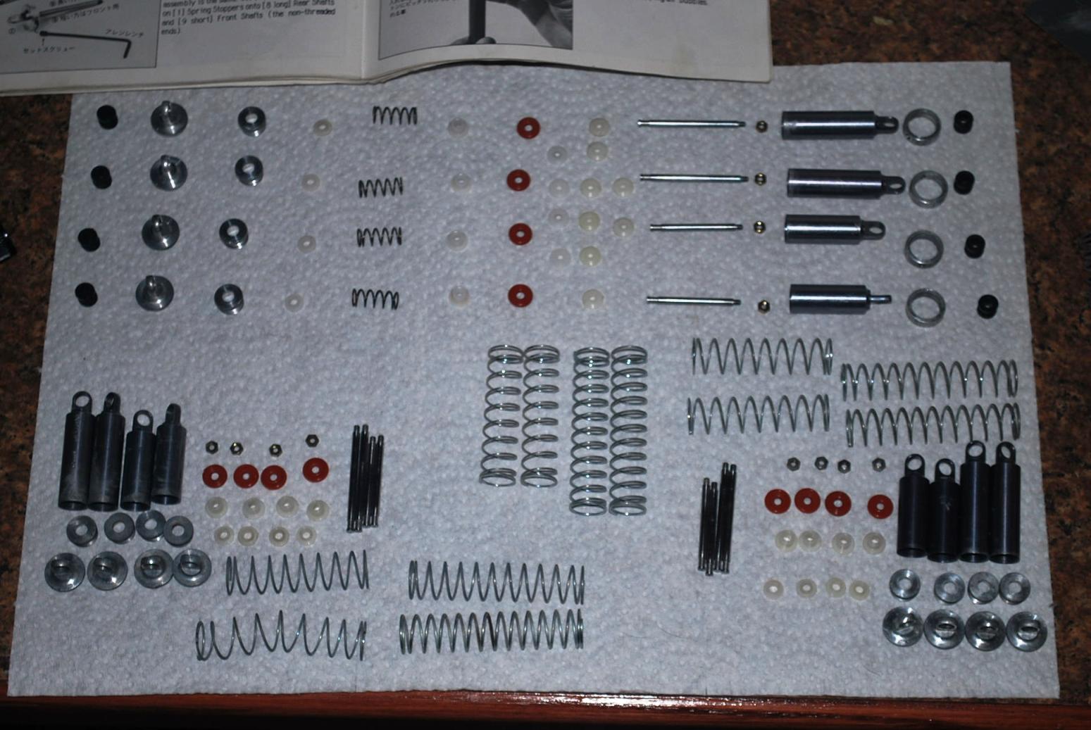

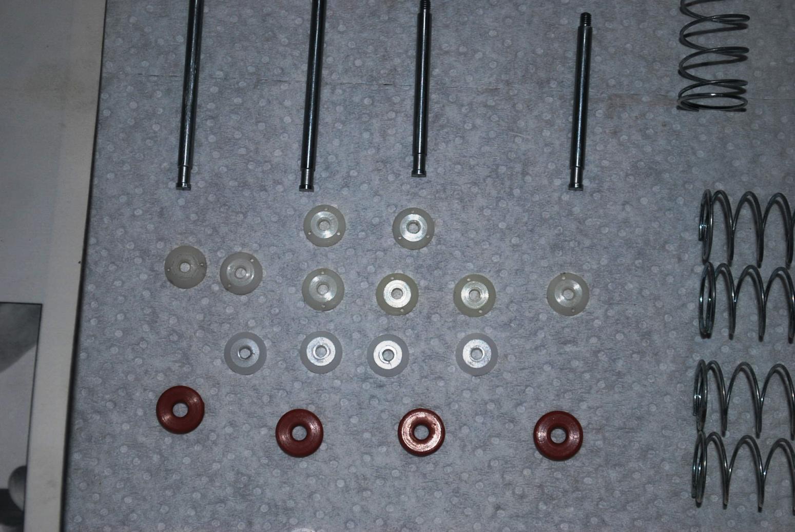

I got to work on the shocks tonight
I laid out of all the clean parts with one group showing how the manual shows how they go together. Amongst the parts I found 3 different pistons, no holed piston, 2 holed and 3 holed. I tried using the no holed piston and it didn't move very easy or at all inside the shock body, but the 2 holed piston worked nicely. I heard that these shocks were hard to bring back to life after over 10yrs of abuse, but I didn't seem to have any issues with the right piston. Maybe I'm doing something wrong with the non holed piston
I would use a stiffer spring than the stock one though.
If it wasn't for the lack of inner springs, we would have shocks for three 870Cs, but as of right now, we just have one set.

Im not sure if you are aware but the 870c and YZ10 had slightly different shocks. The 870c version confuses the hell out of me with those internal coils....what tha?
The YZ10 version were more inline with todays type shocks when it comes to the internals.
