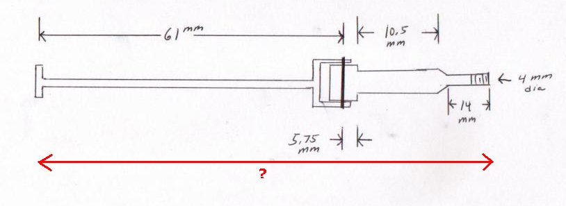

Here are the dimensions of the ever elusive W5062. Dont mock my 5 minute sketch! I did not include the length of the tapered part of the axle.

Awesome, thank you for that. I'd still like to know the total length--from the left side of your diagram (the cross-pin) to the end of the 4mm axle. That's probably the most important spec.

I'll measure tomorrow for sure but I would guess the taper is 4mm in length, so ~95.25mm

How about that for a educated guess. The actual measurement is 94.5mm from the end of the threads to the center of the pin. Now give me measurements of the W5061 and the CRD style.
