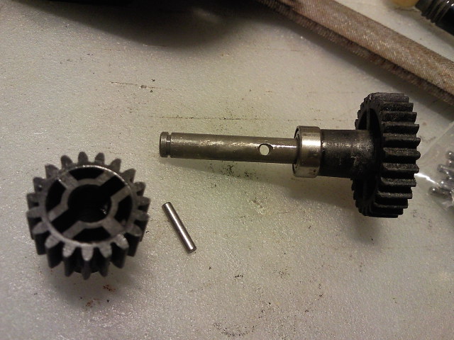

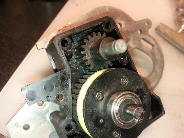

yup i guess they are hard anodized, it should last longer than the standard one i guess, another cheaper alternative is to use the ultima's plastic one :mrgreen:

kaz_z wrote:yup i guess they are hard anodized, it should last longer than the standard one i guess, another cheaper alternative is to use the ultima's plastic one :mrgreen:
It might not necessarily be cheaper because you'll need a different shaft drilled for a cross-pin as well as the plastic gear. :)
The hard-anodized final pinion should last a long time for you.

i know , i have those shaft , so i might just try that route

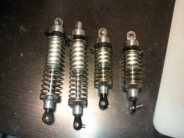

Post by kaz_z »

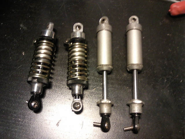

platinum shocks rebuild, front shocks polished, rear still need rebuild and polishing
kaz_z
Posts: 80
Joined: Wed Mar 23, 2011 8:50 am
Re: My Optima series collection
Post by kaz_z »
done,my fingers are sore :wink:

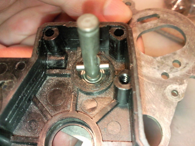

Post by kaz_z »

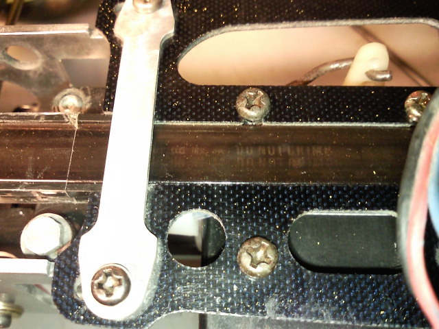

in the process of doing up my belt optima for bashing at the track, I decided to try ultima's plastic final pinion. here's some pics of it, it works and will need an E clip to secure the shaft. the metal plates are very used n somewhat rusty, but I think I'll just leave it as it is since it's gonna be bashed at the track and i'm lazy to polish them :oops:

Post by Coelacanth »
I've heard about that mod but never seen it done. I wonder how it holds up to wear 'n' tear?

Post by kaz_z »
I'll update on the durability of this mod after some track time, I hope to finish it soon and hit the track. The belt does need some silicon oil to soften it a little.
The strange thing is that one would expect hardened steel--or even the aluminum gear--to be more durable than plastic, but plastic-on-plastic theoretically suggests less wear than plastic-on-aluminum. Looking forward to your results.

Post by kaz_z »

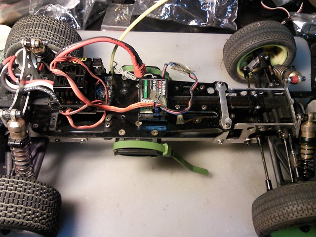

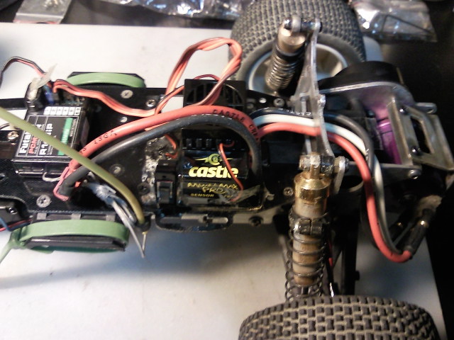

ok decided to give it a quick sand down to give it a little shine, then took this belt optima out for a test run to check for fault,using lehner 4200 motor on 15t pinion, it still wheelie under hard acceleration. it's now ready for the track :) will report back on gear durability in another week or 2 once I have the chance to hit the track.

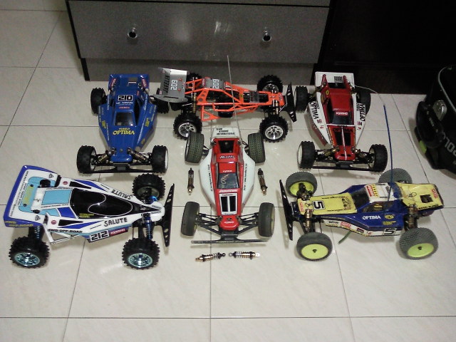

kaz_z
Posts: 80
Post by kaz_z »
Finally 6 complete optimas :) with one sporting a used turbo ultima shell which I obtained from one of the transaction. Some of u might recognise the blue turbo optima :D

kaz_z wrote:Finally 6 complete optimas :) with one sporting a used turbo ultima shell which I obtained from one of the transaction. Some of u might recognise the blue turbo optima :D
I have seen that blue one before lol :mrgreen:

Coelacanth
Posts: 7421
Location: Alberta, Canada
That's a very nice collection, kaz_z. My own collection will be limited to 3 Optimas, but all very different and none even close to box-art. That Salute looks great!
