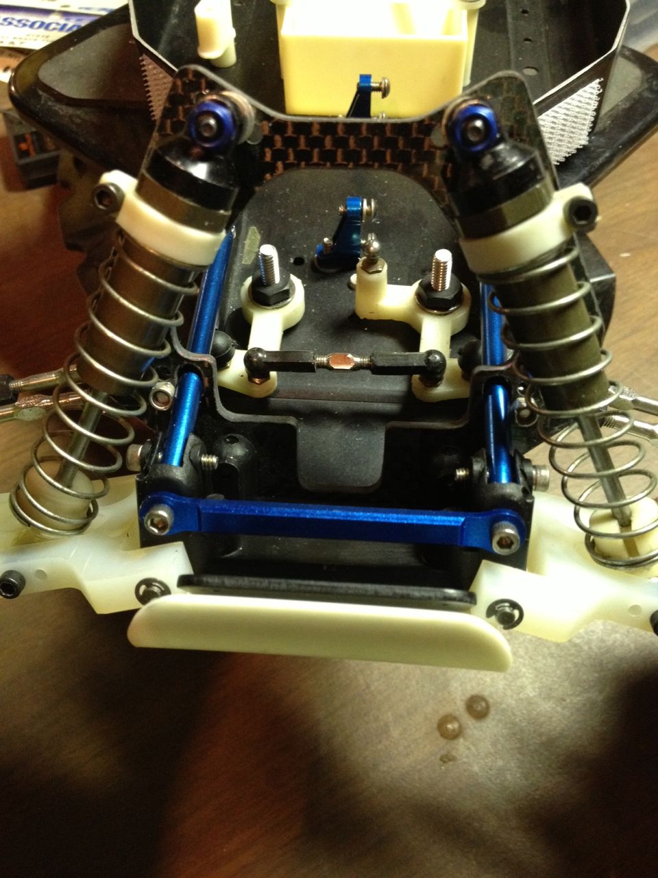

I made a little more progress on my RC10 this evening. I focused on the front end and installing the GT bulkhead and nose tubes. I thought that it turned out quite well.
The next thing to tackle is the steering servo arm and attach it to the steering mechanism. I might have to run to the hobby store tomorrow and look for a small turnbuckle as that is what it seems to need.
More to come.

mdutcher wrote:I made a little more progress on my RC10 this evening. I focused on the front end and installing the GT bulkhead and nose tubes. I thought that it turned out quite well.
More to come.
This might be a mock up thing on your front end, but you have 0 or 5 degree caster blocks in there right now- you'll want to switch those out to a 25 or 30
Posts: 16748
Has thanked: 33 times
Been thanked: 1216 times
Re: My RC10 Worlds Project Runner
you also need to slide the nose plate back to shorten the wheel base and fix what will most likely be steering geometry issues. either that, or keep the long wheelbase and move the steering bellcrank forward to the front set of holes.
Oh, I did not notice that and thank you for letting me know. I think that currently the caster blocks are 5 degree based on the number that is written underneath them. What is the difference between a 25 or 30 degree? I will need to shop around for those... any suggestions on where I might be able to look for them that will work with my current A-arm set up?

scr8p wrote:you also need to slide the nose plate back to shorten the wheel base and fix what will most likely be steering geometry issues. either that, or keep the long wheelbase and move the steering bellcrank forward to the front set of holes.
I noticed that I have that flexibility to move the front end around as you have noted. However, if I were to slide the nose in, then what would have to take place for the longer nose tubes? Would those have to be cut down to size?? If I chose to not do that, than I would have to move the steering bell crank forward to the other set of holes.
When you say steering geometry issues with my initial setup, what would you anticipate to occur? With the correction as you have indicated, what will be the anticipated steering output?

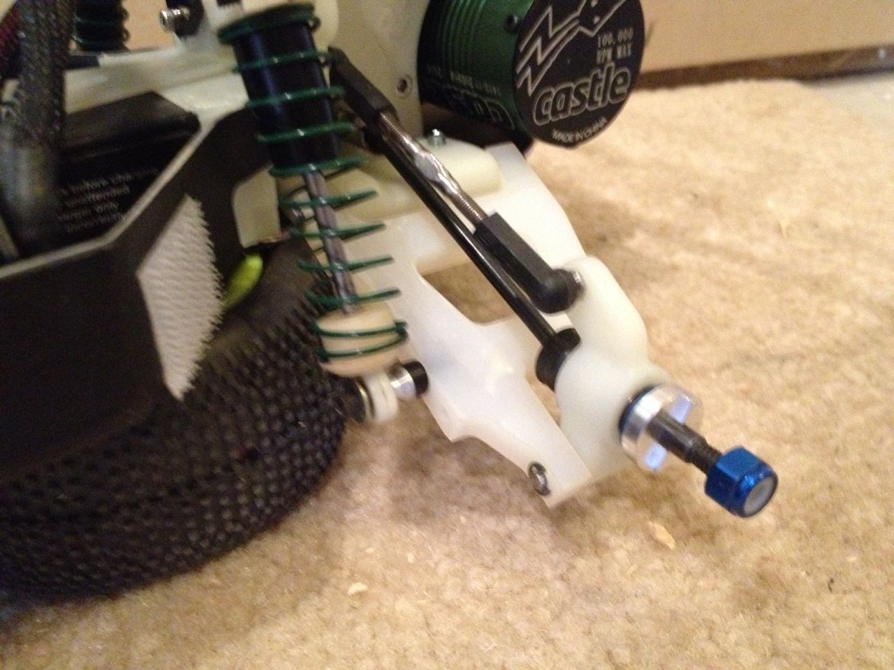

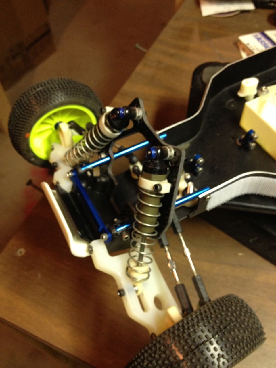

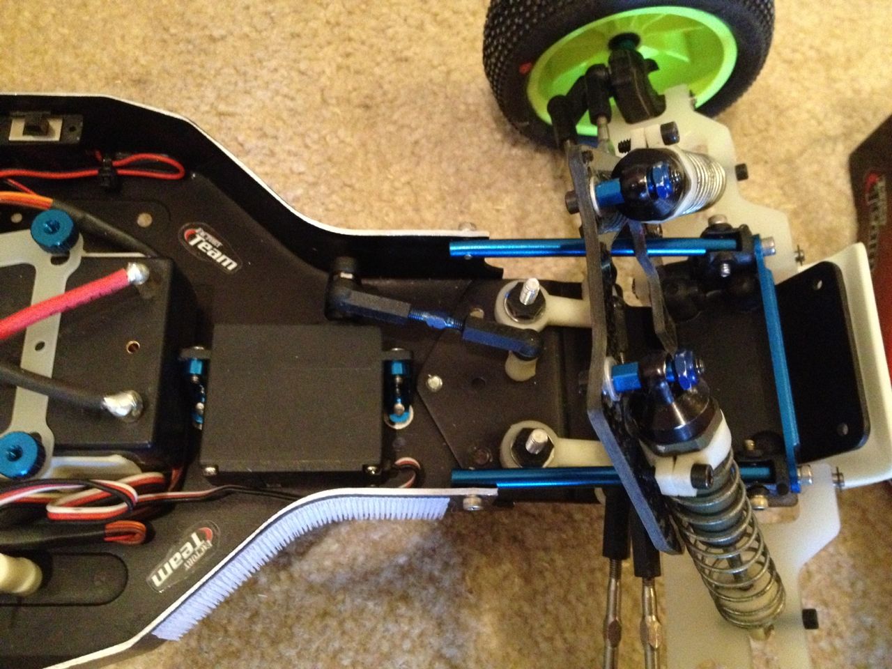

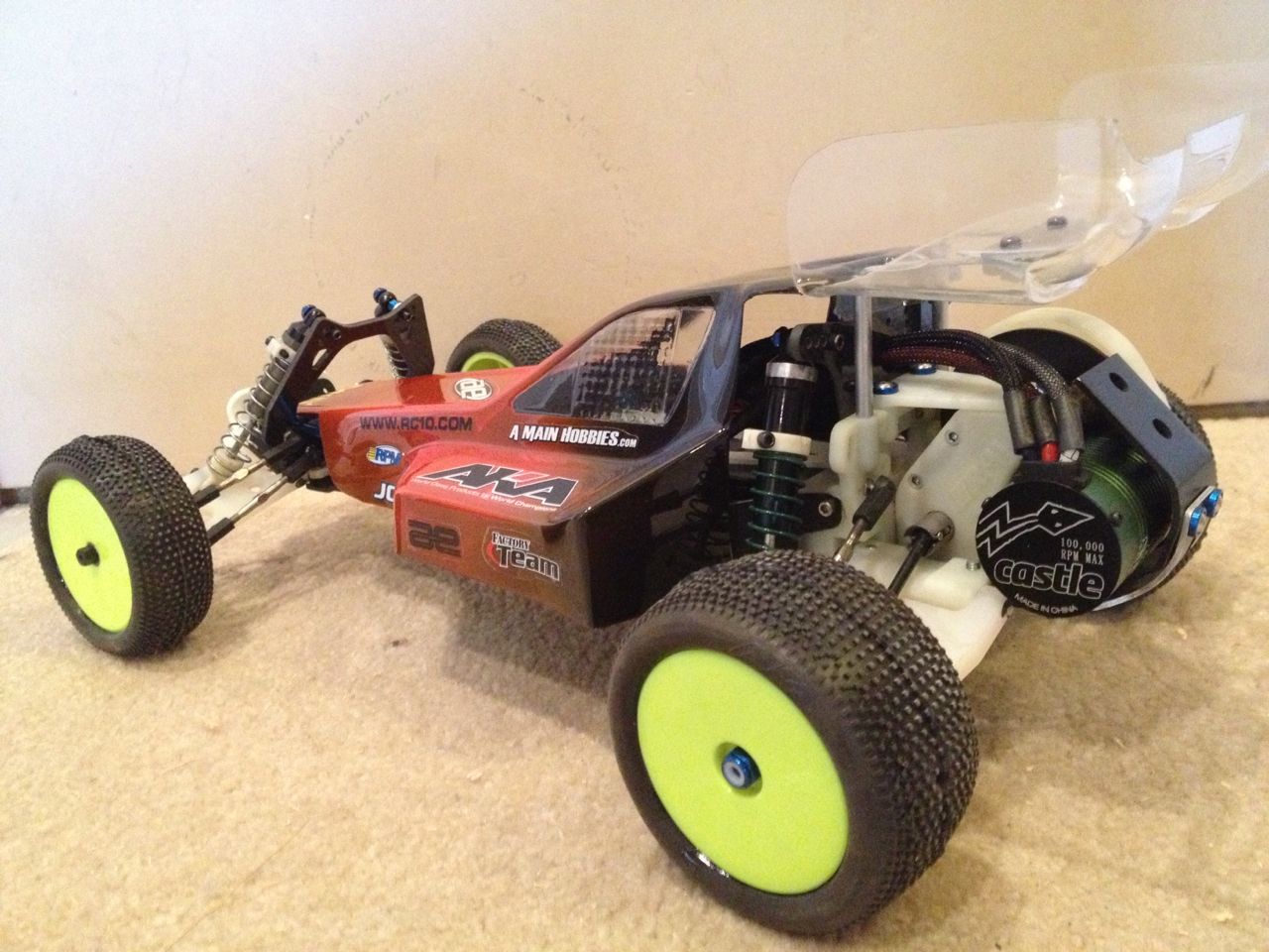

So, here is my latest update. I will let the pictures do the talking first.
I think that it is coming along just fine. What I have done at this time were:
RC Carbon Works Rear Shock Tower
B4 spacer and additional spacer on rear axle
Front GT Bulkhead
Front GT Nose Tubes
Front Caster block 30 deg
Moved steering assembly to forward holes
Added electronics (servo is just temporary)
Still to come: B4 Threaded shocks
Enjoy!
