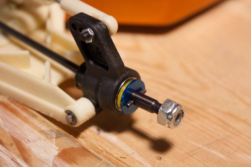

So, no real updates on the build... although I did go to home depot and purchased some washers. $0.22 later and my steering is sitting at a better angle where the ball ends don't rub on the nose. *insert balls rubbing on nose jokes here*

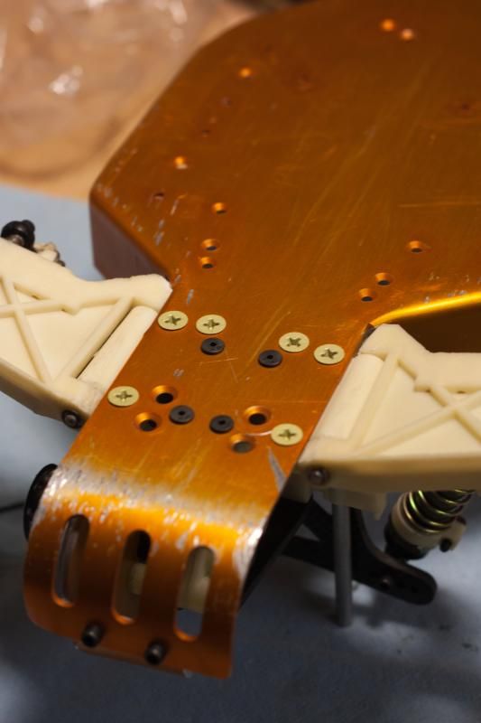

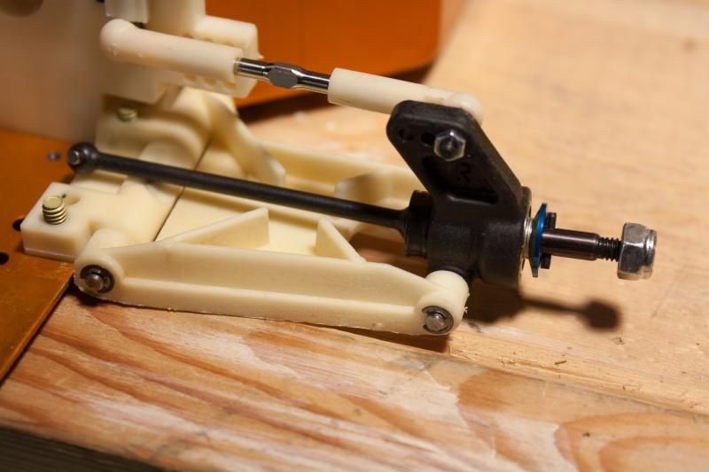

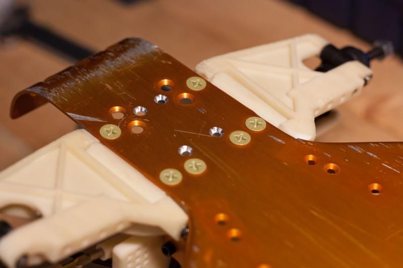

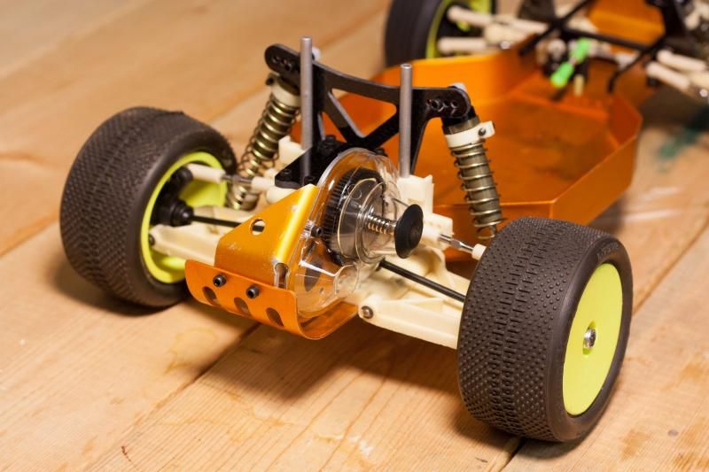

I got my bearing and diff ball order from Avid... I've had a few free moments to work on this project since the move so I assembled the rear hubs with the bearings and installed the CVDs. I've also removed the stealth transmission in order to countersink the holes (purchased an 82 degree one from Fastenal). But my drill seems to not want to hold a charge... not sure I want to countersink these holes with a hand drill. Has anyone tried it?

When I tried that setup the bones bound up inside the outdrives when the suspension was collapsed. Maybe I did something wrong? :?

Orange wrote:When I tried that setup the bones bound up inside the outdrives when the suspension was collapsed. Maybe I did something wrong? :?
Hmmm... interesting. I tried spinning the wheels through the full range of motion and it seemed to spin freely. Was it under load when it did that?
Posts: 16810
Re: RC10 gold pan OIN build
just looking at your pic, going by your ball stud placement, it doesn't look like you would gain and negative camber during compression. that could be one reason you don't experience any issues.
just speculating of course.....

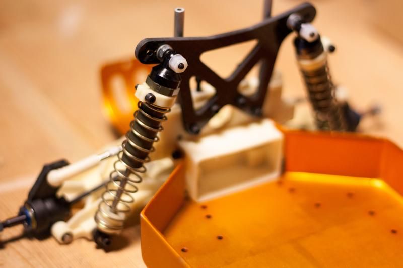

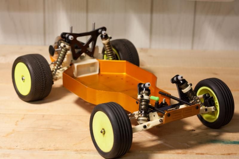

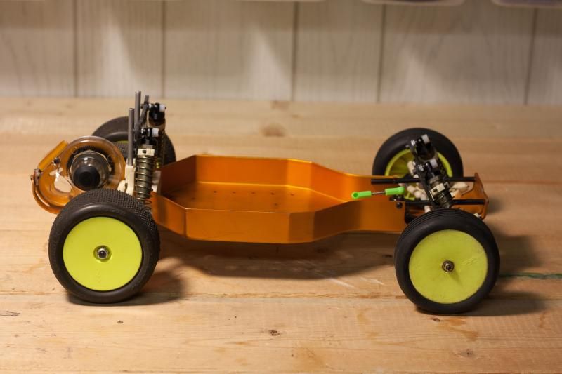

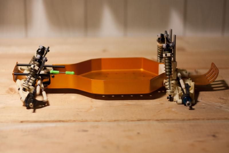

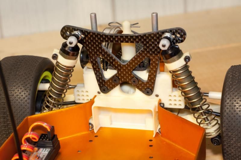

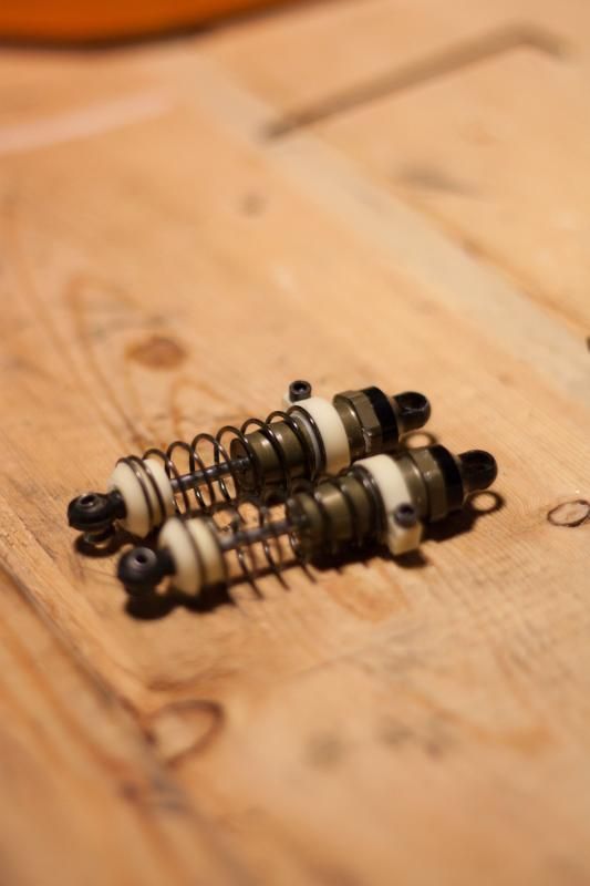

Got a few updates... this week was a rebuildathon!

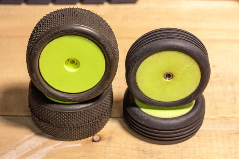

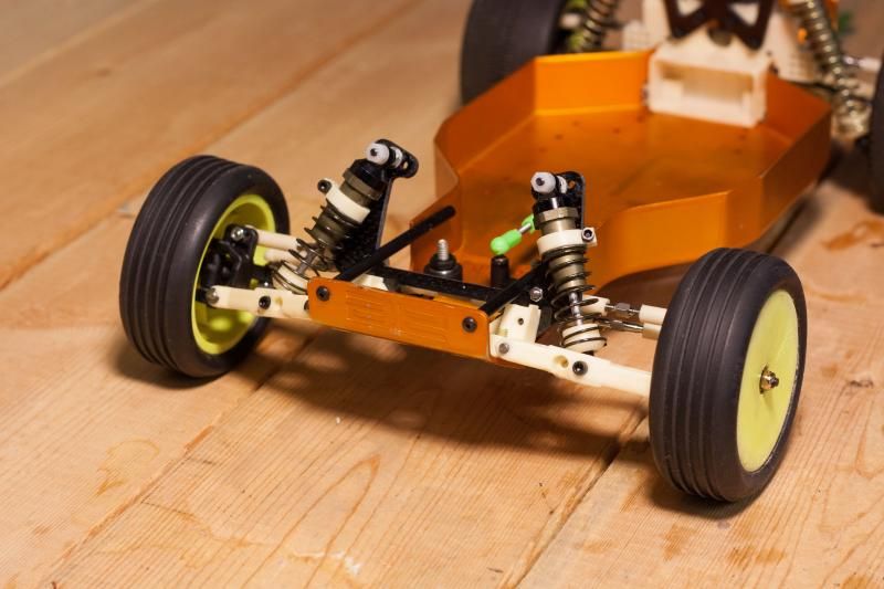

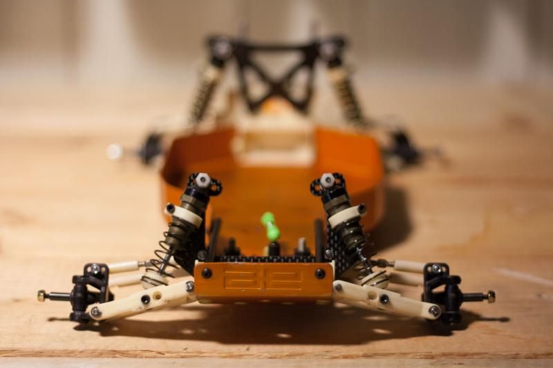

I got all the shocks rebuilt, and rebuilt the diff as well. Got the transmission holes countersunk and put the stealth back in. I got a set of B4 tires and wheels from another forum member which i think look pretty good.
Waiting for the motor, wing, and still trying to decide on a body. I'm thinking about a viper right now... anyway, on to the pics!

Looks good !! Im new to this forum and this is actually is my first post but I have a question for u, I noticed the rear of the motor plate is cut down at an angle and have only seen the later black plates cut down like that, never a gold motor plate, did associated do this from the factory or was this a common thing guys were doing to modify their cars ???

Travertini wrote:Looks good !! Im new to this forum and this is actually is my first post but I have a question for u, I noticed the rear of the motor plate is cut down at an angle and have only seen the later black plates cut down like that, never a gold motor plate, did associated do this from the factory or was this a common thing guys were doing to modify their cars ???
Yah, this was a thing that racers did back in the day to keep weight down. I actually bought it like that from a forum member...

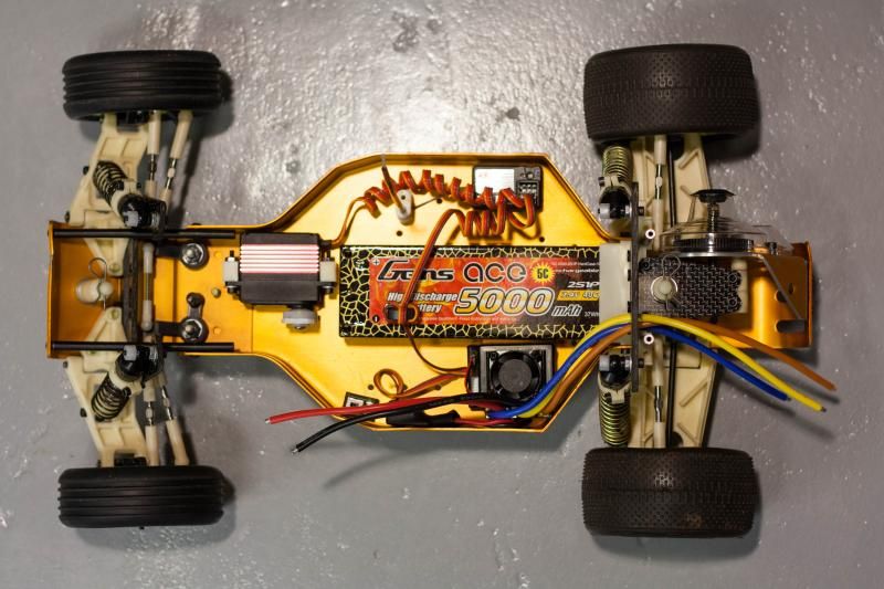

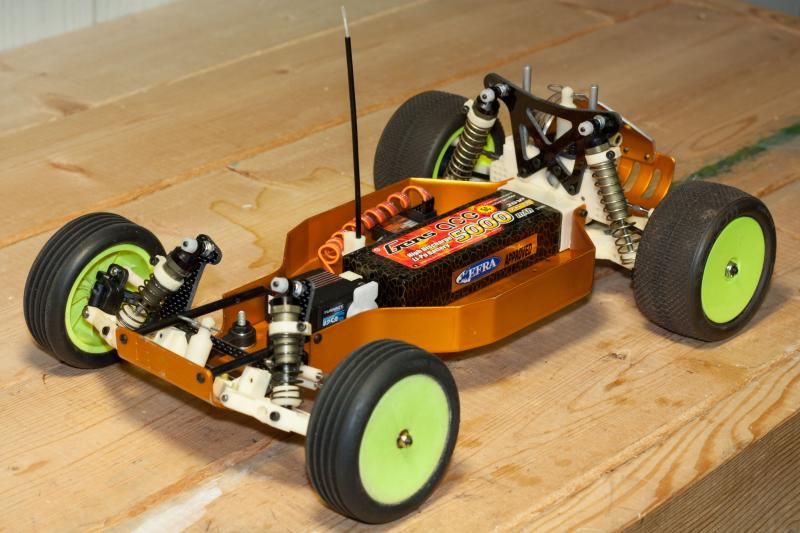

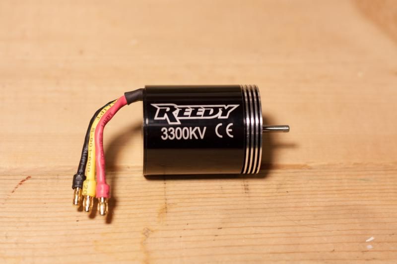

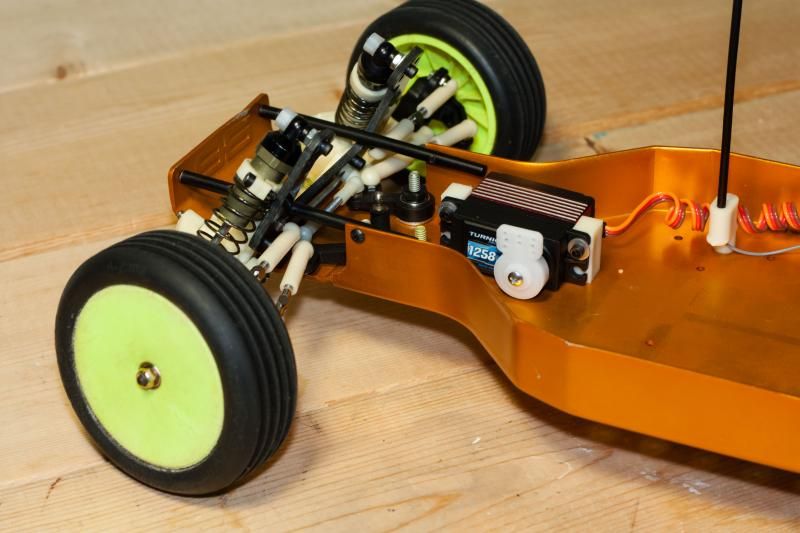

Got the motor in the mail today, the treads to mount are metric which is strange...I'll have to round some up. I countersunk the holes in the shock tower opened up the rear bulkhead to accept the gens ace battery (don't hate). I fitted the receiver, and speed controller, and servo. I don't have a rod long enough to connect to the bellcranks and it looks like if I have a straight link it might interfere with the servo. Not sure what I'm going to do with that. I might try mounting it different ways.
I'll be needing a bunch of random electrical banana connectors... screws etc. I've also ordered a body, an Associated Viper. Going to get my old (25+ year old to be a little more precise) airbrush out and see if it still works. Going to round up some decals and paint once I decide the colors, I'd like to have a retro style racing paint scheme...mmmm.
You needed to use the bone from the rear of the Jconcepts BJ4 4wd buggy #1137 if you really want the correct size.

[quote="uniquenamehere"]Got the motor in the mail today, the treads to mount are metric which is strange...I'll have to round some up.
not really, Metric motor screws have been used since 1984 on the RC10 :wink:
