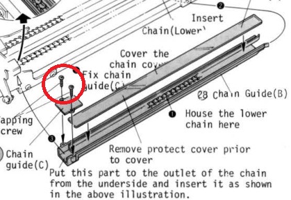

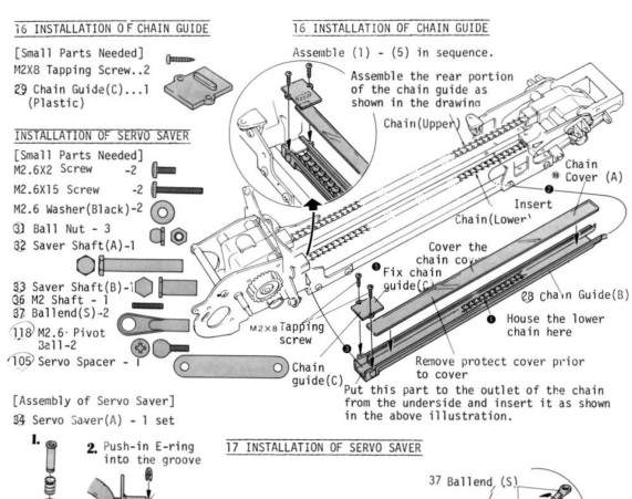

As my first time going through the Optima instructions, I find myself having to re-read some of the steps several times. For example:
Visually, there's just a lot going on in that picture! And step 16 is listed twice, etc.
But other parts are ok.

That was it. Thanks for the tip! With that front joint collar installed, there is enough clearance for the chain guide.DennisM wrote:If You mount the transversed alloy "pipe" between the gearbox mount plates, I think it all falls into place?
But the joint collar won't fit unless the M3x45 screws in the gear base and plates are loosened quite a bit.
And of course, with the joint collar installed, you can't access the chain guide end-cover screws
But just the act of loosening the M3x45 screws lets the chain guide slide in. Writing all this down makes it seem more complicated that it really is - it's not. I just think it's funny.
Success
