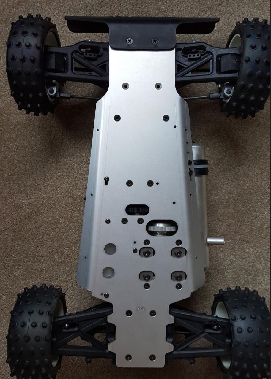

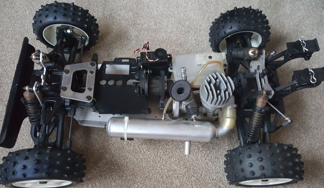

Here are a few pictures of how the car arrived. It was pretty grimy (pictures don't really show it) but immaculate underneath. I am expecting a great result. Hope you enjoy.

I have 2 extras O.S RX-B engines, one Ron Paris version but has slightly sanded blue head to remove some scratches, manifold and a few pipes, but no spare blue head. I would install a 18 tooth clutchbell and a case harden steel main gear for the center differential.
My Burns became the twin headed monster truck... Also the body on the engines are not identical, you have an early version bottom of the totem pole in terms of power. If the BSW 1,2 steel gears were such a failure I'm sure they would complain about them during the Jack Johnson Southeast shoot out back in 92, they ran the crap out of them with no failures..

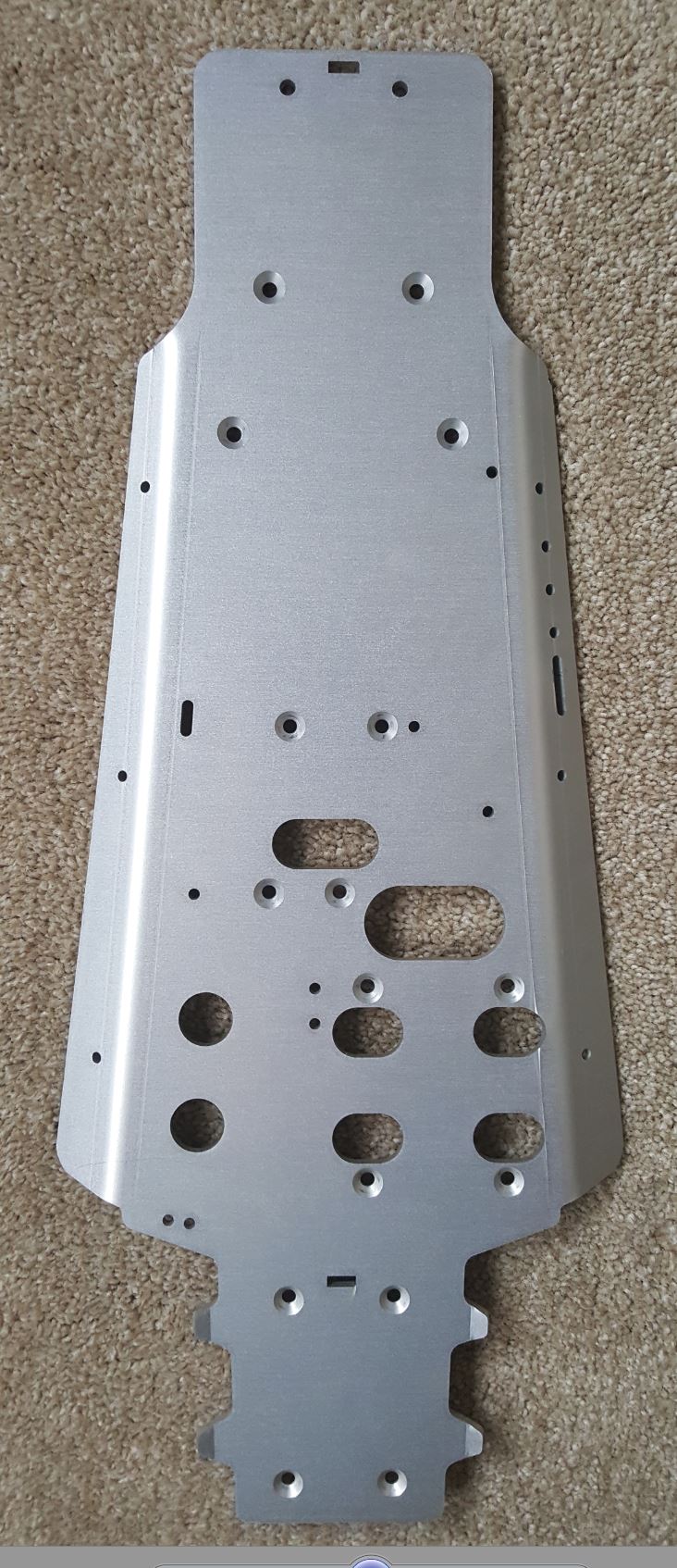

I have torn the car down, and am cleaning all the pieces. So far, no issues other than some stubborn nuts due to locktite. I have some option parts on the way, which I feel lucky to have found.
I may have found a brand new, optional hard anodized Gold chassis. I am kind of excited about this.

Yes it came straight off the dual engine ready for powder coating. I manage to fine another Burns/ crusher chassis in my stock pile and made a back up chassis this time I bend the chassis without make the slit cut you see on the gold chassis and was powder coated Blue.Nice looking buggies. That dual engine Burns chassis is insane! I am assuming that is custom?

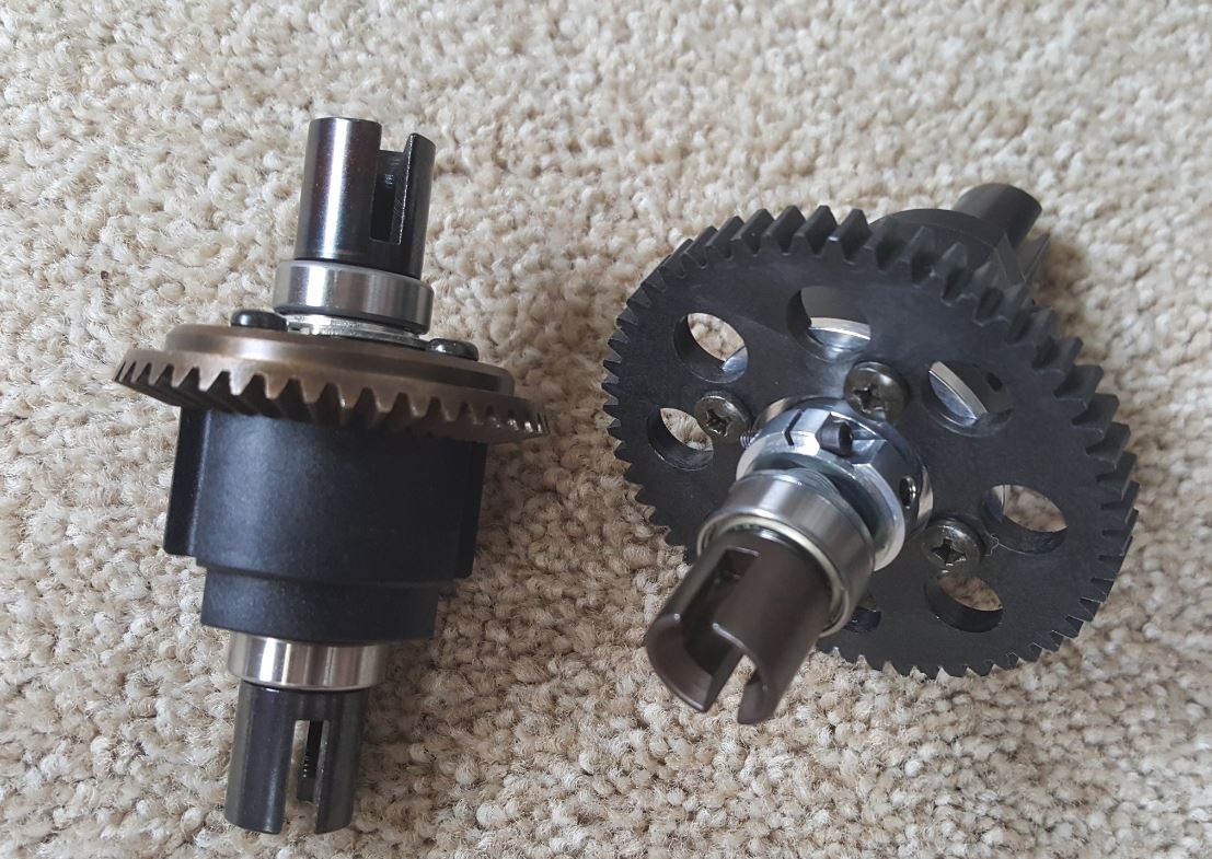

As for that engine I have forgotten about that version. Looks like you might have the case harden steel gears, came stock on the top of the line Inferno and some turbo version, according to the manual if came with BWS 1,2 a better picture of the gears teeth and I can determine if that is indeed the case. Also the giant e-clip retainer to hold the gear on to the housing is good sign, I believe the Aluminum and the cast gears did not used the e-clip retainer.
