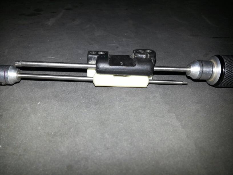

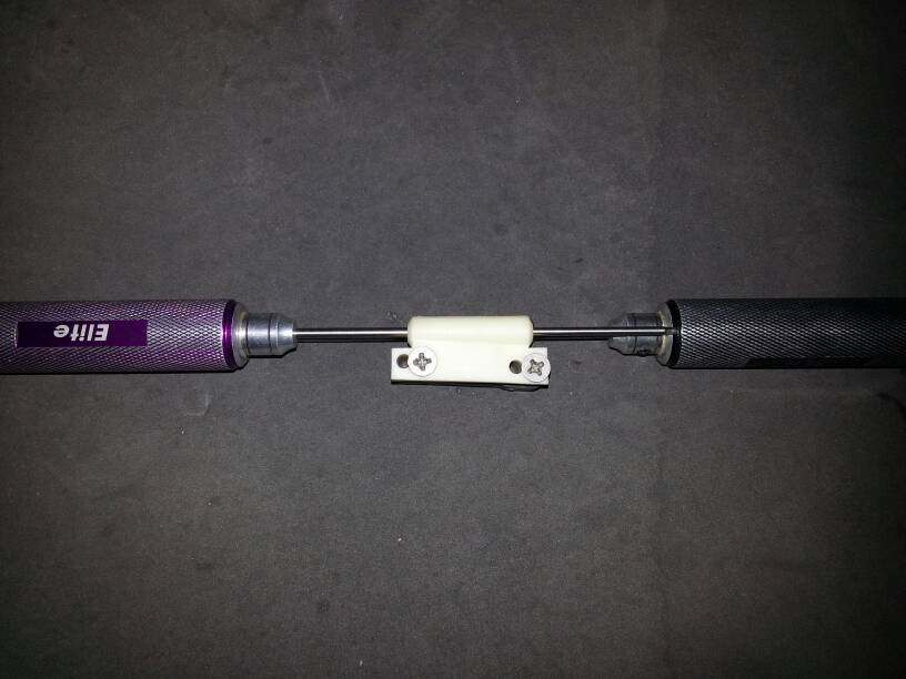

New out of pack re-re with a T2 mount. They are 3

Post by JK Racing »
But the T2 mount is moved back a hair
--Joey --

What part number is that Joey?
JK Racing
Posts: 4619
Location: Placentia, CA
Has thanked: 139 times
Been thanked: 246 times
Re: 3 versions of the 3 degree arm mounts?
Post by JK Racing »
#6360, I opened the pack to take those pictures. Ran them on the car last night as well...:)
