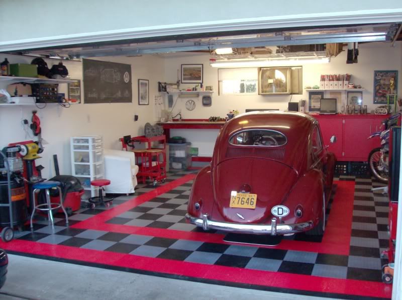

You have a lot of jealous guys out there right now. That's a sweet garage, and car too 8)
