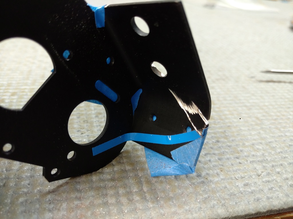

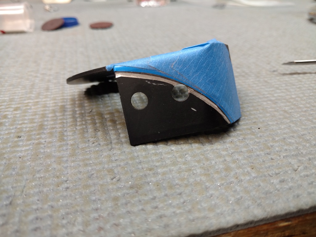

So, I started cutting up the motor plate. Going all nice and slow...... being all careful and stuff.....
And once the cut off disc broke through, it felt the need to whip underneath and screw everything up. :roll:
So I guess that will be going out for ano one day. :lol:
The Whisk Rust Remover I got to remove the blue from FT turnbuckles does a decent job removing ano too. The only thing I touched this with was a plastic covered scrubbing sponge with some soap on it to remove the smut.

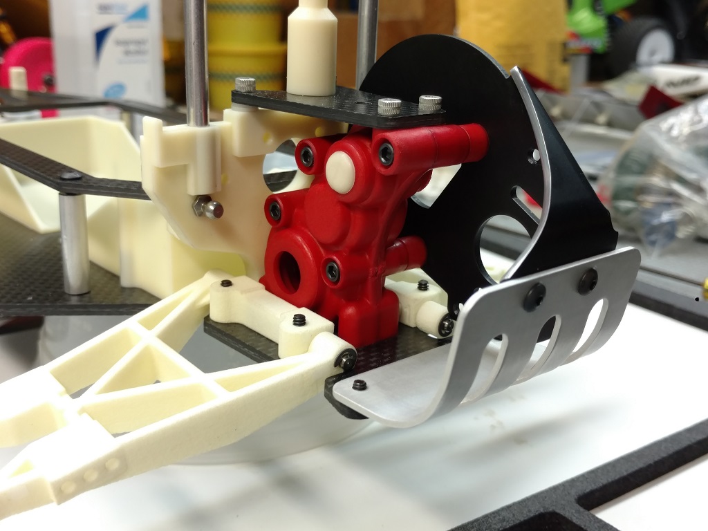

And put together.

Beautiful! Did you tea stain the Shapeways parts? They appear to match the AE nylon perfectly.

XLR8 wrote: Mon Jan 15, 2018 11:42 pm Beautiful! Did you tea stain the Shapeways parts? They appear to match the AE nylon perfectly.
I've done the tea thing on another build and I was not happy with the results. Did what I could with yellow RIT powder dye to try my best to fix it.
This stuff I did with straight RIT golden yellow powder. 1/8 tsp of powder to 3 1/2 quarts of water on med-high (almost boiling). Drop the parts for 3-4 seconds, take out and rinse with cold water. Some pieces will suck it up quicker than others so you kinda have to play with it.

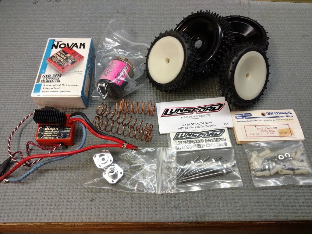

Some other goodies for the build. The receiver is NIB, but it's 75 band. Kinwald probably used 27. I had one of each, but the 27 went in my Brad Reelfs replica. I have a near new 1400 scr stick pack I have to break down and reassemble side by side (forgot to put it in the pic). The motor is used but near perfect. The esc is super nice too, and i may not have to rewire it (fingers crossed). One thing I don't have is a servo. Not exactly sure which one he used...... probably a 94737 or 94151.
