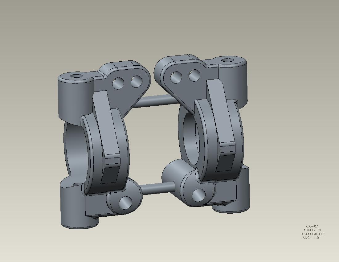

Re: 4WD RC10 project

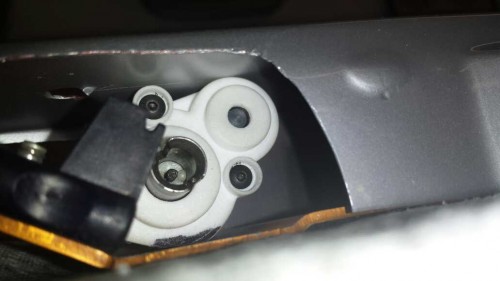

Got the transmission to fit neatly under the body
The parts will be on their way to Jeff in a day or so for him to work on the steering and tower.
I'm going to order these today. I've modified them since I first posted a pic to have the same camber link geometry as rc10 caster blocks

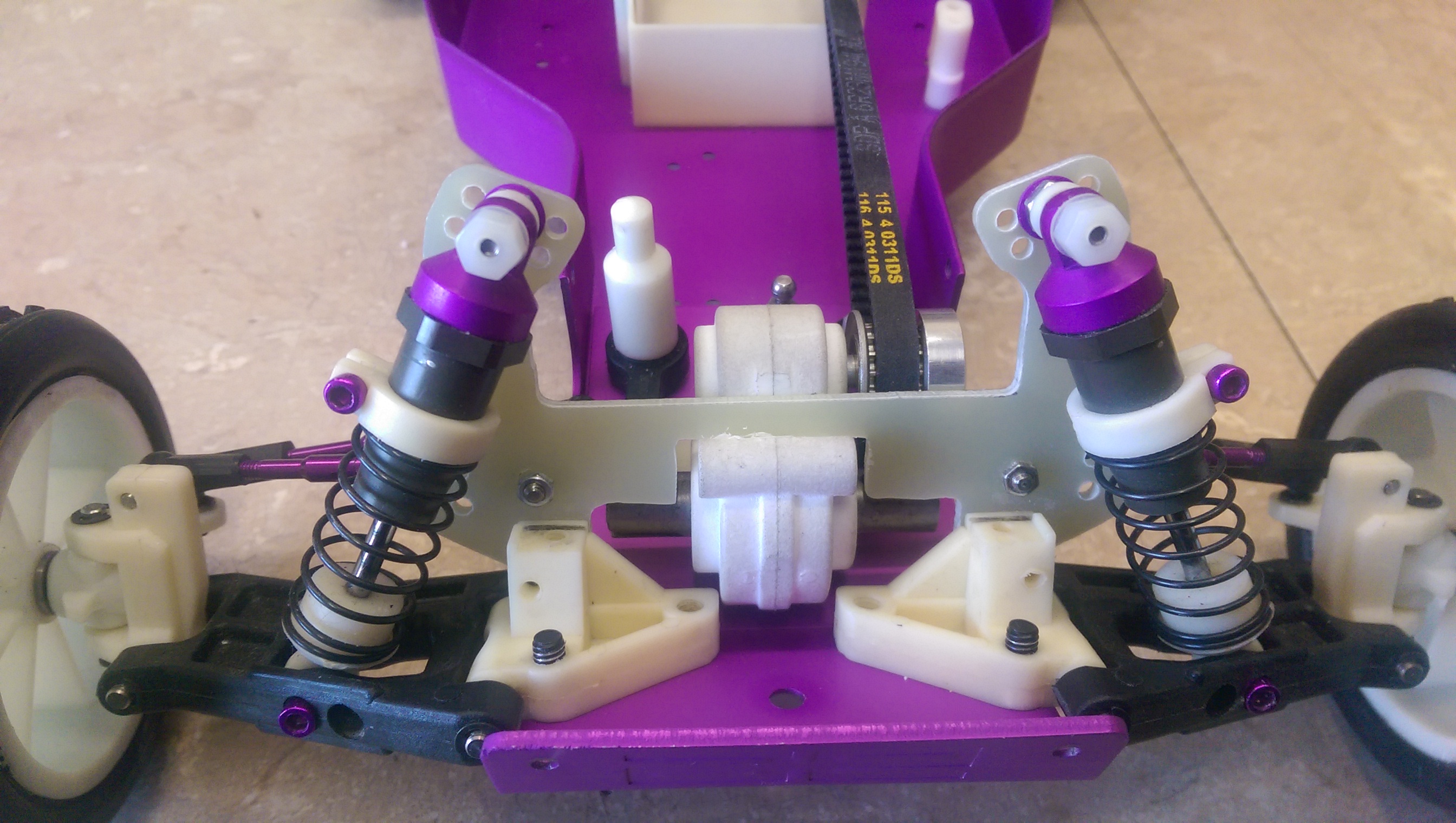

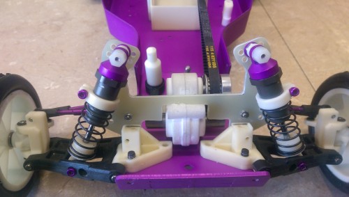

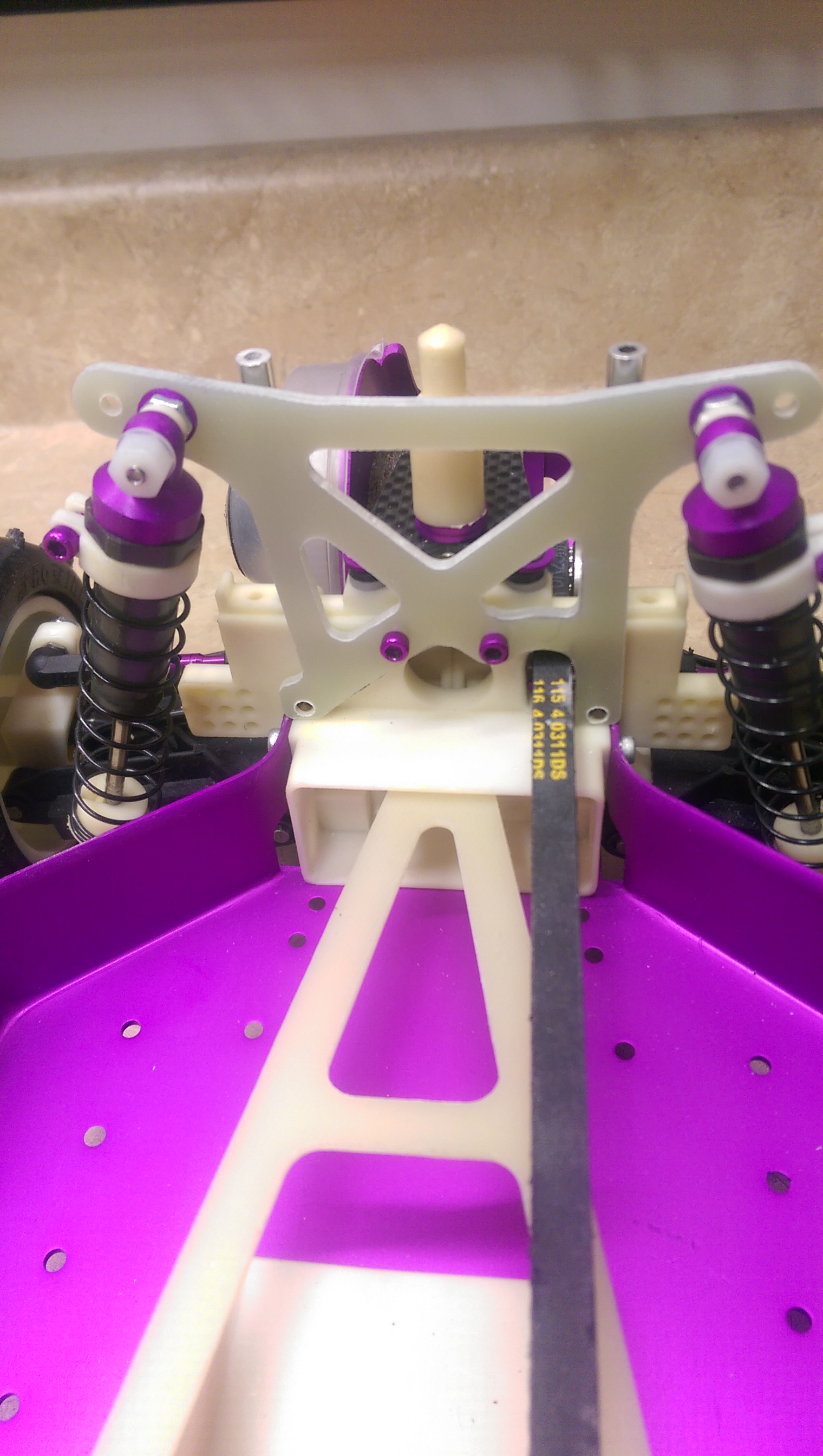

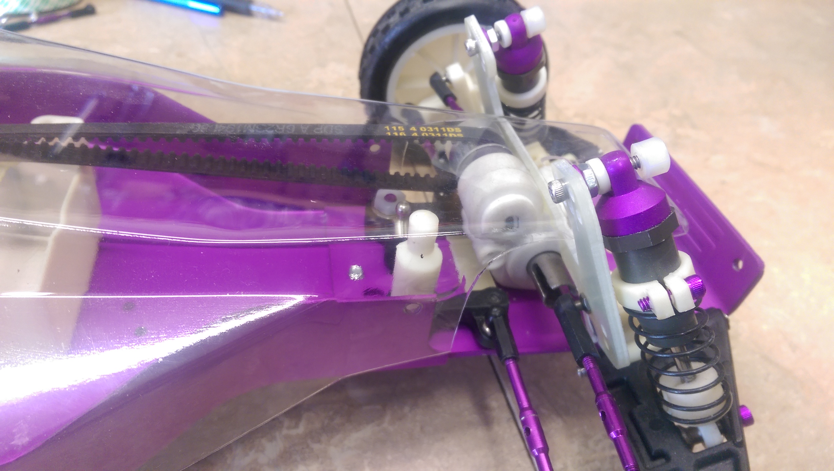

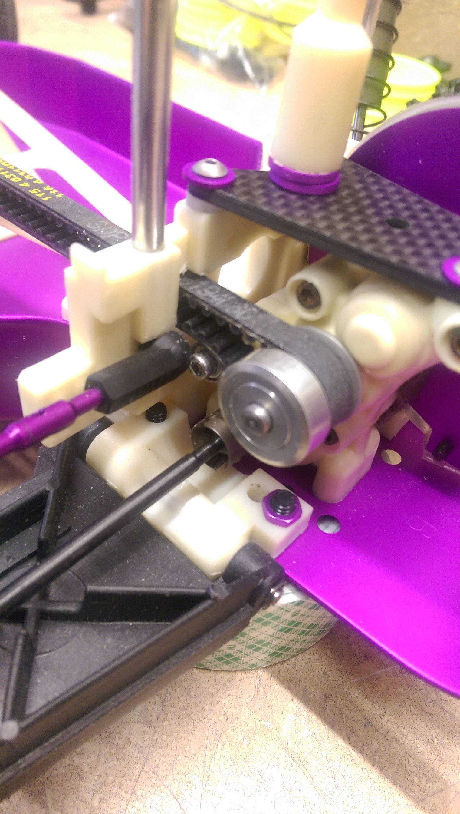

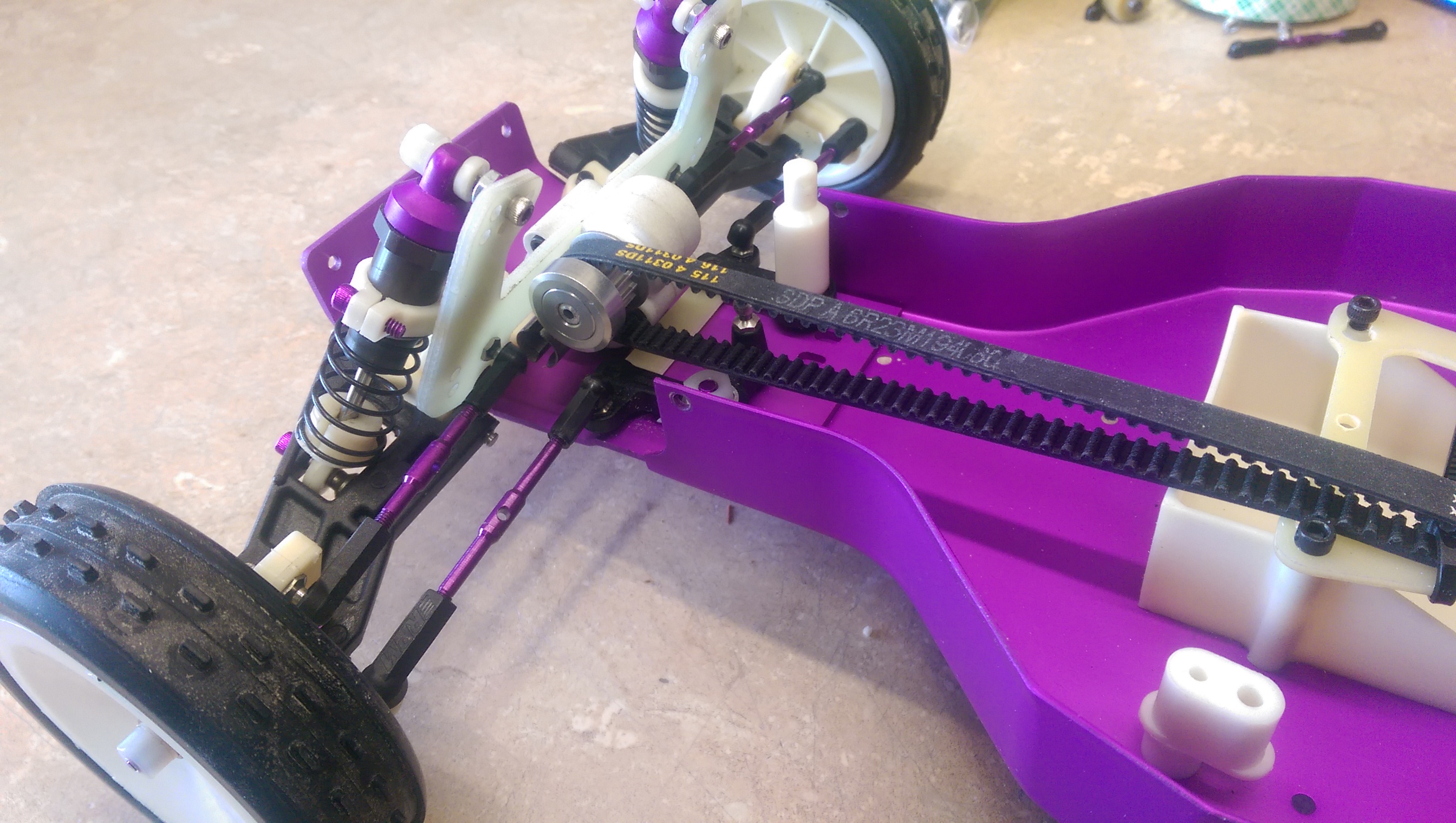

Couple more progress pics.
Thr front gearbox fits well with the nose in lwb mode. Since MIP made you extend the nose anyway I don't feel too bad doing the same. The bellcranks will actually work well where they are with the longer b44 steering knuckles too. The front gearbox will sit pretty close to how it is shown here but currently has no actual mounts. Nice wide belt for modern brushless power.
The front tower will look correct with body on, but had to be severely changed under the body line to get the gearbox in there. There is more meat than MIP gave us, so I feel confident the durability will be OK.
I need to get ordering more belts and pulleys, I can only hide the belt being too short and old having one pulley for so long before you guys are gonna want a pic of the whole car
front tensioner will follow as well
