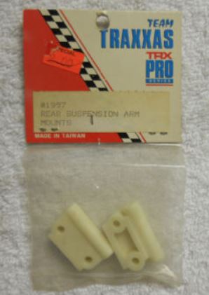

I am currently working on 2 Rad2 runners, one mid motor, one standard.
I will need to hack into the left arm mount to make it fit in mid config.
If you budget is that tight these mounts fom the RAD2 / Hawk etc. might help: Just google traxxas 1997, and you'll find them for about 5 bucks.
That is of course only if they still use the same hole pattern. Can any of the Traxxas experts confirm?
You'd have to cut the current mount off of the stock gearbox that you're using. But it is $15 saved...
Good luck, Tony
Good luck, Tony

I don't know if it is a valid option but maybe it is possible to separate the arm mount part from the gearbox with a dremel and cutting disk? Ifso you could switch the armmounts back to the original sides. Things will loose some strength though.

I 'm not sure if you cut the arm mounts off, that the gearbox has any mounting holes. I know that is the case on the bullet, but not sure on the bandit.

I wasn't sure either, so I checked the exploded view onlinejwscab wrote:I 'm not sure if you cut the arm mounts off, that the gearbox has any mounting holes. I know that is the case on the bullet, but not sure on the bandit.

Mr. ED wrote:I don't know if it is a valid option but maybe it is possible to separate the arm mount part from the gearbox with a dremel and cutting disk? Ifso you could switch the armmounts back to the original sides. Things will loose some strength though.
I did this before on a project. You'll definitely lose some strength because the arm mounts on the Bandit trans are mainly what holds the whole thing to the chassis. I ended up drilling two more 3mm holes in the cases, in front of the diff. That's basically how the older Hawk2 trans was mounted, with the exception of it also being keyed into the rear bulkhead.
I'm sure it still wasn't as strong as the stock Bandit mounting setup, but I never had a problem with it and the truck was raced frequently.
Hard to tell in the pic, but the stock arm mounts were dremeled away and replaced with Nitro Rustler arm mounts:
Extra 3mm screws in front of diff:
I made my own chassis for that build, so I had the ability to make some adjustments. IIRC, the stock arm mount holes in a Bandit/ Rustler chassis will line up with the Nitro Rustler arm mounts, but the mounts will sit slightly off-center compared to the diff outputs (hope that makes sense). Don't recall any interference issues, but it didn't line up as well as the pic i posted with the g-10 chassis.

The part number for those mounts is:
Traxxas TRA2798A
a-main has them for 2 bucks plus shipping. Of course the extra holes in the tranny case become necessary.
new holes in the chassis amended as well, but I guess you have those already.
a little more for the cheapest solution
Traxxas TRA2798A

i appretiate the help but im just going to do the bandit a favor and get the rpm transmission case, my stock trx one is already hashed pretty bad and it is ~ 8 months old. just not made for the power a castle motor can deliver i guess... while im at it i think i'll get a 2nd one for my next build after the bandit is up to spec with what it should be.
