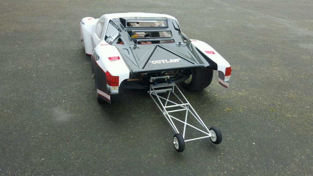

Not to hijack but while on the topic of speed runs ans short course this is my street sweeper. 6s power good for about 2hp.

^that is perrrdy when the slipper gets locked out i may be contacting you about your wheelie bar
even WOT the stock GT2 trans has held up well to 4s. But yes thank you. Now I NEED that tooharvey wrote:I have been following this thread, and I think you're nuts! (in a good way) Tightening the slipper down 'til it is locked with that much power sounds risky to everything downstream in the drive train to me, but maybe you need one of these?
