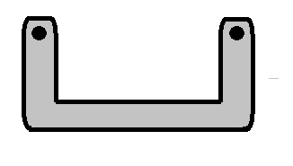

What if you did something like this (in the stock holes of the 10-4 steering)?

That was the design I was hoping to use, but due to the height of the bellcranks it would hit the tranny input shaft at med-full travel. I'll get a side pic that shows how little room there is in there. Thanks for the suggestion though.

What you are seeing is bump steer. You want the bellcranks 1.5" apart at the center link to make the bellcranks work as designed, then get the tie rods as parallel to the upper rods as you can. That should get rid of most of the bump steer. Also make sure your camber links are high enough. On the ten4 if you use the lower holes it throws the bump steer all wonky.

The inner and outer wheel at different angles is also ackerman. The wheels should not be parallel, there needs to be more on the inside than the outside. If you have another 4wd car, measure the amount of ackerman at full steer to see if you are close or not. Adjust your center link to achieve the proper setting (Search YouTube, I think Drake did a whole video on ackerman and adjustments and effects).
Bump steer (evil bump steer), is usually adjusted with ball stud height on the steering knuckle. Try a washer or 2 on the steering knuckles. Test bump steer with the wheels straight, it should be present at all angles. I dont think Brian had any on his 10-4 when I had it in hand, we cycled the front suspension quite a lot, looking at all the angles working together. Pretty amazing overall.

It appears the Ackerman is set up correctly (sorry no other 4wd to compare against, it's been canabalized), I now have to work on my bump steer. I'm going to adjust the mount point of the upper tie rod to see if that helps as well.
