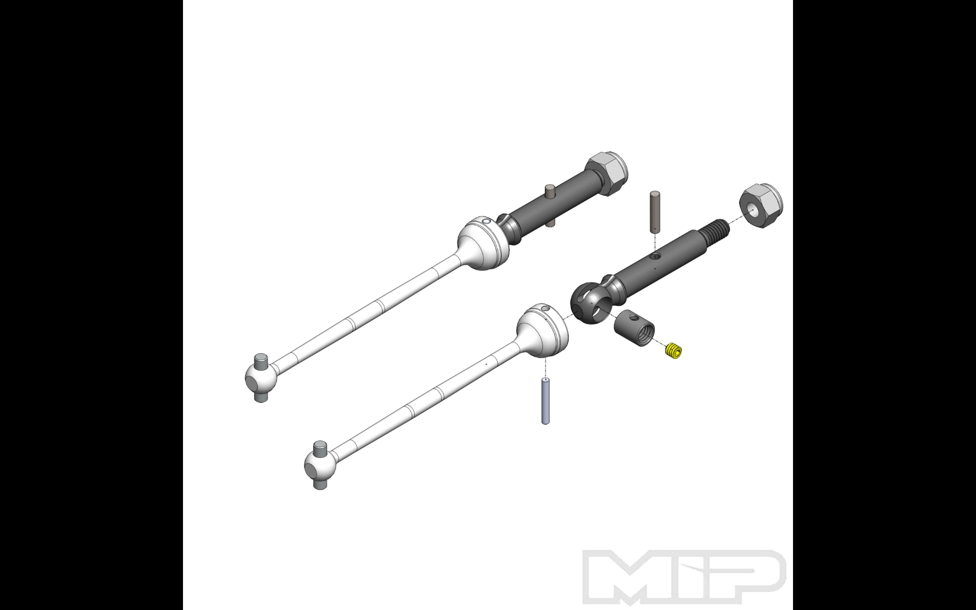

Posts: 3535
Has thanked: 268 times
Been thanked: 2094 times
Re: Help with RC10T3 drive shaft
Here is the basic assembly.
