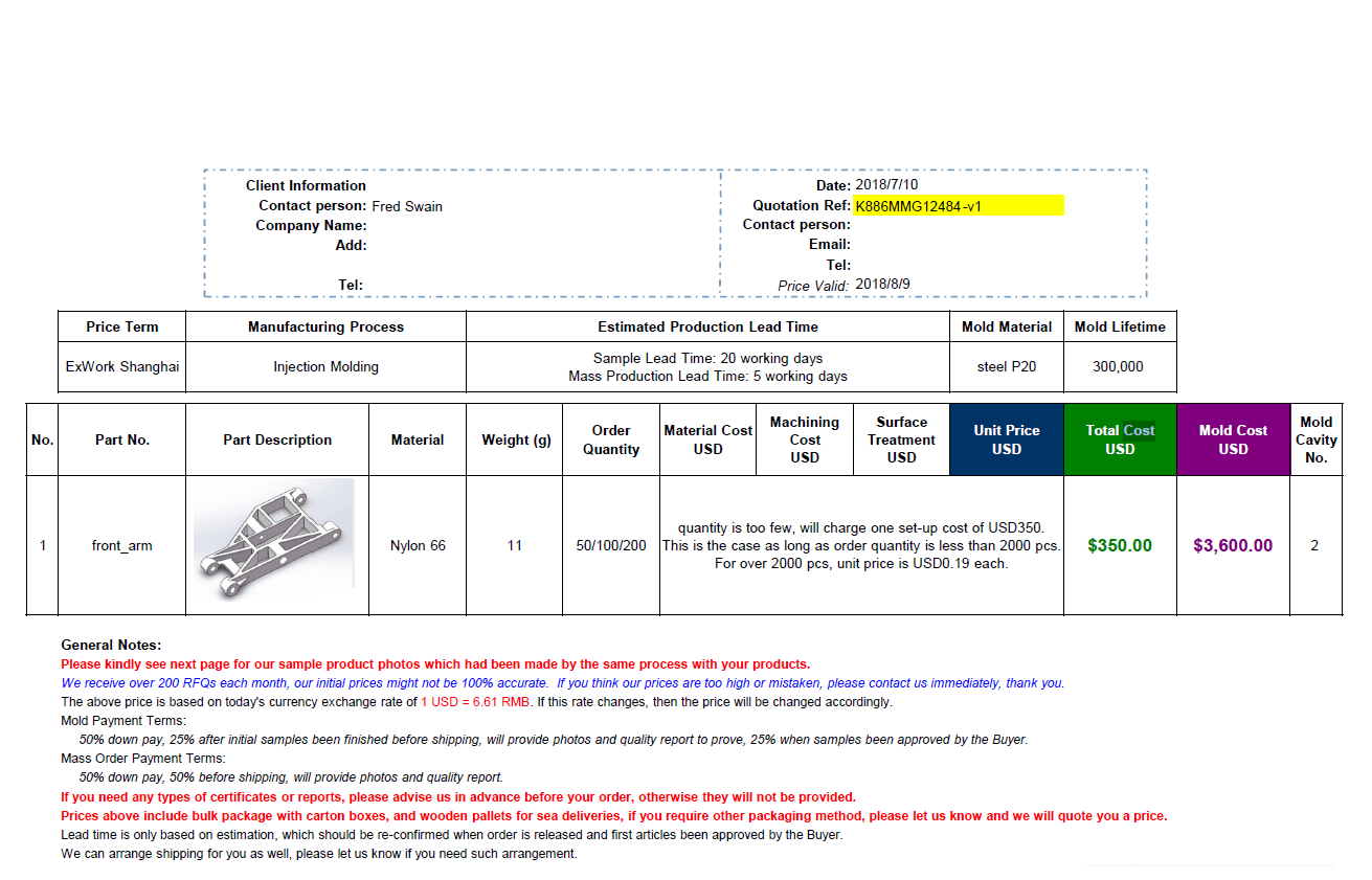

Re: My interpretation of the IFMAR 91 car
I've dealt extensively with injection molding companies at work in the past both in the US and in China. There are good ones there and bad ones here. It's not all only American good only Chinese bad. That generalization does not hold true. The key with doing business anywhere is to find a place that you trust, that does the quality of work that you expect. There's a Chinese manufacturer that I've used that I trust. On average they are about 20% the cost of the American company that we've dealt with and I've honestly seen no quality difference between them. For the fun of it I decided to send off the cad model for the front arm for this car since people sometimes wonder why they can't just have new ones molded. I knew good and well that it was going to be too expensive to be valid but I wanted to get that quote to share it so everyone understands the costs associated with molding parts. Admittedly, there could be a little cost savings by using family molds for trees where multiple parts are made at the same time. That's why they do that. The point was to just show how expensive this is. You'd need to sell 9500 pairs of arms to break even on the initial expense. Once you've topped that number, each arm only costs $0.19 each to make, assuming you order at least 2000 of them. I've removed the company name and contact information. If people wanted different colors, it's another batch of at least 2000. Hopefully this makes everyone appreciate the great financial risk that companies go through in order to get them that new model, and then to change that model every year or two.

That’s about 1/4 of a recent verbal quote I received when describing a part to the people that made my molds.
Little trivia- while I own my molds, I’ve never seen them. The company offers a million pull warranty when you store them there- at no cost. If I remove them the warranty is gone. These were made in the early 90’s so that’s a pretty stellar warranty imo haha

... and there aren't 9500 customers out there to buy these.
I've had similar experiences with molders. For instance, we've sourced a part that was fairly complicated to mold from a company near Detroit (the material was polysulfone). The tooling cost for 2 cavity mold was $35,000. A few years later, we moved assembly for that product to our plant in Brisbane so it made sense to move parts suppliers to that corner of the world as well. The tool for the same molded part from Asian source was $5,900.
The problem with many off-shore suppliers is reliability. They are keen to please at first and then, once everyone is comfortable, the shenanigans begin and you suddenly have product recalls to deal with.
