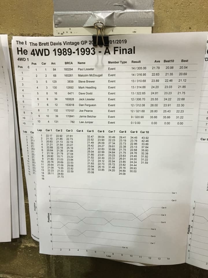

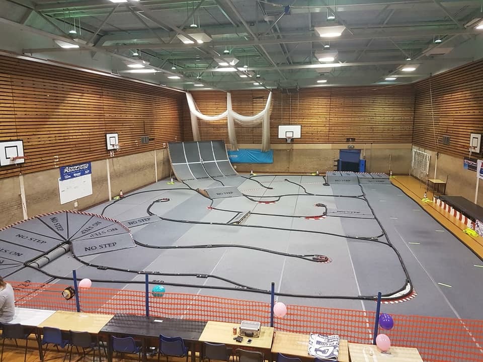

So went and raced the top force st Brett Davis gp (lots of pics on iconic rc Facebook page) from me and others
The topforce went well for 3 x qualifiers and was sitting top 2/3 in class with it, as the day went on the gearbox was getting more noisy and it stripped a spur gear :(
I was running speed tuned gears and had no spares so ended up using my rc10 in the finals
Car handles well but on carpet with the heavy breaking/grip the gearbox is the weak link for this car on this surface

No worries, some more pics
