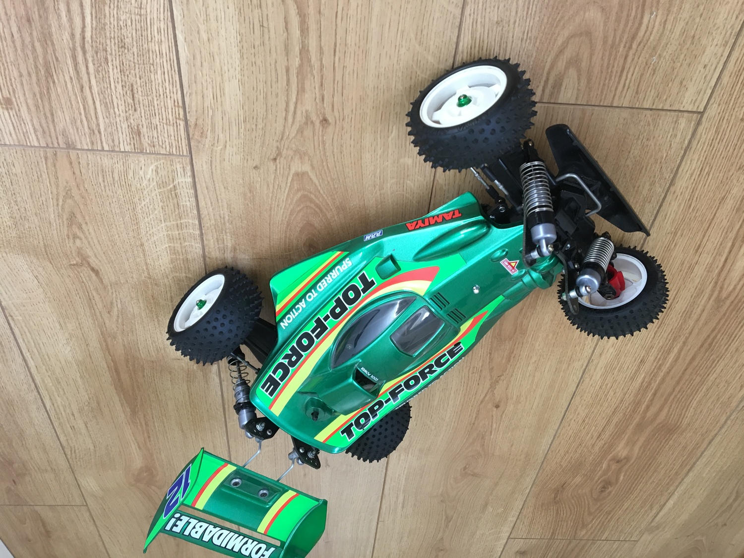

Ive got a big uk vintage race coming up in Jan 2019 and needed a 4wd
Was looking around at various options, zxr, cat 2000 and the top force
My main want was spares availability so went with the top force
Swapped my cougar 2 for this original car and I’m in the process of rebuilding it
Here is the original car

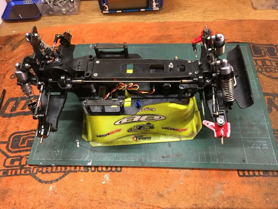

Re: Top Force racer build
Post by Headling »

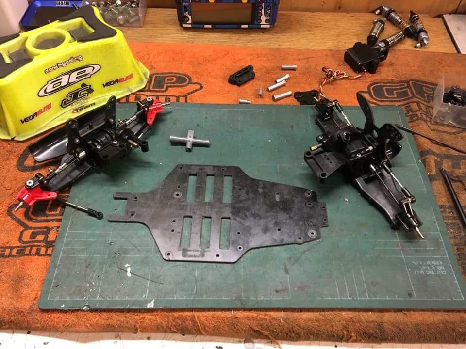

So here is the chassis and it stripped down
If in doubt go flat out!

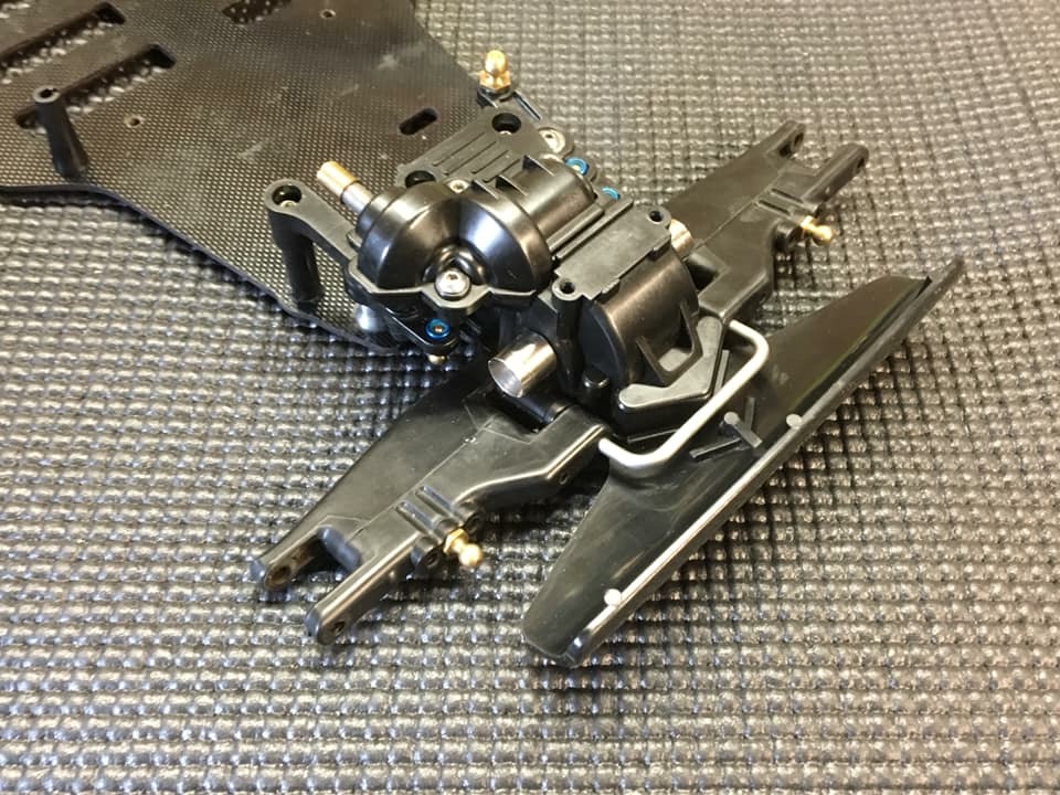

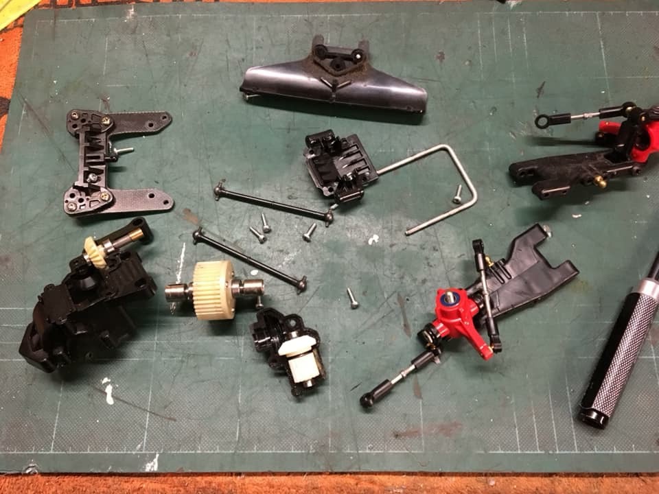

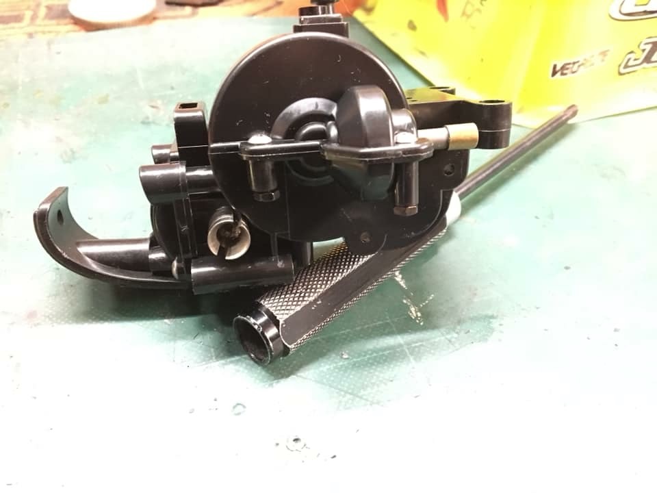

Front gearbox stripped down, the cars got gear diffs which is a result and a one way lay shaft
Quick clean and thick anti wear grease put into the diffs

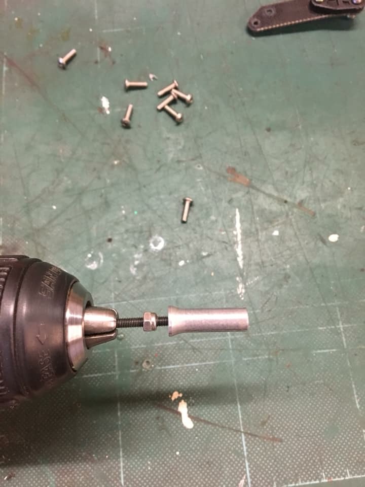

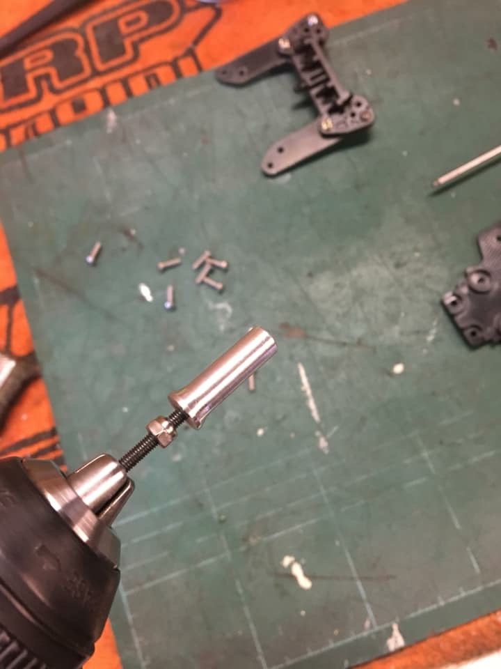

Chopped a m3 bolt and cleaned up all the Ali chassis posts with scotch bright pads and metal polish

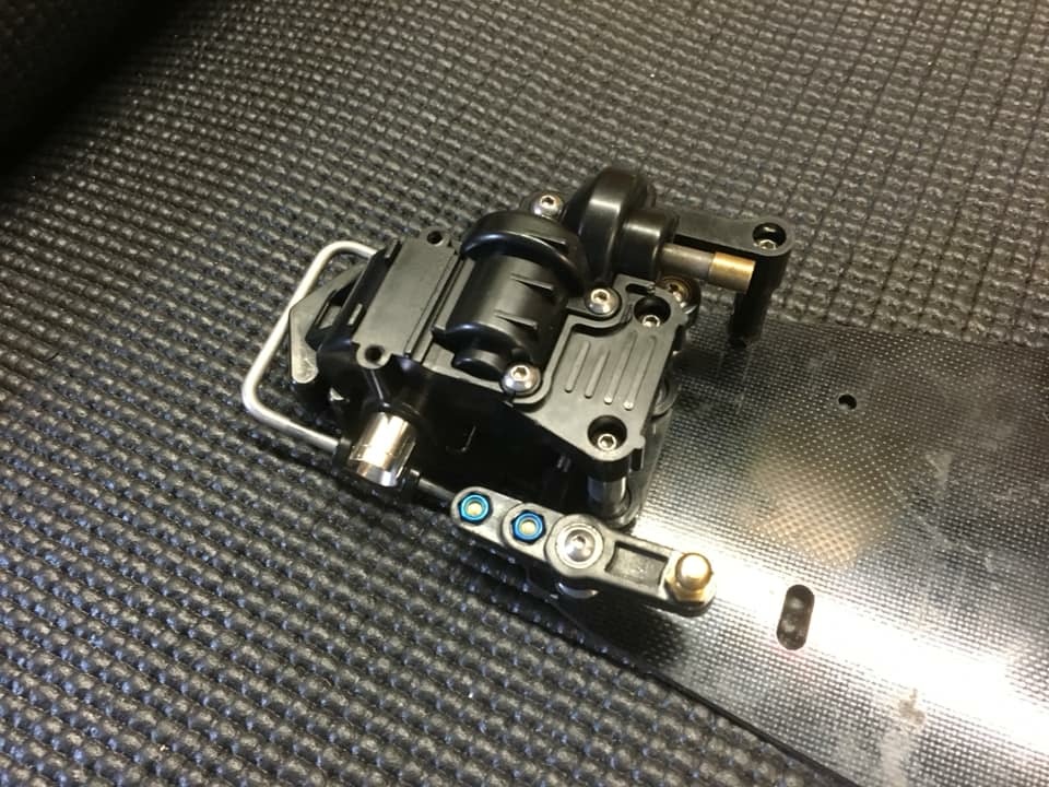

Front gearbox back on the chassis and blue alloy nuts added for the bling factor!
All the chassis edges/shock towers have been sanded and black marker pen applied

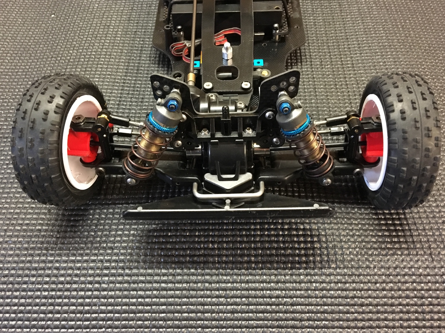

Post by Headling »

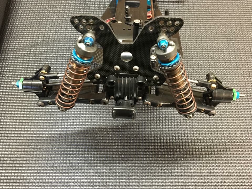

Front tower and shocks on, the shocks are TRF small bore off my 511 and yokomo B.B. springs
I’ve got a proper shock tower coming for the shorter front shocks

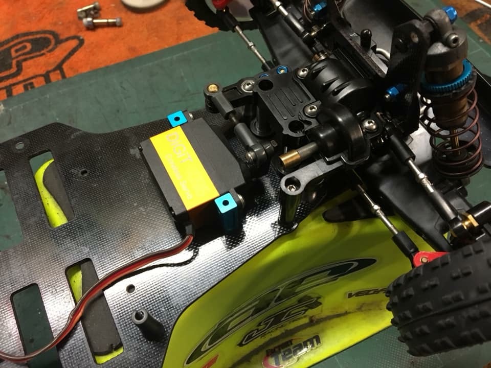

Savox 1258 installed and alloy posts added

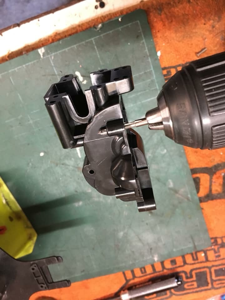

Post by Headling »

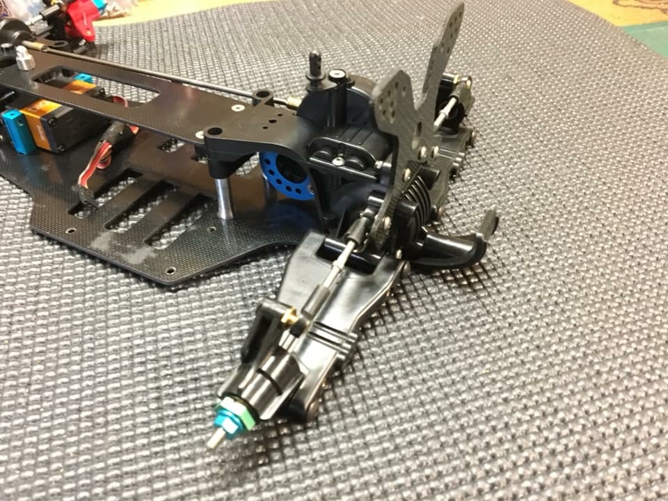

Bought a new rear gearbox case as the original was cracked, tapped the holes out to m3 and used nuts to bolt down the gear cover as read this is a weak spot

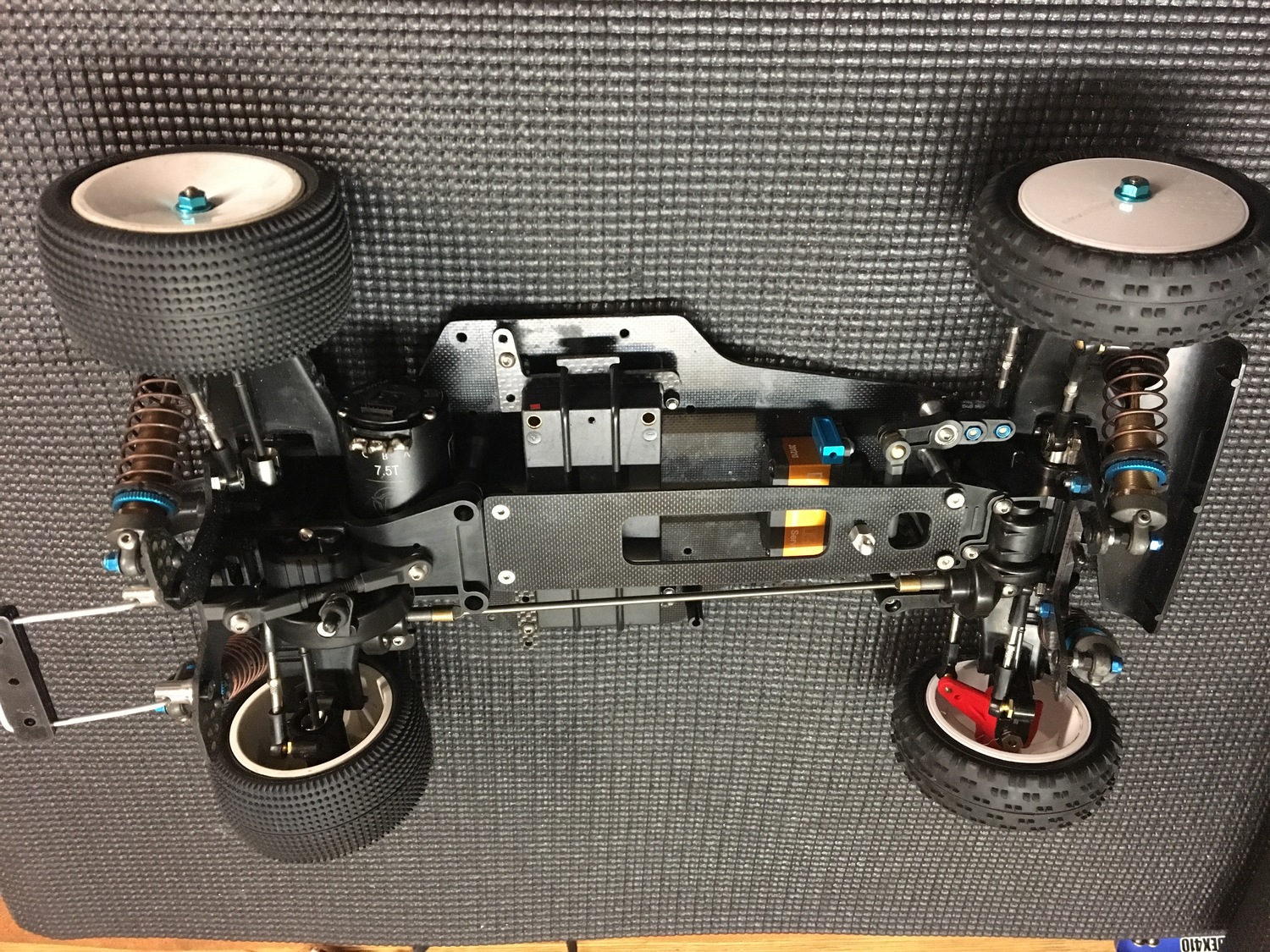

Been thanked: 29 times
Post by Headling »

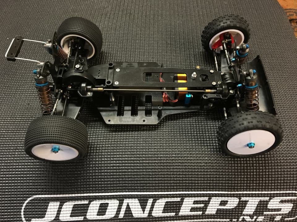

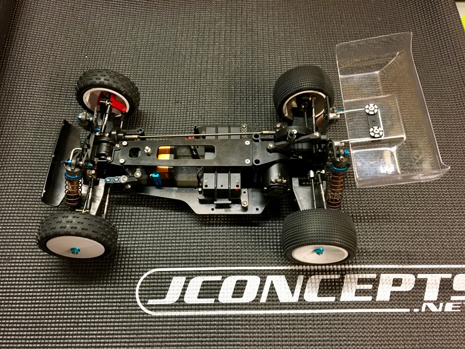

It’s a roller!
Post by Headling »

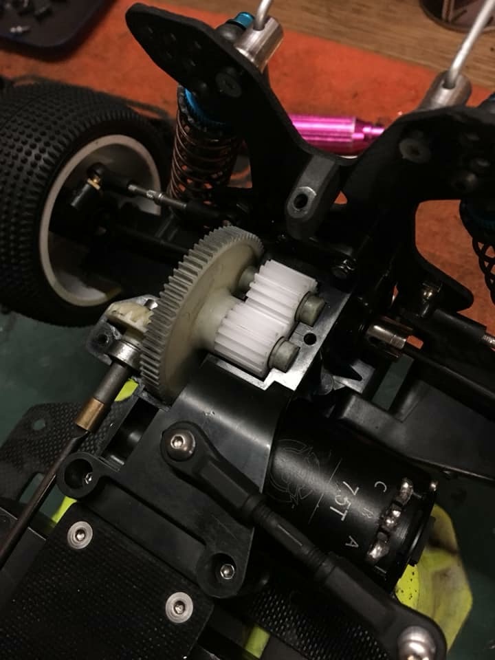

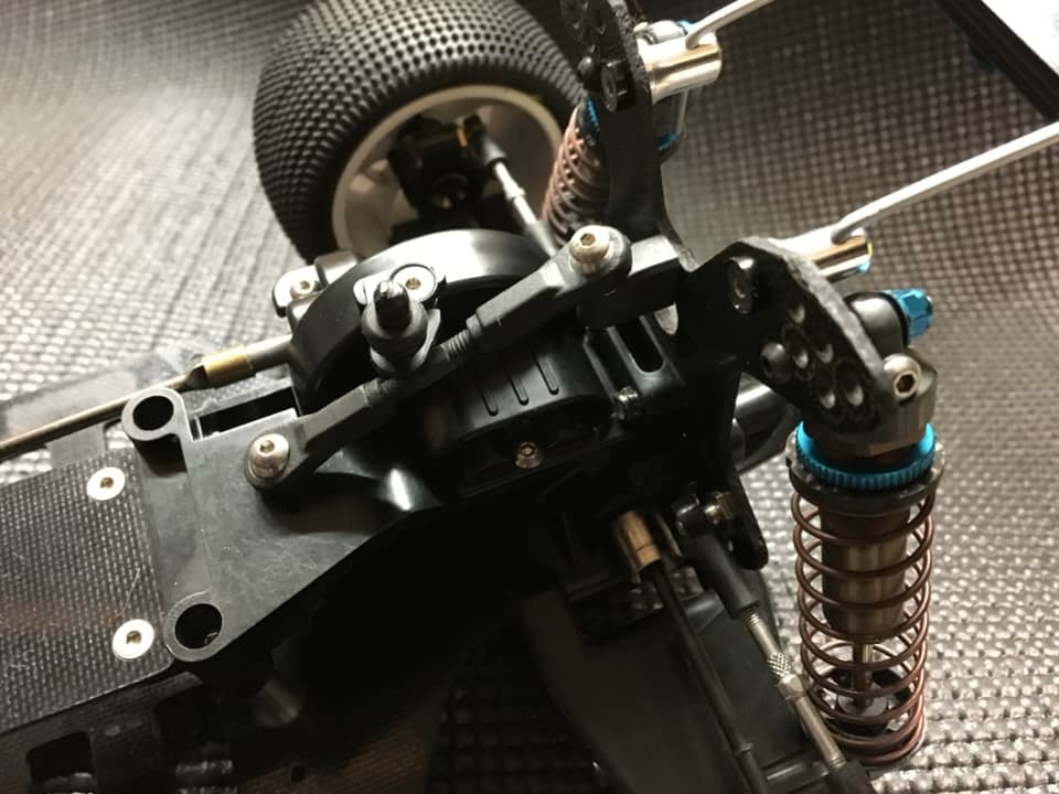

Made up a rear tower brace from the parts bin and the RW nylon machined idler gears arrived

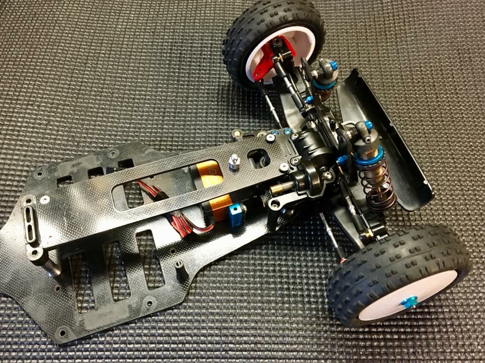

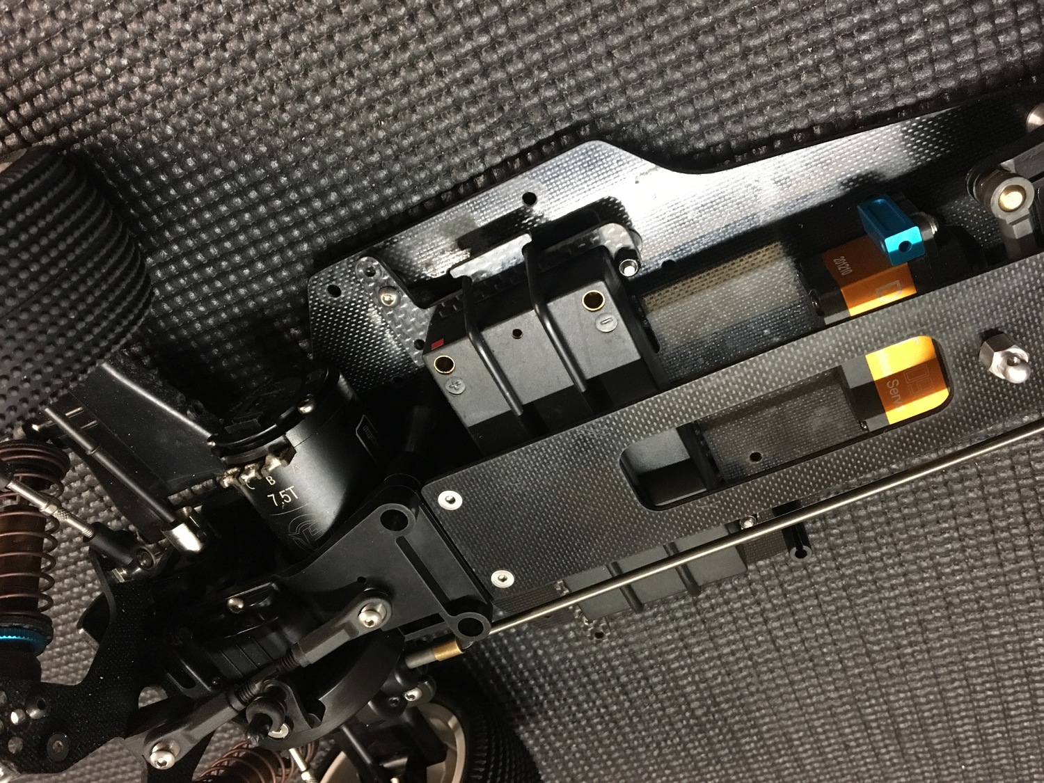

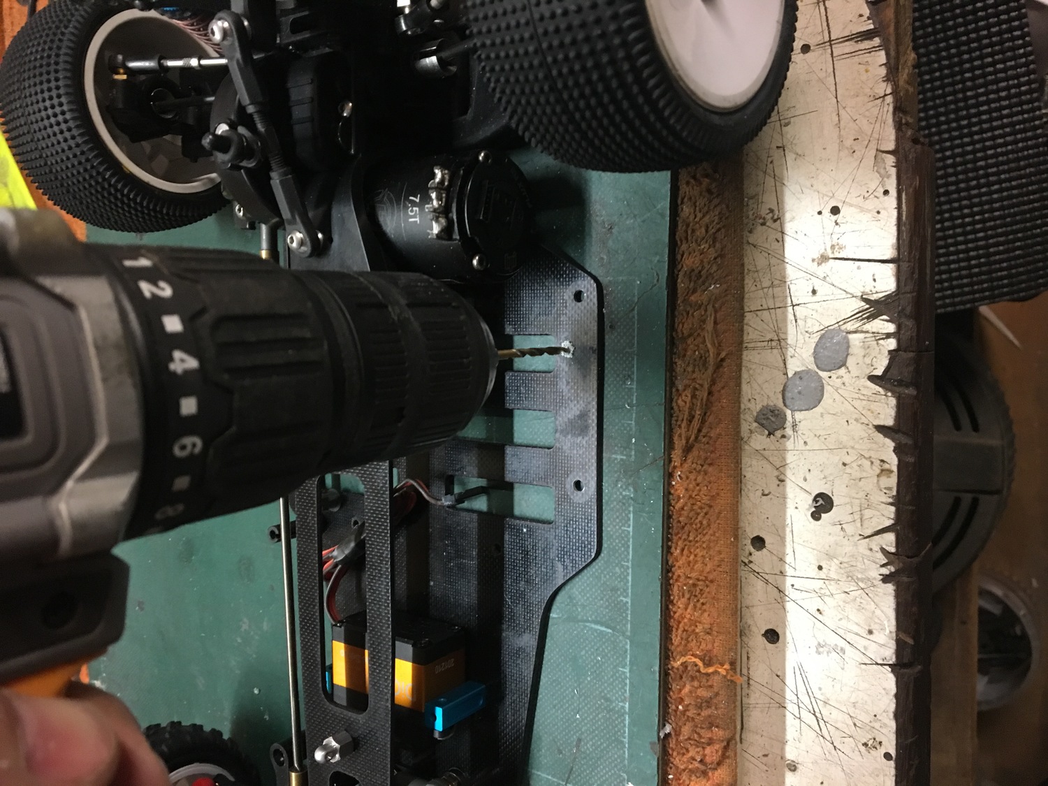

Was searching on line for a Lipo holder for the shorty and came across this from a Mardave assassin pan car, £10 it was worth a shot!
20 mins later and a few holes drilled/Cs and job done!

So my new carbon lower front tower arrived today from a guy on the top force Facebook group
This tower is for the shorter modern style shocks
