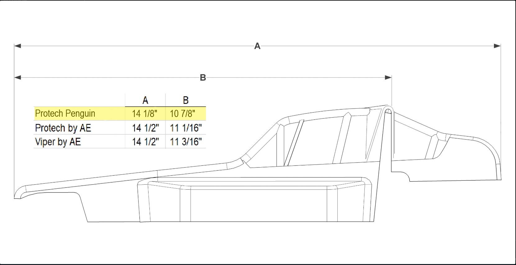

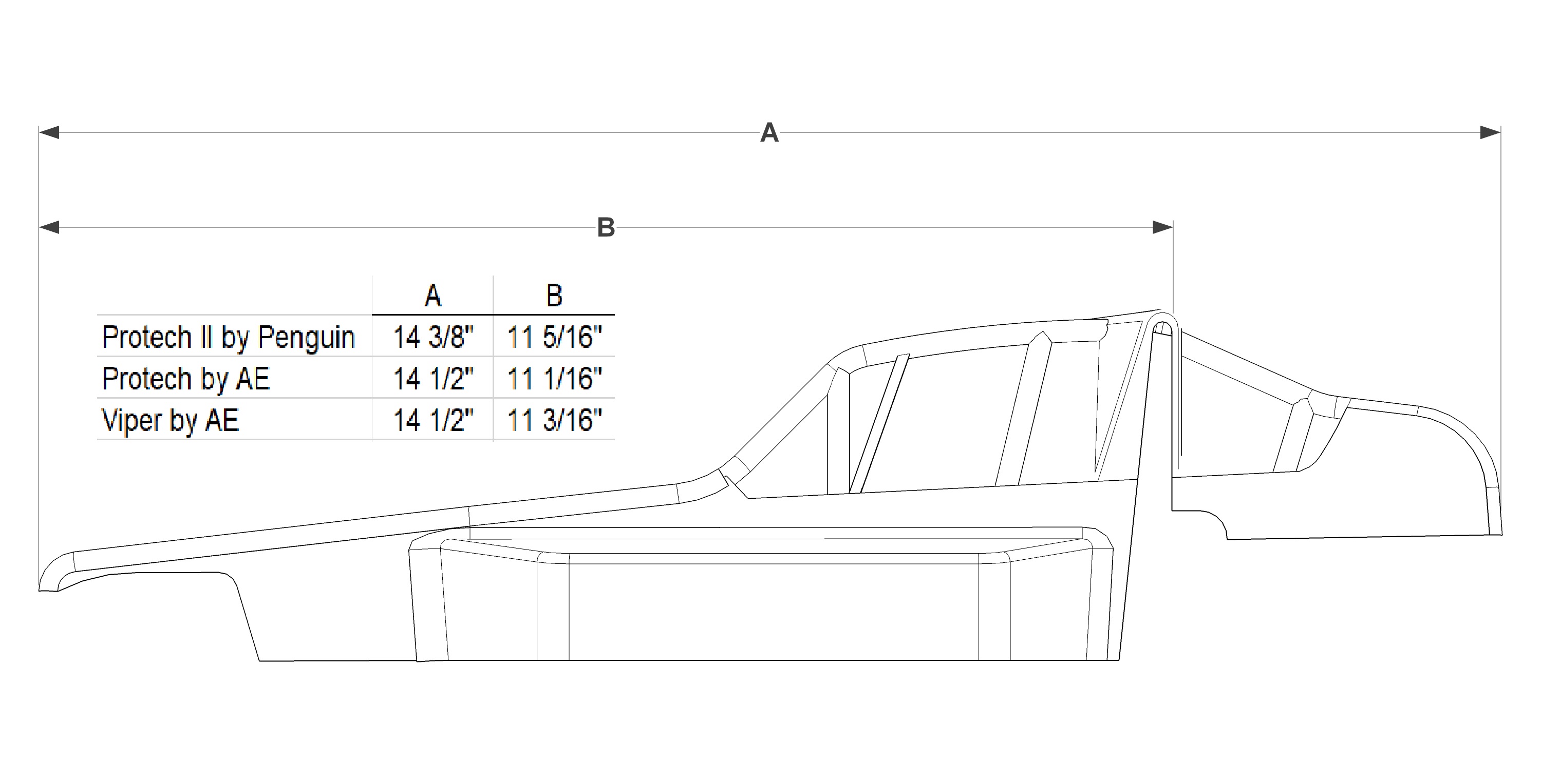

Re: Protech Bodies
As promised, here are some dimensions for the Penguin Protech II.
I don't have an AE Protech II for comparison so I've include dimensions for the AE Protech and Viper - both of which were likely made sometime within the past 10 years.
What's interesting is that although the Penguin body is 1/8" shorter overall, it's actually a bit longer than the Protech and Viper from the rear shock tower to the nose.
Maybe someone has a genuine AE Protech II that they'd be willing to measure for us? For reference, the available length at the chassis is 11 1/4".

Re: Protech Bodies
Thanks for the nifty graphic depiction.
Thought I could add my finding on the Penguin Protech body.
I can't do a graphic like Doug can but I sure know how to steal and modify it.
Chuck
Chuck

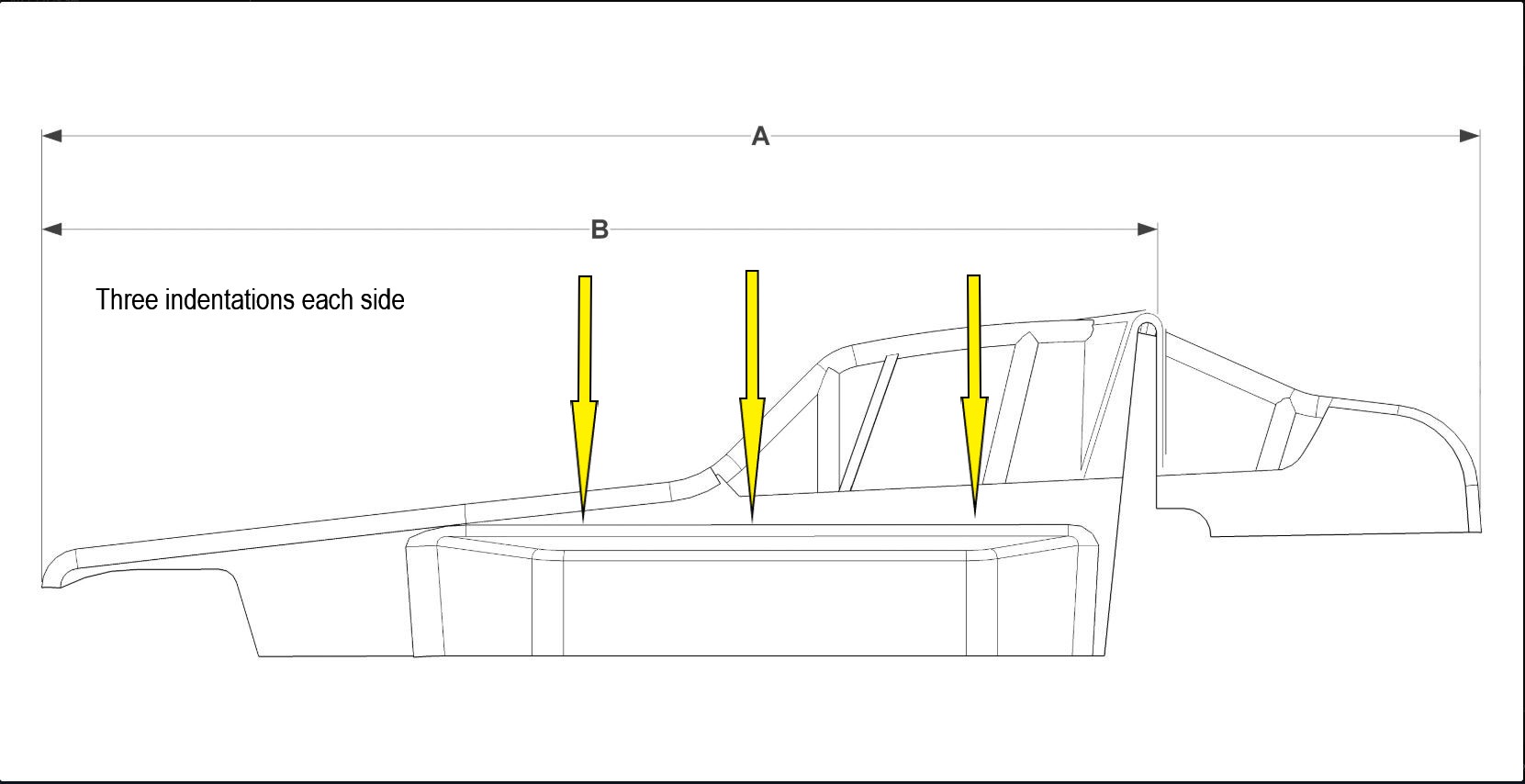

Re: Protech Bodies
Thanks Chuck. Just go ahead and edit the drawing, it's not copyrighted.
Hey, by the way, did you notice any dimples in the low spots on your Penguin Protech body shell?
Penguin's B2 and Protech II bodies are dimpled.
Otherwise, they seem fine.

Re: Protech Bodies
Yep Doug
I also have one at the bottom center of the front windshield.
Chuck
