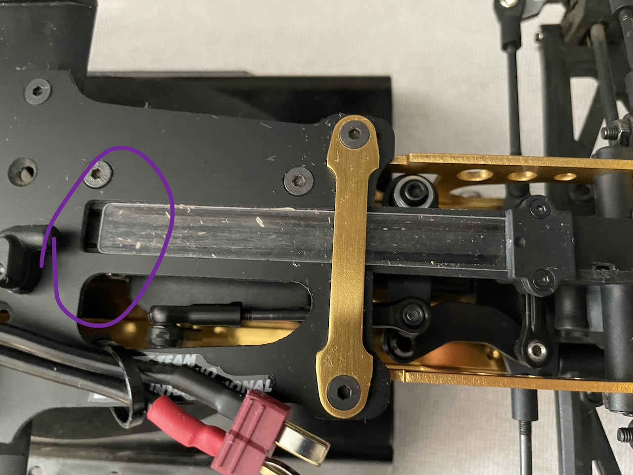

Re: Turbo Optima Re-Re Transmission
Post by sundevil67 »
I took it out for the first off-road mission, and everything was great ... (though still too slow)
Anyway, it looks like too much gunk got stuck in the belt drive area... Should there be that little opening? Any ideas for keeping more of the dirt out of there? I guess I'll just put a piece of tape over that, but it's not the only spot that collected the gook. I wish there was one of those outerwears-type shrouds for this car...

For my belt drive cars, I think it's important to do whatever I can to keep dirt out of the belt.
I'll use packing tape, silicone sealant or whatever is handy and seems like it will provide a positive seal then invest some time making sure that every hole is covered.
Also, since the belt runs adjacent to gears in the rear gearbox, it can function like a conveyor belt and pull dirt into the gears. This makes it even more important to seal everything as best I can.
That gap shown in your photo looks odd. I don't recall seeing that in any of my optimas.

sundevil67 wrote: Wed Mar 03, 2021 8:56 pm I took it out for the first off-road mission, and everything was great ... (though still too slow)
That space shouldn't be there...on the underside of that little square plastic cover hold-down on the right side, there's a bar that protrudes from the flat part, and it's offset, it's not symmetrical. It's all too easy to install it reversed. :P If that bar is oriented correctly, when bolted down, it should prevent the clear chain/belt guide cover from sliding forward and making that space appear. Remove the 2 screws holding that hold-down piece, look at the bottom surface and make sure it's positioned correctly.
I went a step further with my Optima resto-mods, using some spare flat Lexan to add additional dust covers:
https://www.rc10talk.com/viewtopic.php?f=30&t=17726&start=67

Oooh that's fancy.. I have some spare lexan, maybe I'll give that a try. Thanks for the heads up. I guess it needs to come apart again :shock:

sundevil67 wrote: Fri Mar 05, 2021 3:49 pm Oooh that's fancy.. I have some spare lexan, maybe I'll give that a try. Thanks for the heads up. I guess it needs to come apart again :shock:
Nah, just 4 top deck bolts and loosen the chain protector cap at the front, slide the flat Lexan into place, mark drill holes, drill and install. 15 minute job, if that. :) The piece in the back might not be easy to get to if you've already installed electronics, but that's only held on with 2 screws. Another example:
