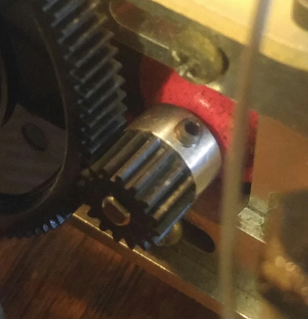

Got the Kimbrough gears installed today. The pinion is lighter id say by a couple of grams, cant find my scale so I cant verify that but it is lighter than the pinion that was on there. Im going to need the motor spacer as the pinion needs to be more inline with the spur and is all the way down on the motor shaft. Its not hitting the spur but its close. Im missing a couple of balls
for the diff and have them and the motor spacer coming.

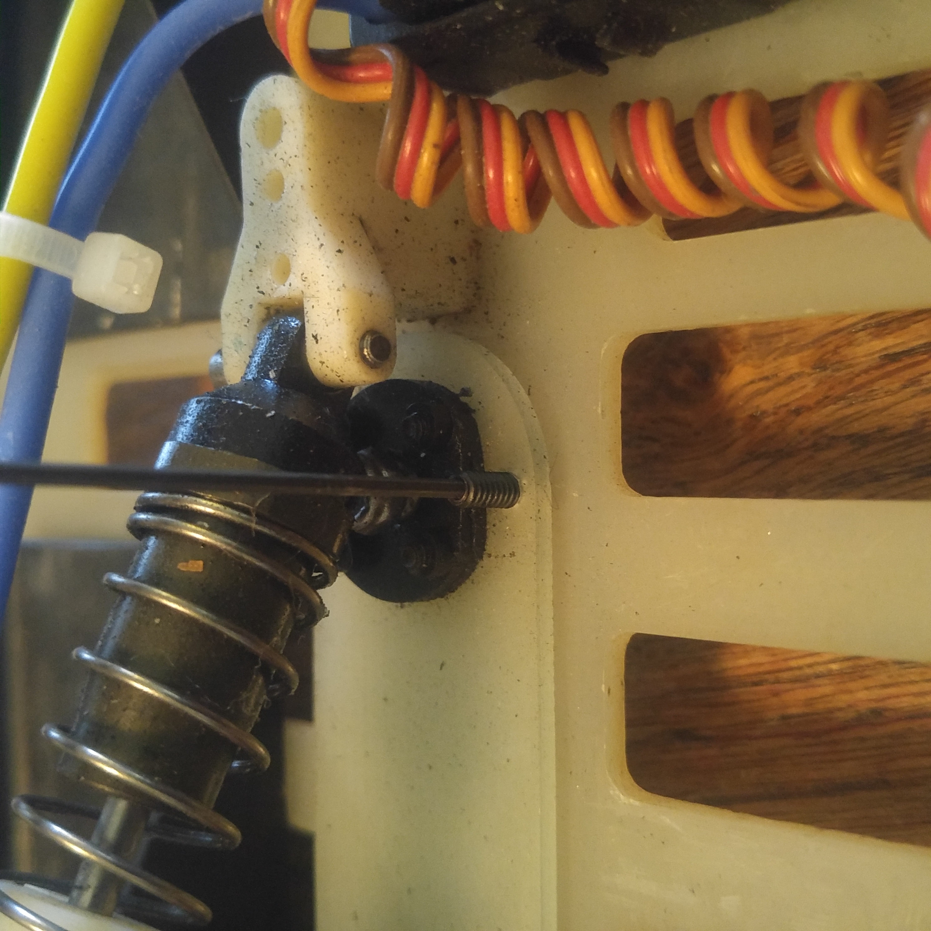

I needed to set tweak and got some 4/40 screws but they will not thread in very far to the T plate What should I do, run a tap? Any other ideas on the tweakk screws?

You can use some cap head screws to pre tap the tweak screw holes. Just don’t go too crazy as you want them to be snug in there.

Did that several times and no luck. Took them to the wire wheel on the bench grinder and they go in smoothly now. Whatever coating that was on them was locking them up.
