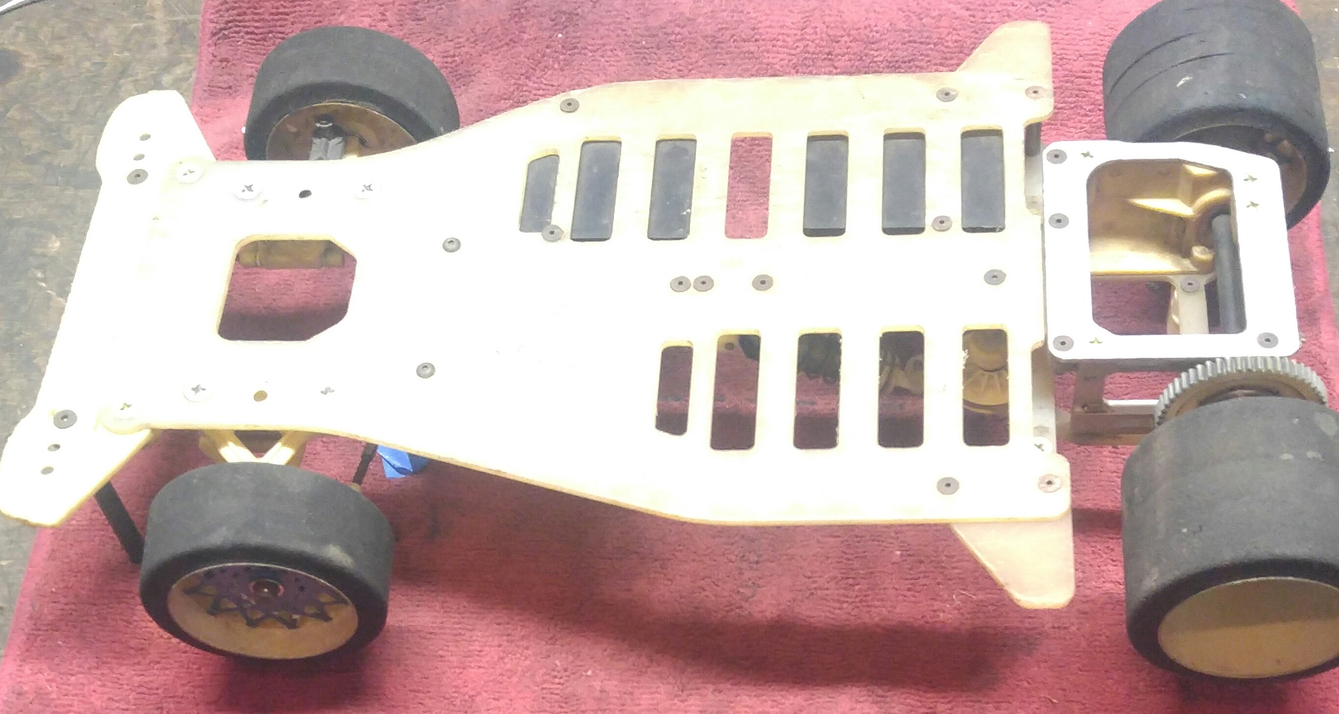

Hi, need some help with this pan car. I have always wanted one and pulled the trigger on this one. I think it is an Accoiated RC10LSS. Anybody know for sure? Its complete and in decent running shape but needs a refresh. I am going to have to replace the rear axle which broke when i dissassembled it, it was graphite too which really bummed me out it broke. It looks like previous owner did not file a flat spot for the grub screw and the axle siezed in the hub. I have an alloy one on the way. Anything you guys can tell me about this car is much appreciated. I intend to run it and maybe drag race it although there is no racing action near me that I know of so just me and the kids fooling around. If its an AE ill use this thread for my build up if not ill move it where it belongs. Thanks, Chris.

It's definitely from AE, although I'm not certain exactly which model. There are experts here who can identify it.
It's unfortunate about your graphite axle, any chance it could be repaired? I recall CA gluing mine a time or two but that was decades ago and I don't recall which end broke.
Welcome aboard, by the way.

Looks like a RC10LSO. Looks to be in better shape than the one I bought a few years ago. My axle was seized in the hub and a real challenge to remove.

Definitely fiberglass LSO. I don't think AE has an exact exploded view of the LSO, but the generic 10L view should get you most of the way.

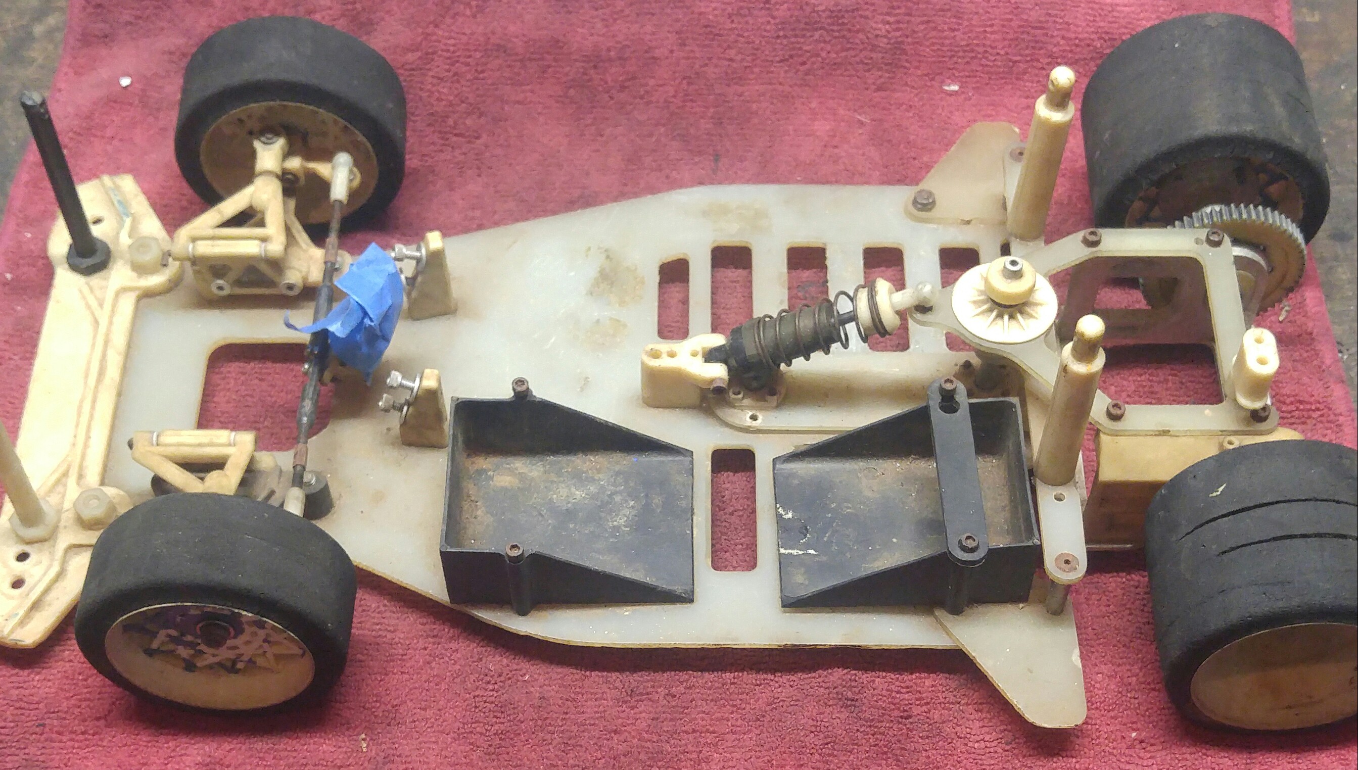

Yes that helps a lot just wished it showed the front suspension that is on mine. It has upper arms and springs underneath. Im going to dissassemble the front section tomorrow for inspection and cleaning. Sorry for the noob discriptions, this is my first pan car and im learning as I go.

This link for the 10LS instructions will cover the front end for you

I started assembly yesterday on my pan car and need a little help. My left rear bulkhead is not the greatest and id like to reolace it however, I cant seem to find one. Are they not for sale any more and will one from another model work like Bolink perhaps? Also my motor did not have a spacer on it, do I need the spacer? The gear mesh looks great and nothing seems to be out of allignment.

Ebay should have a few pod sides last time I checked, on the spacer question not sure bud..............Overvolted wrote: ↑Fri Apr 16, 2021 1:21 pm I started assembly yesterday on my pan car and need a little help. My left rear bulkhead is not the greatest and id like to reolace it however, I cant seem to find one. Are they not for sale any more and will one from another model work like Bolink perhaps? Also my motor did not have a spacer on it, do I need the spacer? The gear mesh looks great and nothing seems to be out of allignment.
