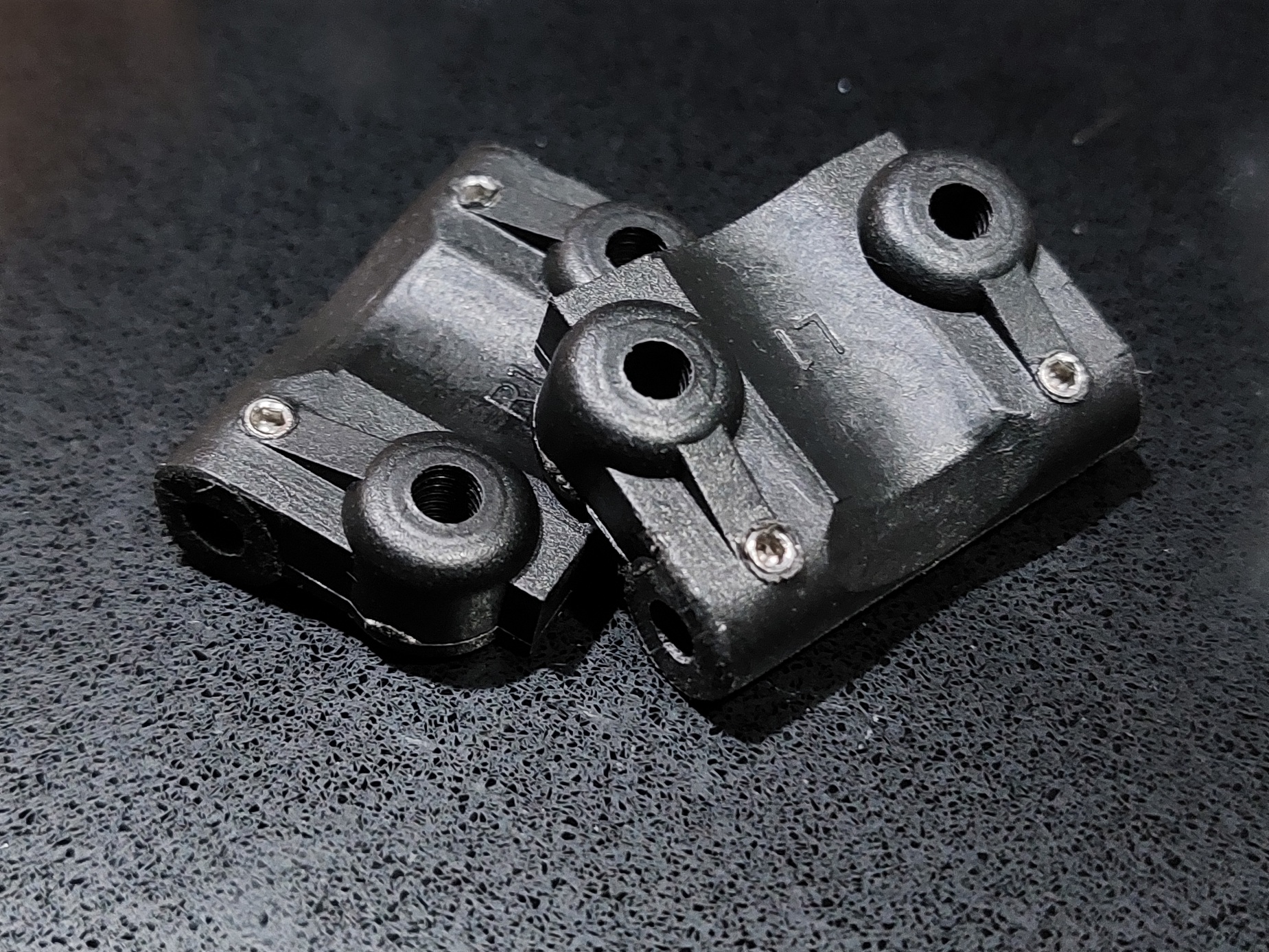

Here's a little mod that I did to overcome the sloppy hinge pin holes in the +/- 1 degree mounts to give myself some tuning options. Very simple but it works.
Nearly finished the truck tonight, just gotta decal it up and it's pretty much done :D

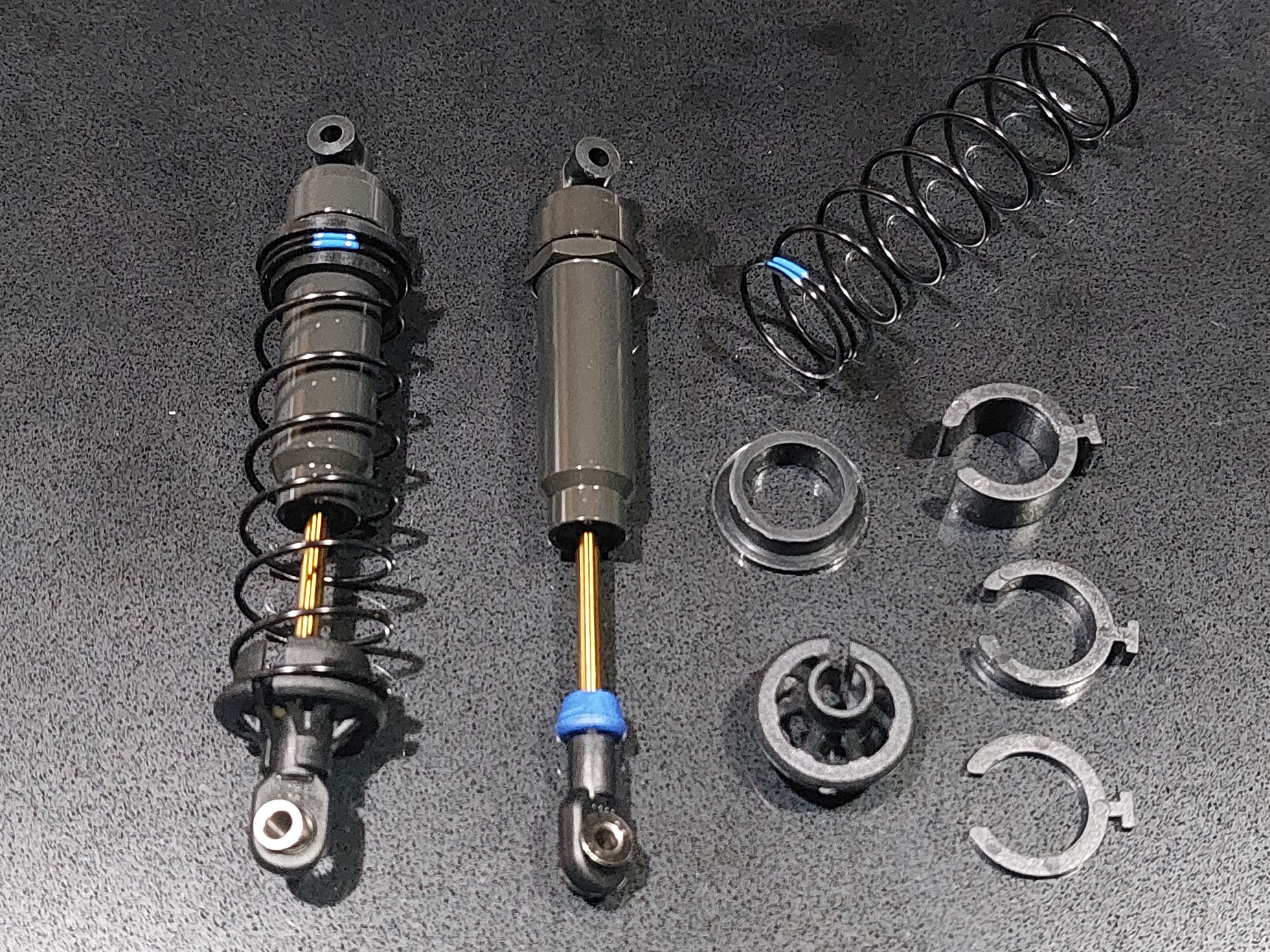

And many many more thanks again to Chris (1300GT) for making me some spring collars to adapt the AE springs to the Traxxas shocks. I originally tried to find Losi springs but they aren't the easiest to find anymore. Thanks Chris !
Shocks installed on the truck..... The Traxxas shocks are actually pretty good and super smooth. I think the T6 rear springs are quite a bit softer than conventional springs so I ended up using a harder spring then I was expecting, but overall it feels good. The truck feels SUPER plush and I'm hoping is a traction magnet. The chassis sits really nice and feels and looks just right.

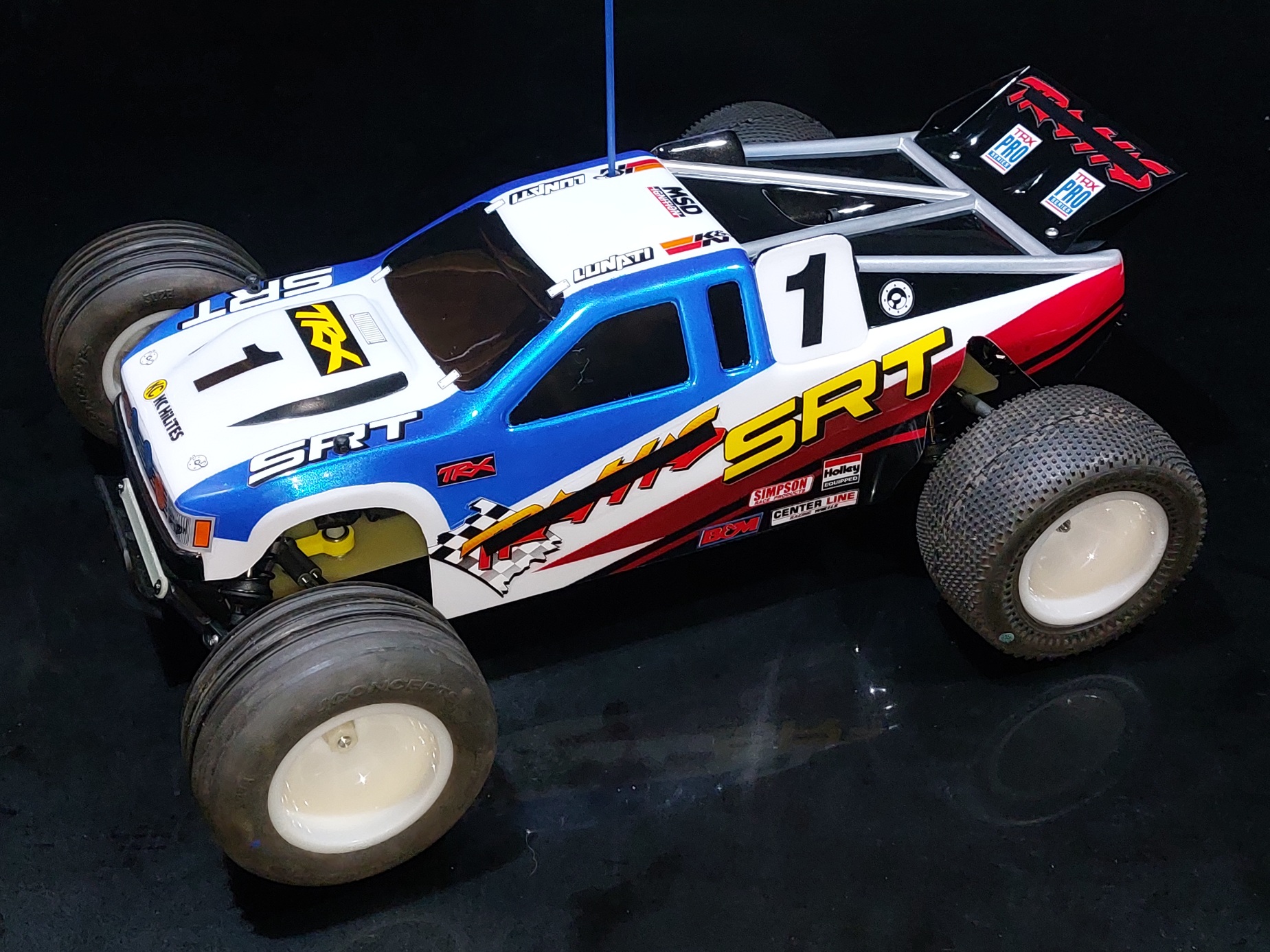

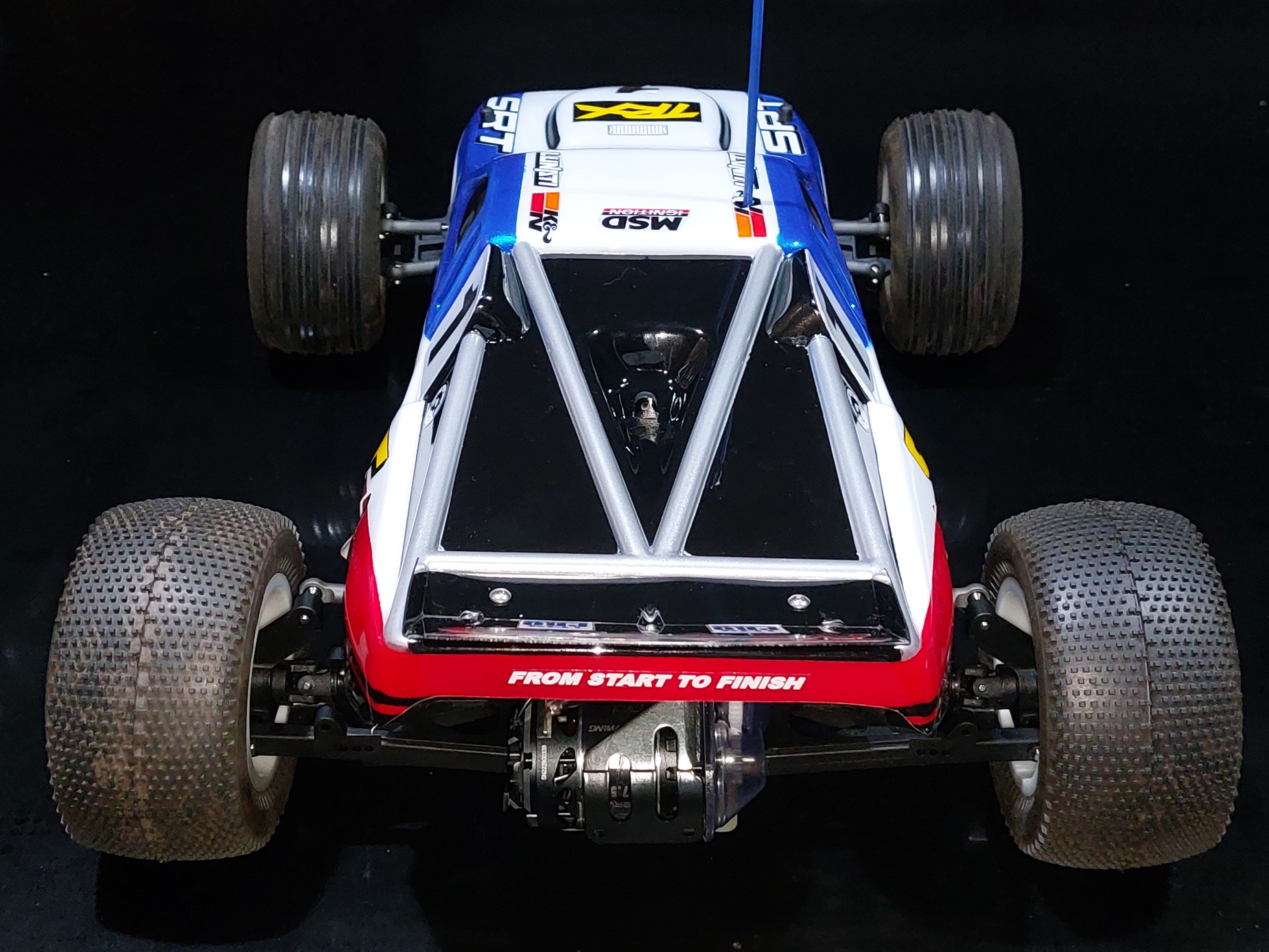

Truck is done !!
I still need to glue the tires and set camber etc but it's done. Overall I think it turned out pretty good, it's as close to box art as I can get it.

That's come up a treat, RJ.... you should be well pleased with the result.
Will be a shame when I crash into it on the weekend.... so try and avoid my mobile chicanery ;)

Looks fantastic, took a while staring at the pics to notice the cross outs :lol: too funny
Hey Cru ! Go balls out 8)

MarkyDents wrote: Wed Nov 01, 2023 12:54 am Looks fantastic, took a while staring at the pics to notice the cross outs :lol: too funny
:lol: I was wondering if someone would notice, that's my subtle protest
