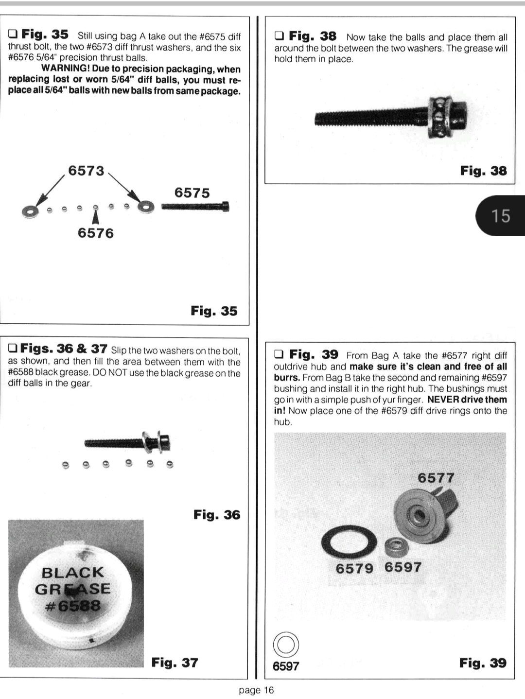

This diff gear feels really gritty, like the grease that would've been in there is long gone.
I found the diff lube from my GT kit, but it's nearly empty.
What's everyone using these days to lube the diff?
Thanks!

You can still buy the Stealth diff lube but any ball diff lube works. Most of mine use the inexpensive Arrowmax grease, which seems fine.

Many times the crunchiness is from the 6 little ball bearings in the side of the outdrive.

juicedcoupe wrote: Tue Nov 14, 2023 3:39 pm You can still buy the Stealth diff lube but any ball diff lube works. Most of mine use the inexpensive Arrowmax grease, which seems fine.
They do still sell it, that's incredible! Thanks @juicedcoupe
https://www.amazon.com/Team-Associated-6591-Stealth-Differential/dp/B0006N6U28
Frankentruck wrote: Tue Nov 14, 2023 4:09 pm Many times the crunchiness is from the 6 little ball bearings in the side of the outdrive.
That's exactly what it feels like, crunchy, I was wondering if maybe I'd put flat spots on those diff balls, the way it feels. It was run on road for most of its life, wasn't sure if that might have done it.
I noticed now that Associated makes the Stealth lube, and the black grease, just bought both.
Glad to hear the crunchiness doesn't necessarily mean I burned it up. Thanks for the reply @Frankentruck
