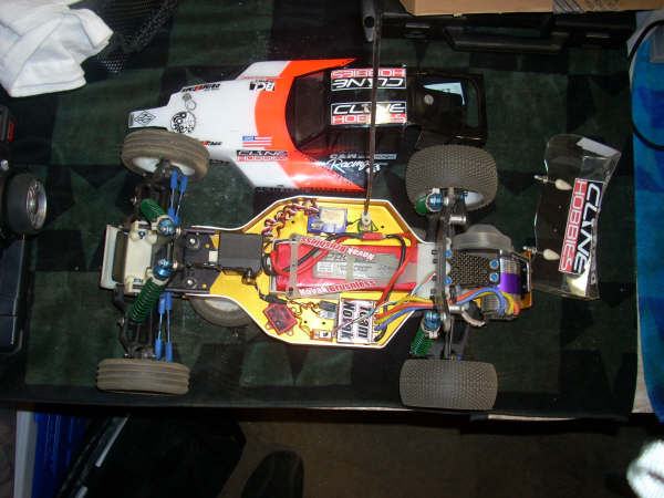

Sorry I dont have a digital camera but here is the scoop on the car. RC10 team car with most of Mark Westerfields set up on it with the exception of rpm arms on the back and jconcepts rear cvds with b4 stub axles and b4 hub carriers. These allow the use of b4 wheels all around. As for the electronics I used an LRP comp speedo and a novak 17.5 motor. I would like to thank Mark and Travis for all their help over the weekend.
- clinehobbies
- Posts: 410
- Joined: Wed Nov 28, 2007 1:28 am
- Location: Chandler,Arizona,USA
Re: V-Nats Tech Thread....... show your stuff, rc10 or not
CAR: Associated RC10 A chassis Cut down sides and Modified for RPM team car rear arms
RADIO: Airtronics M11
RECEIVER: Airtronics Micro 2 ch
SERVO: Futaba Brushless BLS 451
ESC: Novak GTB with heat sink and fan removed due to chassis height
MOTOR: Novak 17.5
BATTERIES: Lipo 4000
TRANS: Stealth With mip out drives and B2 universals
GEARS: 81 spur with 26 pinion
SHOCKS: Associated hard anodized truck shocks with spaces and limters
SPRINGS: Associated green front and rear
TIRES: Jconcepts double D rear and Jconcepts rounders fronts
WHEELS: Associated front and duratrax rears
BODY: original protech slamed
MODS: Chassis cut down , RPM team car rear and kit, Rpm worlds front end kit with long shocks and truck shock tower, 10t rear shock tower
Full ball bearings, tecnacraft wing mounts.
THANKS: Clinehobbies, C&W manufacturing, BC1 Graphics, Novak and all the guys that helped me set it up over the course of the weekend!
MOTOR: Novak 17.5

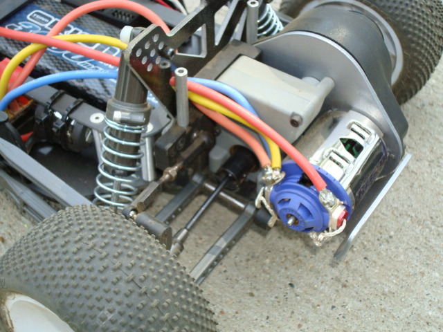

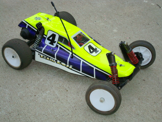

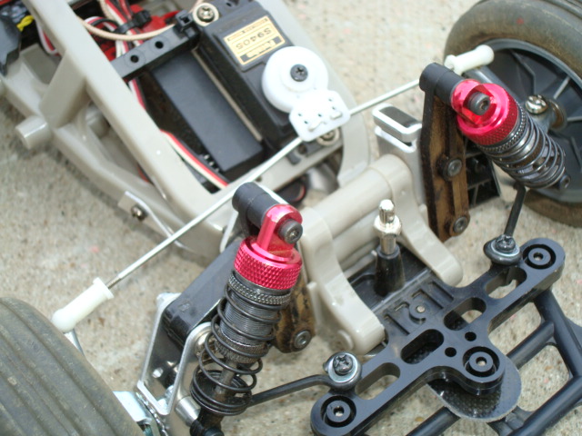

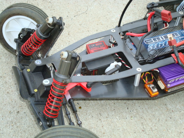

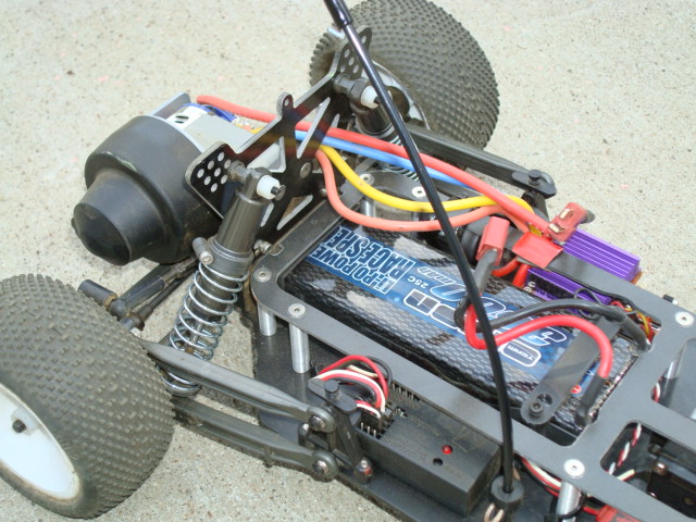

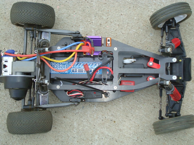

Team Losi JRX Pro:
Jrx Pro chassis with the Composite Craft upper deck
5 Link rear suspension
Hard Body shocks, .9" stroke in front, red pistons 25 wt Losi oil. 1.2" in rear, red pistons, 30 wt losi oil, .20" limiters under piston. Silver rear springs, red front springs.
2.19:1 retrofit transmission. 88T spur, 17T pinion slipper equipped.
Losi dogbones
Duratrax evader front and rear wheels
Losi pre scrubbed reds front, J concepts Double D's rear.
Nomadio React radio, Novak GTB ESC running a Reedy Stockstar brushed motor. Orion 3600 race Lipo. Futaba 9550 servo.
All plastic is stock with exception of the front JG mini bumper and an RPM front bulkhead.
Original JRX Pro body with Losi v wing.
Losi steel turnbuckles
Losi BB supported steering rack
Losi dogbones

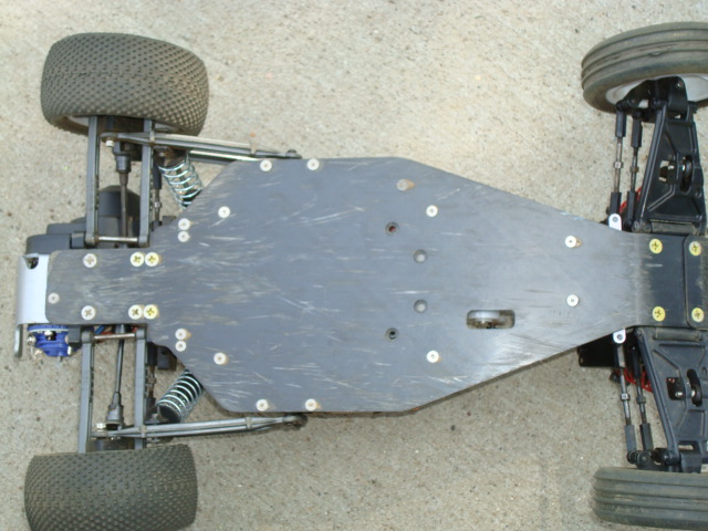

How are you holding the battery in?bngiles wrote:Team Losi JRX Pro:
It looks like an AE battery cup, but there are no corresponding screws on the picture of the chassis bottom.

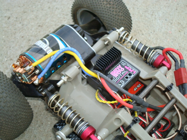

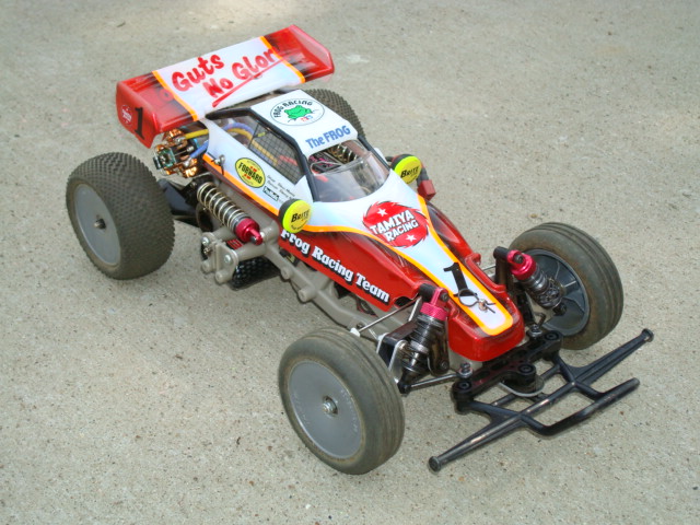

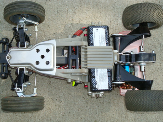

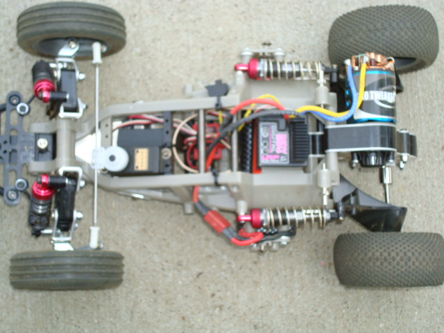

Tamiya Frog Re-release:
Stock Frog with these exceptions:
Yeah Racing shocks
CRP front shock towers and hardware
Trinity Cobalt 27T racing motor
Tamiya rear hex adapter with new Tamiya 2.2" wheels
LRP Indy 200 ESC, Nomadio radio, Futaba s9405 servo, Orion Carbon 3200 Race Lipo
Front shocks 50mm length, Associated black springs, 3 hole pistons, 20 wt Losi oil
Rear shocks 80 mm length, Yeah soft springs, 3 hole pistons, 30wt losi oil, .25" limiters under piston
Losi pre-scrubbed red front tires, J Concepts Double d's rear in soft compound.
Gear ratio was the middle setting offered in kit.
I had some issues at first with the dogbones popping out due to the longer rear shocks, but after putting the limiters in I had zero trouble out of this car the rest of the weekend. No breakage. Plenty fast, lots of steering, LOTS of fun! Anybody looking for a reasonaby priced entry into the classic class next year need to give the re-re's a thought.
Yeah Racing shocks

Correct, AE battery cup, held down with 3M's outdoor double sided tape. Found at Walmart's anywhere in the paint department. It's the best "servo" tape I have found, and it's cheap. Grey in color with the red peel off backing. The stock Losi battery holddowns were not allowing the use of the new lipos, so I figured I'd give this a try before drilling more holes in the bottom....aconsola wrote:How are you holding the battery in?bngiles wrote:Team Losi JRX Pro:

Brandon should also be commended on the paint work on that re-re Frog. It looks great! Nicely done.
