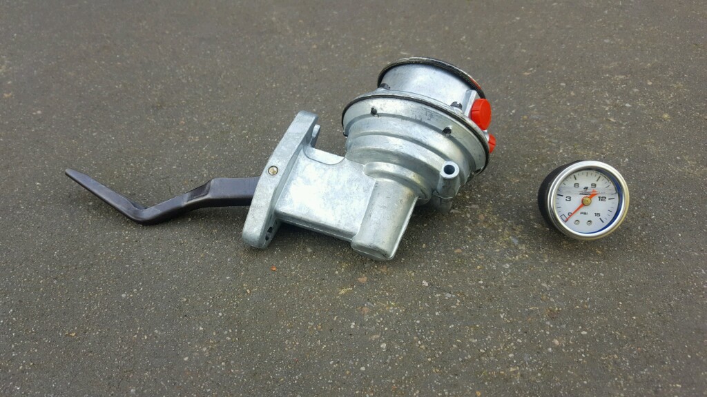

Not really an update or even worth posting for that matter but it's the first time I've bought anything car related since being poor.
I bought a 100gph pump to replace the factory style pump which is only rated at about 23gph from what I've read. I also bought a nice liquid fuel pressure gauge with built in pressure relief valve. It seems finding a good reliable under hood fuel pressure gauge is a lot harder than you think. This one is made by Autometer so it should be good, and the pressure relief should make it accurate regardless of temperature.

FYI, I havent had good luck with liquid filled pressure gauges in the engine compartment. At least in my experience, they are very sensitive to temperature and the reading can change a lot as a result. I chased my tail on fuel pressure drifting for a long time before someone else told me about that issus. Once I swapped in a non liquid filled filled gaige all my fule pressure "problems" went away.

That is what I read about liquid filled gauges, every 30 degrees or so will change the reading about 1 PSI, so the hotter the gauge gets the lower the pressure reads. Thats why I'm keen to try this gauge because one, I've got nothing, and two the pressure relief valve lets you equalize the internal gauge pressure to atmosphere so you get an accurate reading no matter how hot or cold it is.
A little annoying having to pull open the valve every time you want an accurate reading but I think the accuracy is worth it. Mechanical pumps are notorious for destroying dry gauges, if you get needle flutter on a dry gauge it's not going to last long.

realistically, if you aren't running an external fuel pressure regulator, the mechanical pump is going to put out what it needs, so other than an initial check, there really is no need for a guage there. I dislike putting extra fittings in fuel lines if it can be helped.

I agree except I have experienced some fueling problems and would like to keep an eye on pressure. The Holley fuel lines already have a pressure port so it's just a matter of removing the plug and threading in the gauge. I'm skeptical the old pump could keep up at 23gph. I also like the fact I can compare pump pressure between the stock pump and high volume pump, and I can check that the HV pump is 7.5lb.jwscab wrote: ↑Thu Jun 28, 2018 10:18 am realistically, if you aren't running an external fuel pressure regulator, the mechanical pump is going to put out what it needs, so other than an initial check, there really is no need for a guage there. I dislike putting extra fittings in fuel lines if it can be helped.
Once everything is dialed in it's easy to remove the gauge and reinstall the plug to tidy up.

Cool, sounds like you're on it.RC10th wrote: ↑Thu Jun 28, 2018 10:09 am That is what I read about liquid filled gauges, every 30 degrees or so will change the reading about 1 PSI, so the hotter the gauge gets the lower the pressure reads. Thats why I'm keen to try this gauge because one, I've got nothing, and two the pressure relief valve lets you equalize the internal gauge pressure to atmosphere so you get an accurate reading no matter how hot or cold it is.
I'm running an electric fuel pump (Holy Red) so I don't really have any flutter in the gauge. It's been working well for ~10 years now.

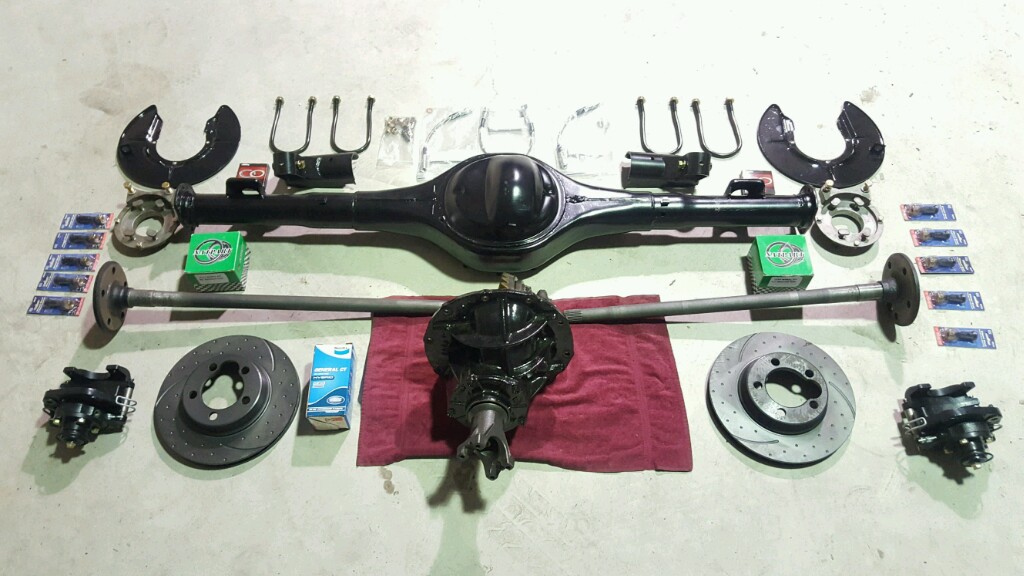

Well, it has only been about 2 years but something is better than nothing I guess.....
It's pretty much ready to be assembled now, I wanted a detroit locker or true track and 31 spline axles but that would have added another 2k to the price. The Ford LSD is still good and for the street this will be plenty beefy. Hopefully it will also take about 7/10's off quarter going from 2.9's to 3.5's

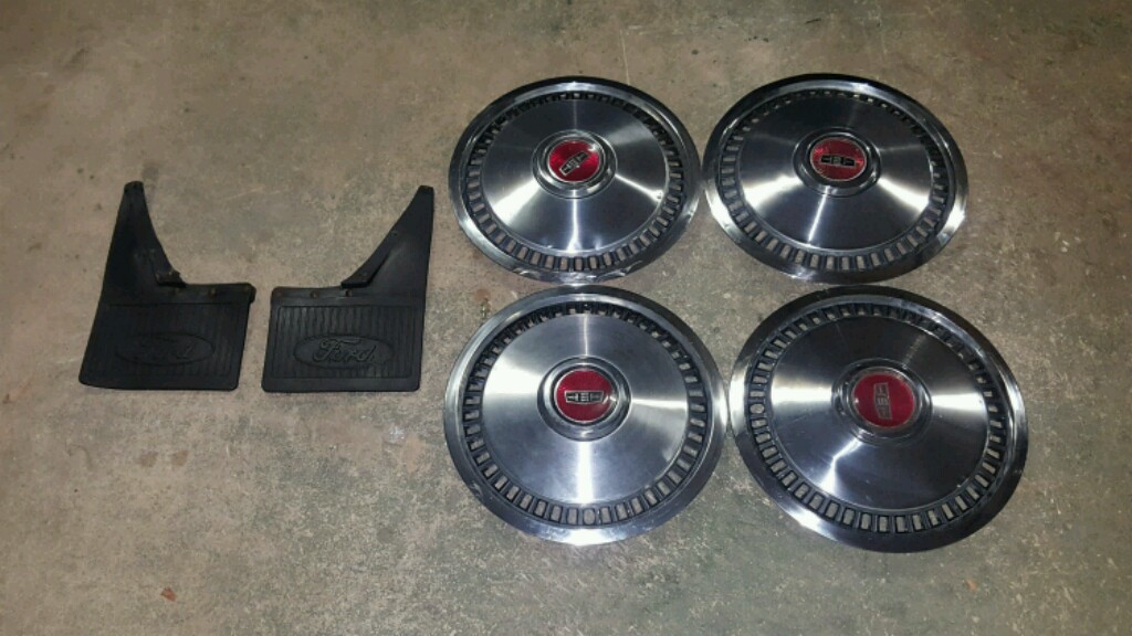

Not much to report except I finally got my grandpa starter kit.
I luckily happened to find a half reasonable set of hub caps cheap. They need a little bit of work but are in pretty good condition over all. The mud flaps on the other hand are quite hard to find or way too expensive when you do find them, so I just cleaned up what I had as best I could. Still need to find a front pair.....
