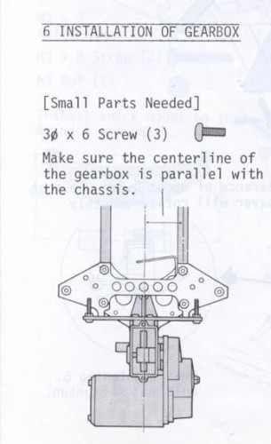

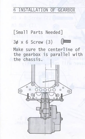

I had the same binding issues in the dogbone, it was hideous. I loosened all the pivots, and re tightened while holding the arms at maximum toe in, then loosened and re tightened the trans. It's perfect now, no binding at allRaman wrote:Having an issue with the rear suspension arms binding. Compared to my original and it seems to me that the dog bones are a little too long.
Manual has a warning showing the dog bone should be more towards axle. Tried that, no success.
Only solution seems to be to reduce the angle the arms mounts.
Any suggestions?

probably wont make a difference. all you have to do is loosen and retighten- no more binding. When the trans is first put in place it isnt centered, if you look at the original manual it even shows that you have to check the centerline.
