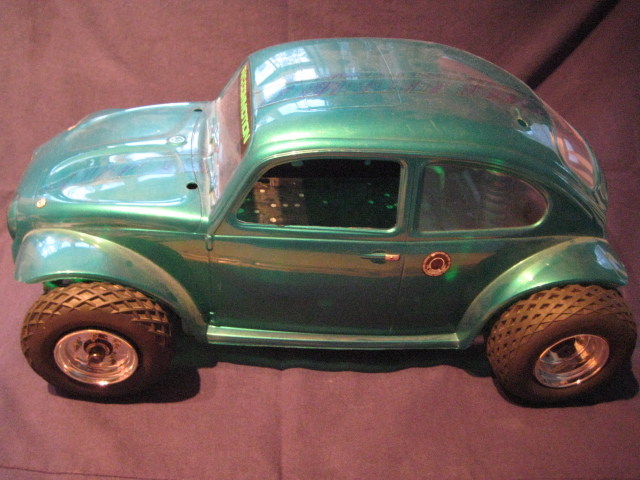

Re: I have an idea...

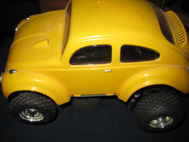

Still holding out for a salvagable Cox Dune buggy body.
The front track width is perfect.
The rear track width just doesn't cut it on the bug, even with the disco era fender flares... Bummer, 'cause it would be a lot easier to hide everything under the Bug body...but, it does have kind of a 70's cartoon look.
I think the buggy has a more scale appearance, and the open body would allow a little more tolerance in the wheelbase/track department..
I'll do the final wheelbase adjustment when I see how one fits. I'm expecting a lot of trimming for transmission clearance on the buggy body.

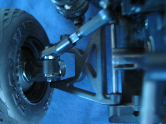

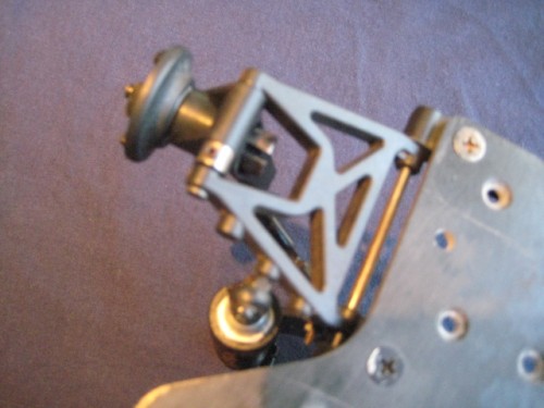

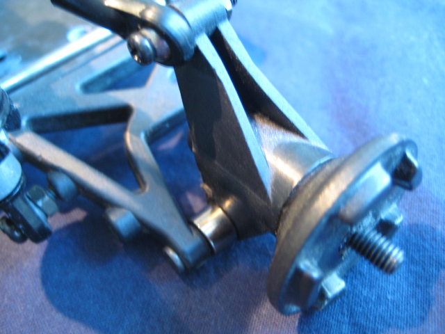

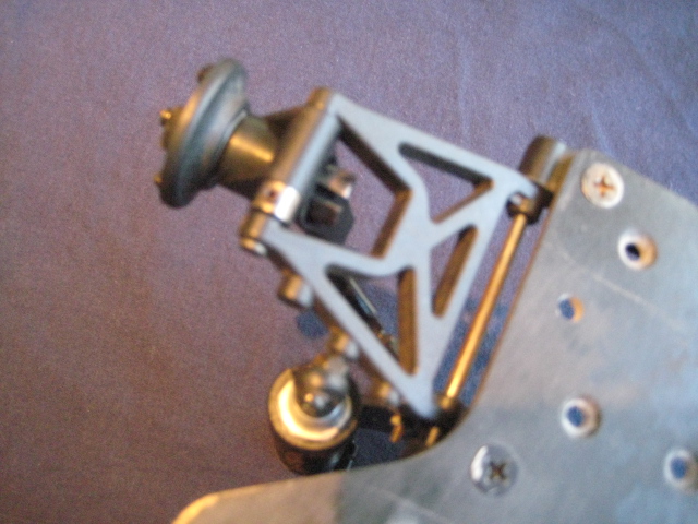

Rear suspension tweaks:
Solved the rear hub hinge pin problem. Now pins are captured, (no E-clips) axles line straight up with trans outdrives.

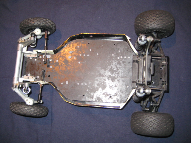

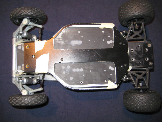

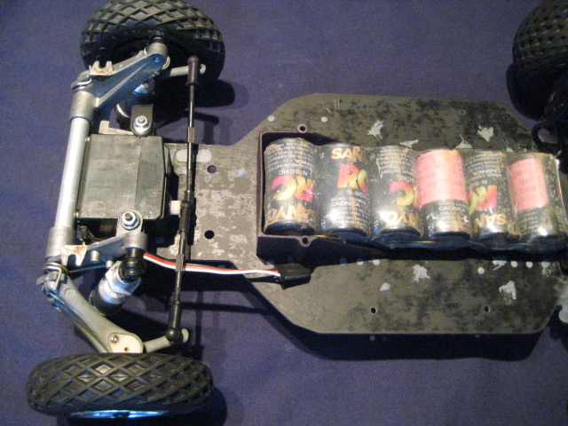

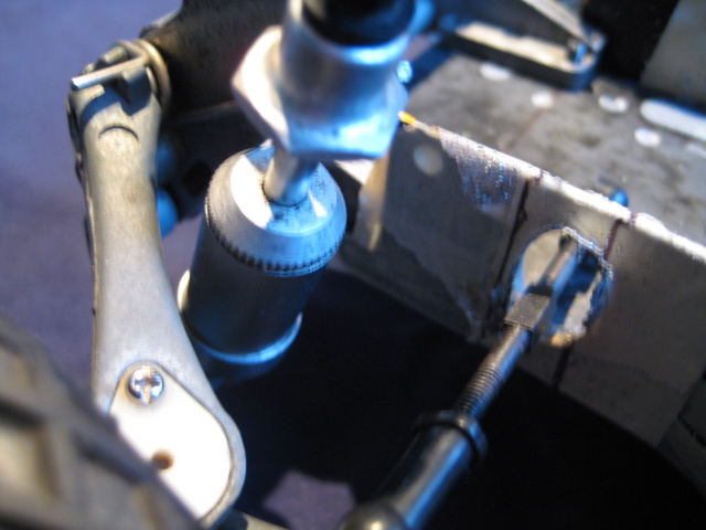

Ok, I really tried to get away from the Baja thing..no luck with finding an affordable Cox Dune Buggy body.
Looks like this project is evolving into something other than I originally intended.
Fortunately, there was just enough of the old Ultima chassis left to stretch the wheelbase. I still have to do a little more detail work on both chassis sections.
..Mocking up the pan for tie rod clearance, I will be setting up a direct-to-servo saver steering to save space. I'm not worried too much about bump steer on this one anyway. I still may trim the sides more.
I think I may have enough room to set up the battery lengthwise with the help of a left over RC10 battery tray.

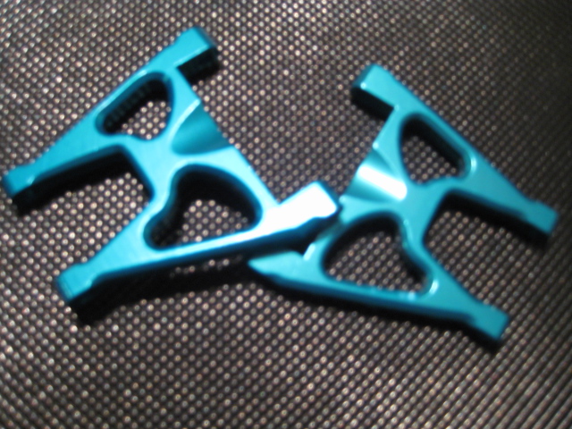

New parts arrived today...
Now original DS rear arms can go back to spare parts stash for future DS runner project.
Arms will lose the funny looking blue shade soon courtesy of Easy Off & Mother's Mag & Aluminum polish...
Project: Sand Blaster continues...
Now to place the order for the Tamiya touring car dog bones from Tower...
