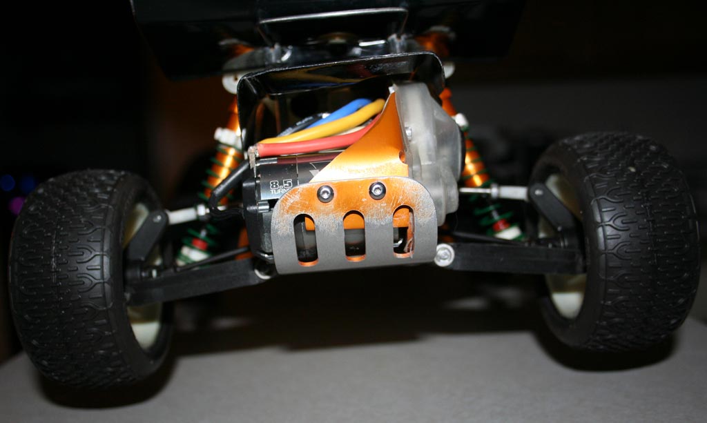

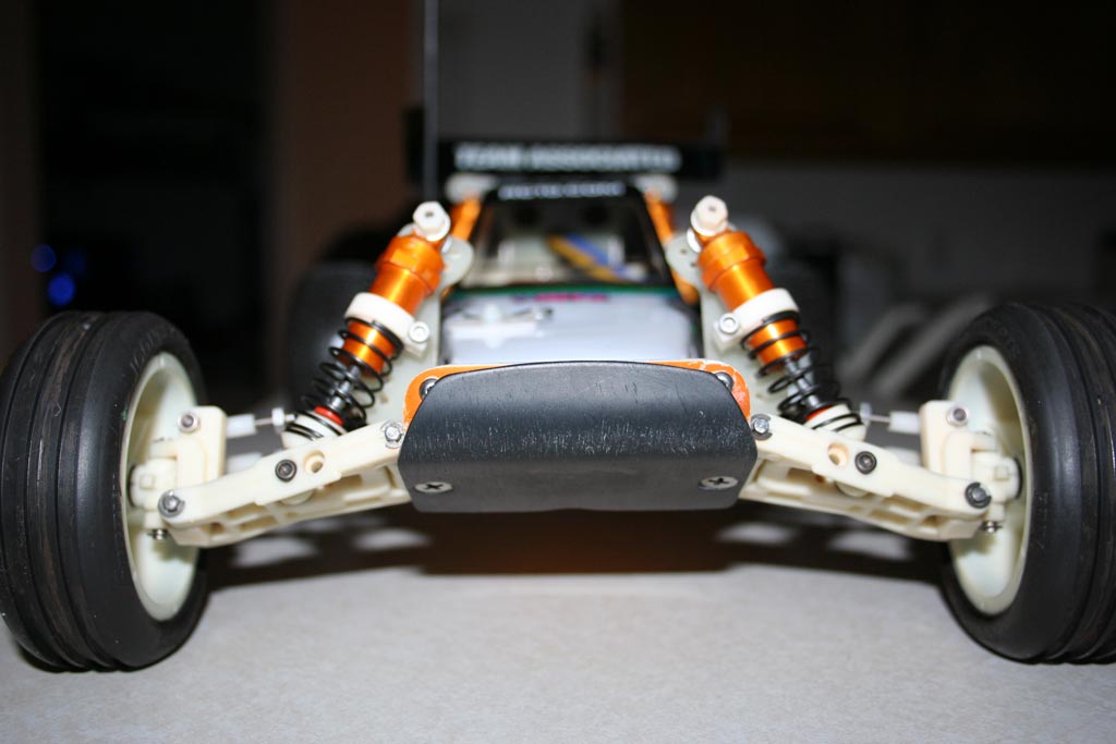

I found the left side couldn't travel the last, almost, 1/4" so I caved and shaved the rear hubs so the axles sit almost an 1/8" farther out than they did. Now the shocks can compress all the way. Also rebuilt the shocks according to Ruffy's setup for the track http://www.thercasylum.com/pdf/Ruffys_RC10_Settings.pdf and found out I'm pretty sure the rear shocks have the longer shaft in them (hehe) (also see the pics).
Got the servo and battery mounted. The standoffs are from the local supply store at 15cents a pop.
Normal ride height.
Uncompressed....
Normal ride height.
Uncompressed....

I just took these pictures real quick in the hopes that they might help you see how many limiters internally my shocks have and the droop the arms have with stock RC10 parts and the RC10T rear hubs. I'm using B2-B3 CVDs (3/16" axles) with B2-B3 wheels (just received my 1st order from tower of the Thunder Tiger wheels that are like the B3's).
Here you can see the front suspension with no weight on wheels (no shock compression) and the rear tires off the surface. In the front I also have one orange o-ring on the shaft above the shock spring collar and two on the rear shock shafts externally. These are merely to cushion the car during high altitude landings as they just make contact before the car bottoms out on the chassis.
I hope these help and look forward to seeing you out there once I return from my business trip.
