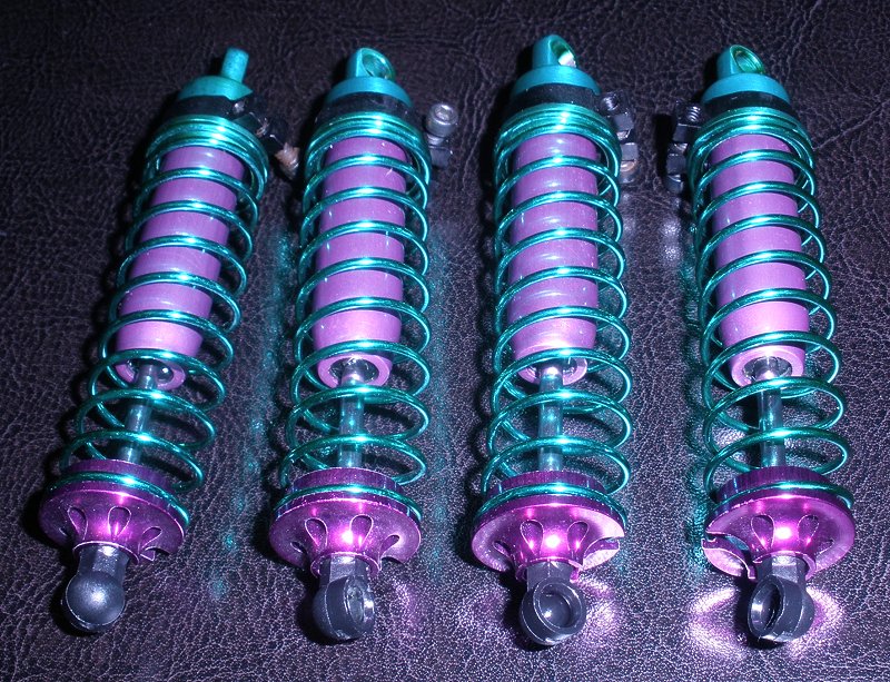

I've had so little spare time lately, but at least I put together the shocks. I can't do a whole lot more until my screw set arrives. :?

are those the shock washers up there anodized blue?
Looks good. 8)

jwscab wrote:are those the shock washers up there anodized blue?
Looks good. 8)
Green, actually...the same color as the shock caps & other green parts. They're working out great, thanks for making them, Joe! I'm actually going to need your help for some custom wheel washers--the narrow crawler wheels I chose for this build have an adapter for 5 or 6mm axle holes, but I'll need an adapter with a 4mm hole drilled through it...just a simple 1mm thick washer with a 4mm hole through the middle. I'll be in touch later. :)

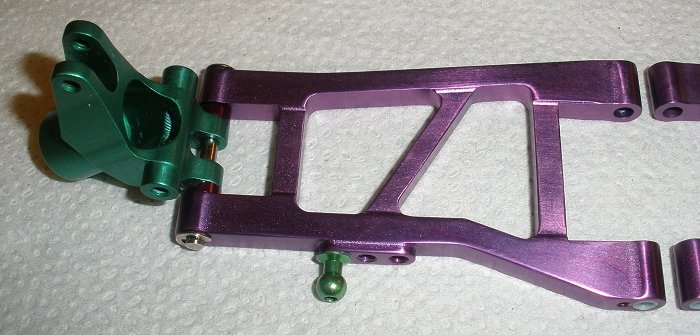

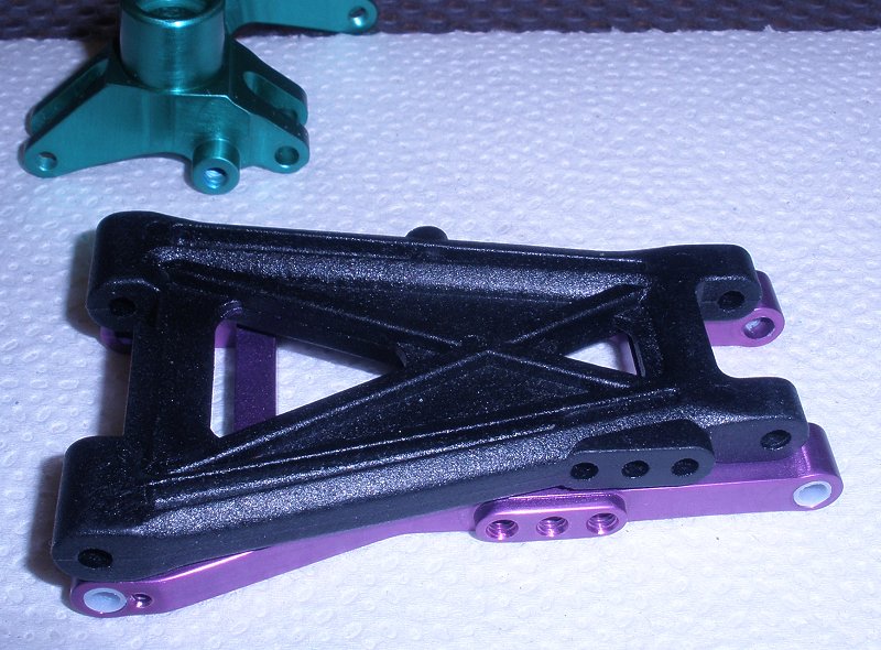

Put together the rear control arms, which began life as a $6 pair of cheap alloy GPM arms. They're about 5mm longer than the stock arms, hopefully a bit wider track and some wheels with a bit more offset should improve stability & cornering. The picture of the unassembled arm parts shows the actual colors...I'm not sure why some of the pics taken with the same cam kind of give everything a sepia-tone, slightly yellowing the green & pinking the purple... :?

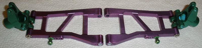

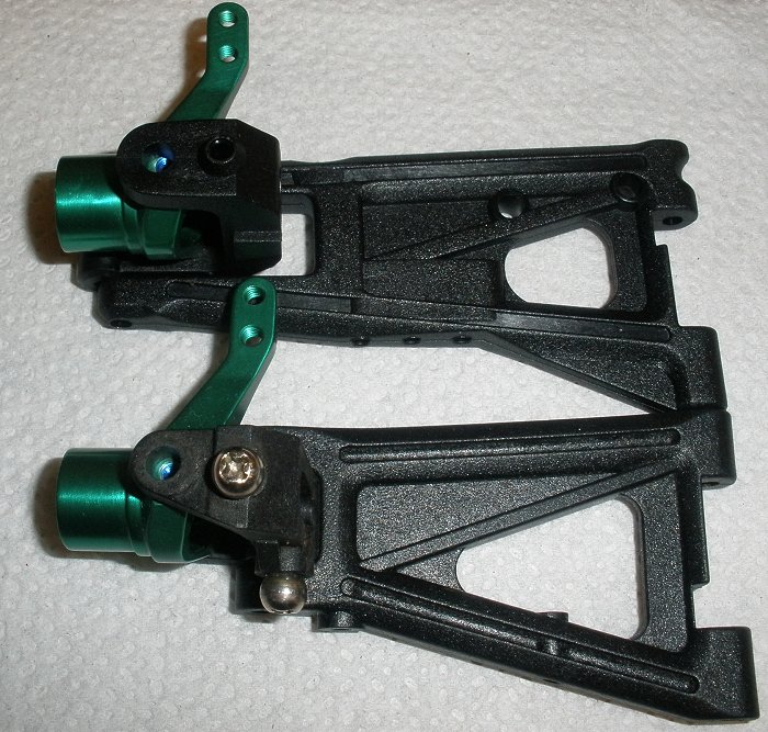

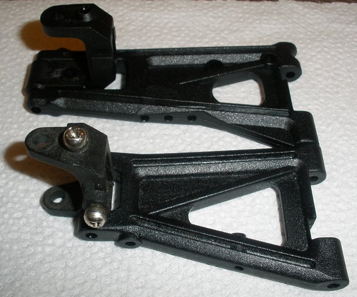

Here's a mock-up of the front arms...I'm awaiting an alloy part to upgrade the C-carriers. I found these cool aftermarket upgrade arms that are a full 20mm longer than the stock arms, pin-to-pin. However, the functional length--where the hubs/carriers are--is exactly the same. The aftermarket arms have a much deeper notch for the elongated C-carriers than the stock carriers. The aftermarket carriers have camber stops.
A technical question for the physics/racer gurus: what are the differences or advantages of going to arms that are 20mm longer but using elongated carriers and keeping the wheels in essentially the same position?
Mr. ED
Posts: 5483
Has thanked: 62 times
Been thanked: 62 times
Re: MMV Challenger: Turbo Optima build - Project Barney
Post by Mr. ED »
I like those front arms! Those longer arms will give you the same wheeltravel for less angle change of the arms.
They look very much like kyosho originals, bit like the maxxum front arms too.
Personally I'd go with old lazer front and rear arms though: to apply the same technical principle in the rear and get a consistent look. Just a suggestion.

These do look like the maxxum arms ( I have 6 sets if anyone wants them :)). Anyways, The longer arm (as previously stated) will give you the same travel, with a lower angle change in the arm. Or it will give you the same angle, with more travel -depending on setup. There is actually alot going on there. Originally it was designed to reduce tire scrub, but eventually it was realised that having the lower arm pivot reach past the upper pivot point made the front end less supple in rough corners, and made the car roll over more easily when bicycling or getting chassis high in corners. So, through trial and error it was realised that a car with ball pivots for both axis (think Pro Radiant or Schumacher CAT was a a better compromise. And better yet a car with the king pin axis slightly out front of the hinge pin axis (Losi XX4, Kyosho ZX5 FS, B44, etc.) made the car much more stable in the rough. So the idea is to have arms that are the "correct length" and as long as possible, instead of just plain long as possible. -Jeff

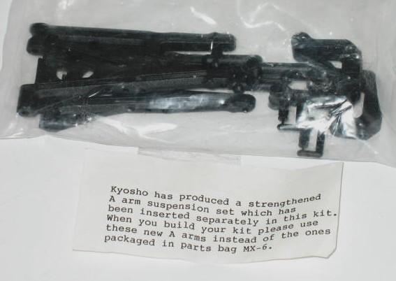

Jay Dub wrote:These do look like the maxxum arms ( I have 6 sets if anyone wants them :)).
Thanks for the info, guys. Here's a pic from the seller, referencing bag number MX-6, which would seem to indicate a Maxxum part. The seller wrote "Kyosho Optima Front A Arm Set Strengthened" so I assumed he knew what he was talking about--fortunately it makes a perfect swap!

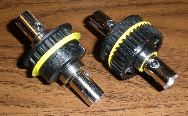

Got a couple new belt diffs built from a NIP SG-25 sprocket set, buttery-smooth with new Revolutions bearings & Duratrax chrome outdrives.
