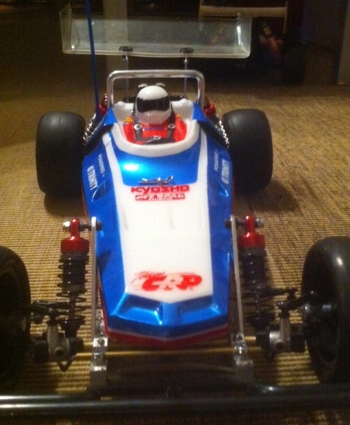

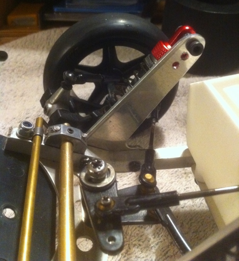

I double checked and they are CRP instead of JG as I said earlier. I have a NIP set of those for my scorpion build. The Guard I'm pretty sure is JG. It looks exactly like mine.
- Posts: 822
- Joined: Mon Aug 07, 2006 11:05 pm
- Location: Florida
Re: CRP/Turbo Scorpion Racer
thanks shodogshodog wrote:Those braces are made by JG and so is the rear Guard. I have a set of those for my scorpion build

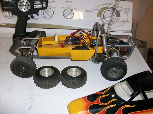

Hmmmm.... this is very interesting indeed. Prior to putting my Turbo Scorp into storage due to lack of spare parts in Australia I had straightened the chassis rails due to frontal imapct AND smashed up the plastic motor guard. I think I'll need to track down a pair of those chassis braces and a motor guard, or at least make some up so that I've got some 'protection' this time around.
I'm a bit new to this hop-up business though. It seems like most of the companies making these were based in the USA. I'm familiar with a few via this thread and other sources, but who were JG?
On a cool note, I just received a 'new in box' Le Mans 240SB for the resurrection of the Turbo Scorpion, and I've got together an excellent set of Option House gold shocks for it too. Now I need to make some longer front shock towers though....

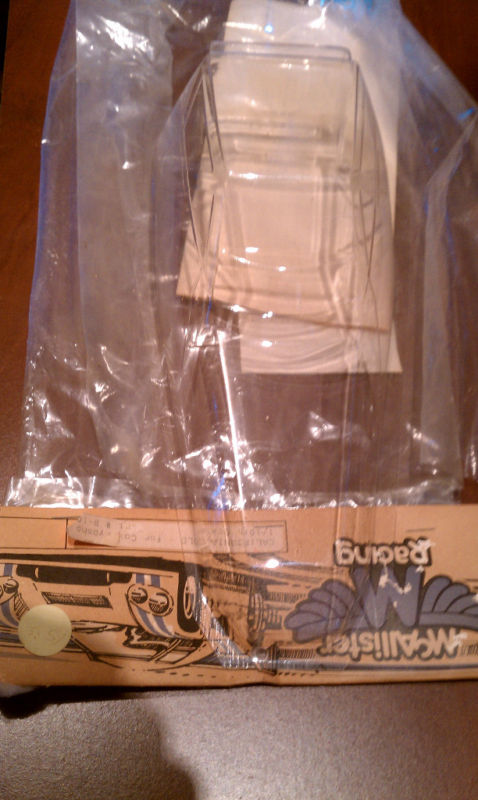

Help needed
I need some help, because I won this buggy but he only ships to US and not to Sweden! So I need a go-between helping me getting it to Sweden. If anyone is willing to help me place send me a PM

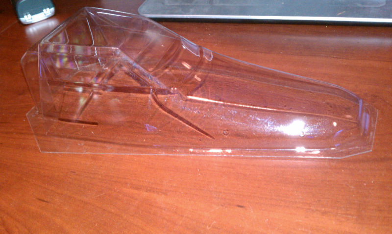

It looks to be a McAllistair body, and they are rare. So you can understand that I’m desperate for some help here!Mr. ED wrote:Which body is that actually?
