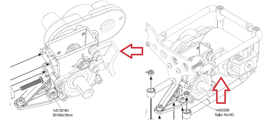

Okay, this is only the 3rd Kyosho I've owned ever and the 1st in nearly 30 years so this is somewhat new to me. Can any of you vintage Kyosho aficionados out there identify what this part is and what it does? There's a hook-like feature so perhaps there was a specialty motor cover for this car bitd and it was secured by this part? I'm curious; it doesn't appear to serve any purpose.

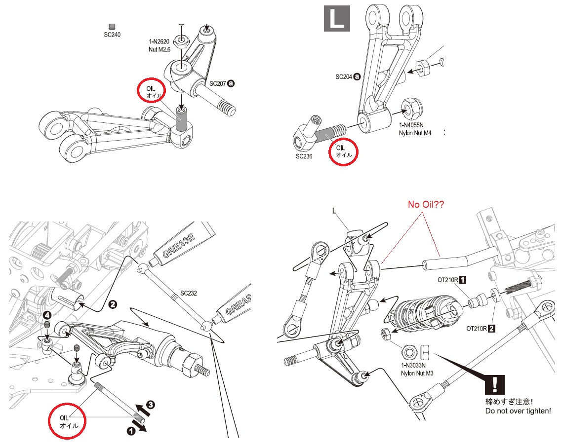

Also, throughout the instructions, they are very specific about where to apply lubricants but, for some reason, we're not directed to apply oil to the front arm pivots. Why should we not lub these pivots?

The motor brace was designed for a tie wrap to go around the motor
I don’t lube any suspension parts myself

I never put lubricants on suspension parts because it seems to attract dirt and which leads to binding, grinding, and premature wear on the parts at the pivot points. Kyosho Loved to use "zip ties" bitd for all kinds of things.

Tamiya has always recommended greasing their suspension plastics
I did as a kid... and once I started racing I figured out I had been wrong all these years.

Great info, thanks everyone! I have some of this Bel Ray lub that I use for my bike chains so I may give it a try here. Come to think of it, I may have used it once on my CVA's. It sprays-on wet and dries like paint. I guess I'm one of the old-timers who still thinks that metal-metal bearing surfaces must have some kind of lub or they will fail.

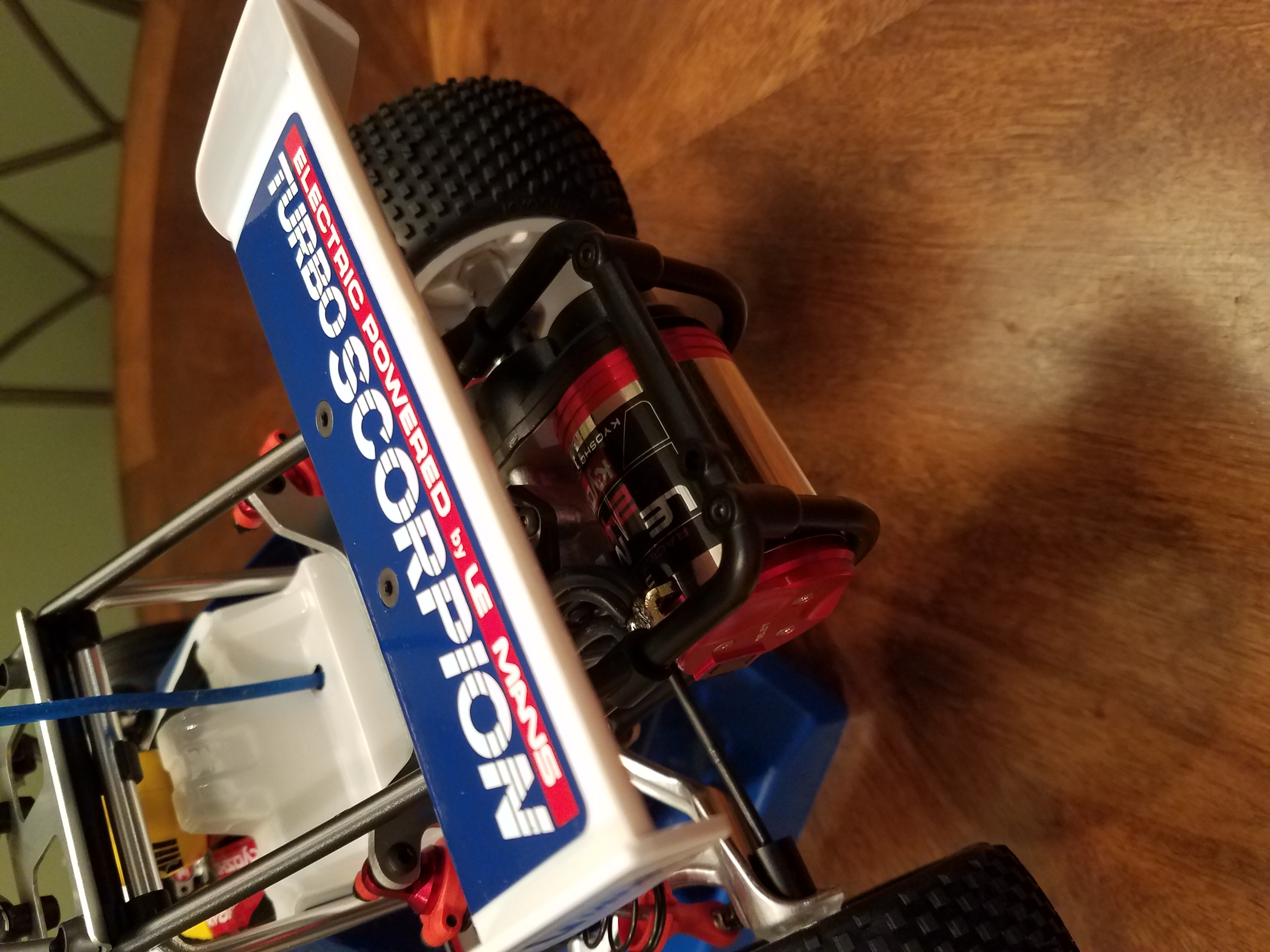

It has a "rear roll cage" but it doesn't provide much protection for the motor and it's very flexible. Kudos to Kyosho for thinking to add such a part which could make the car a bit more crash-worthy.

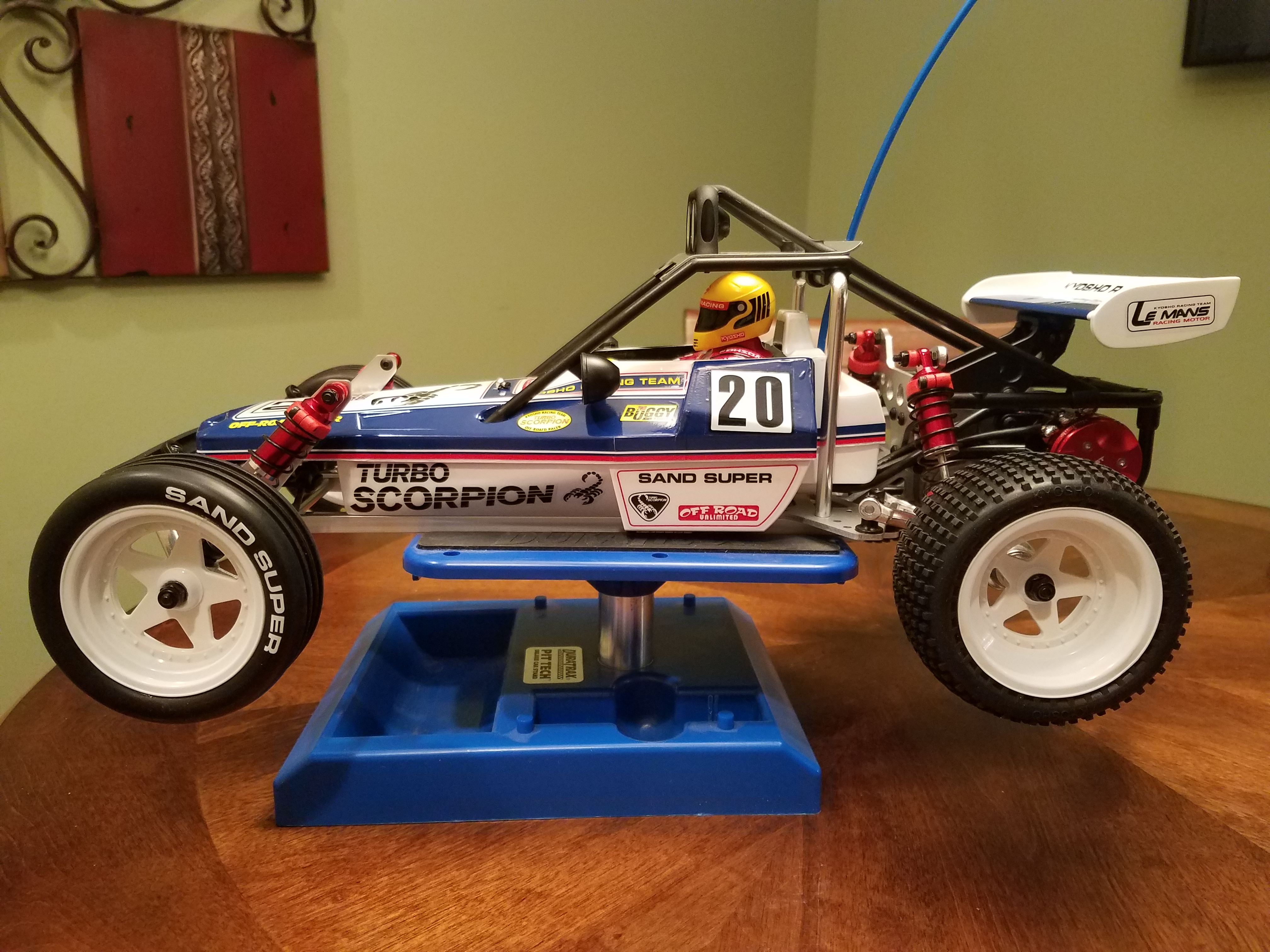

For those who have completed their TS kits, I'm wondering if you could chime-in on your experiences applying the decal set. Reason for my question; Nearly every panel on the body (except the top) receives a complete decal wrap. So Kyosho expects us to simply paint the body one color (white) and let the decals take care of the rest. So, at the decal seams, do they fully cover the lexan or are there places where we should strategically brush-on some dark blue before spraying the white? I'm thinking that recessed area around where the roll mounts and those recessed ducts might need a little extra attention or there could be some white peeking through. I've studied the boxart car closely and I'm pretty sure Kyosho has painted the blue panels so everything looks perfect. Anyway, please let us know your experiences with the decals? thanks

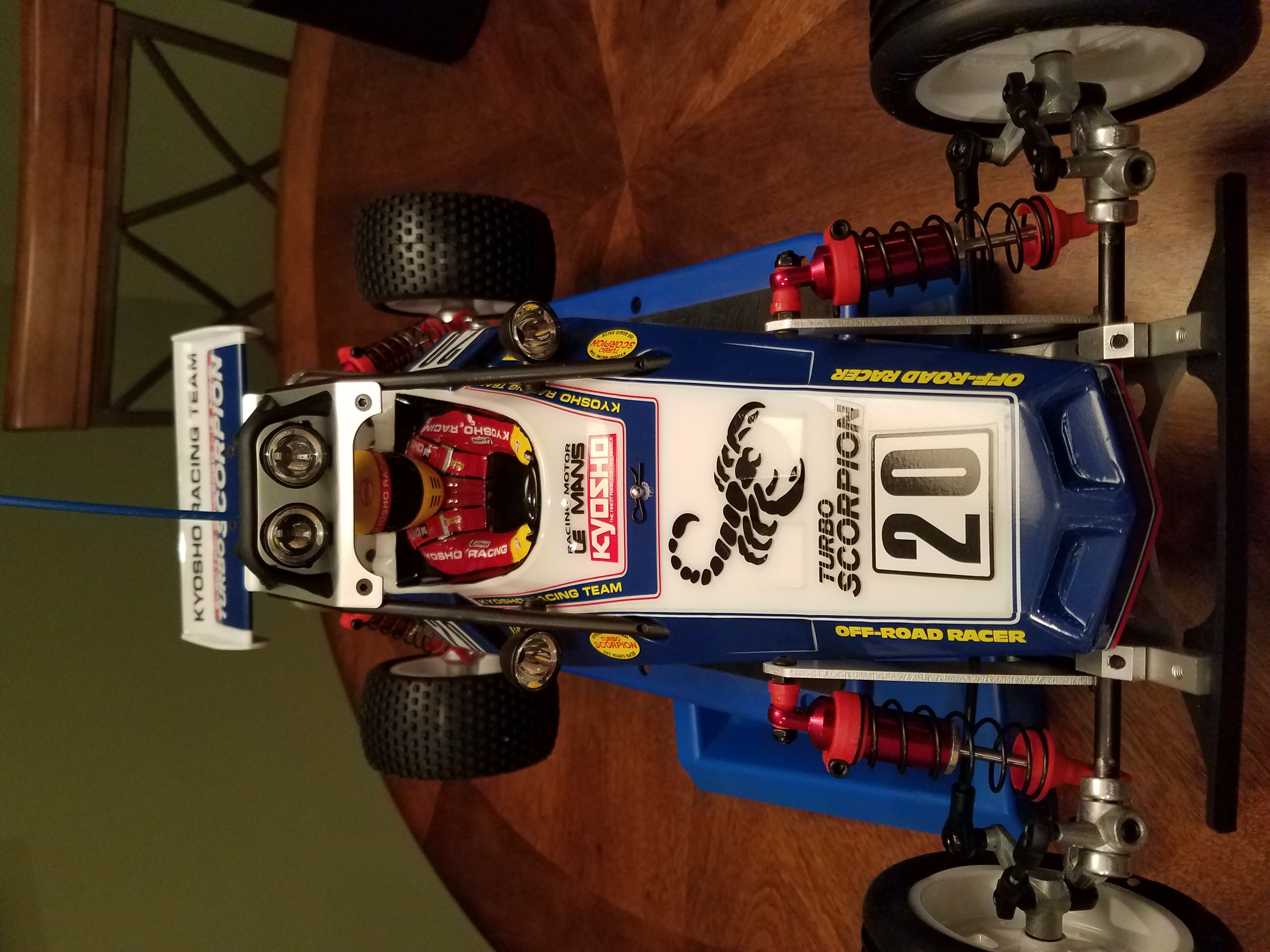

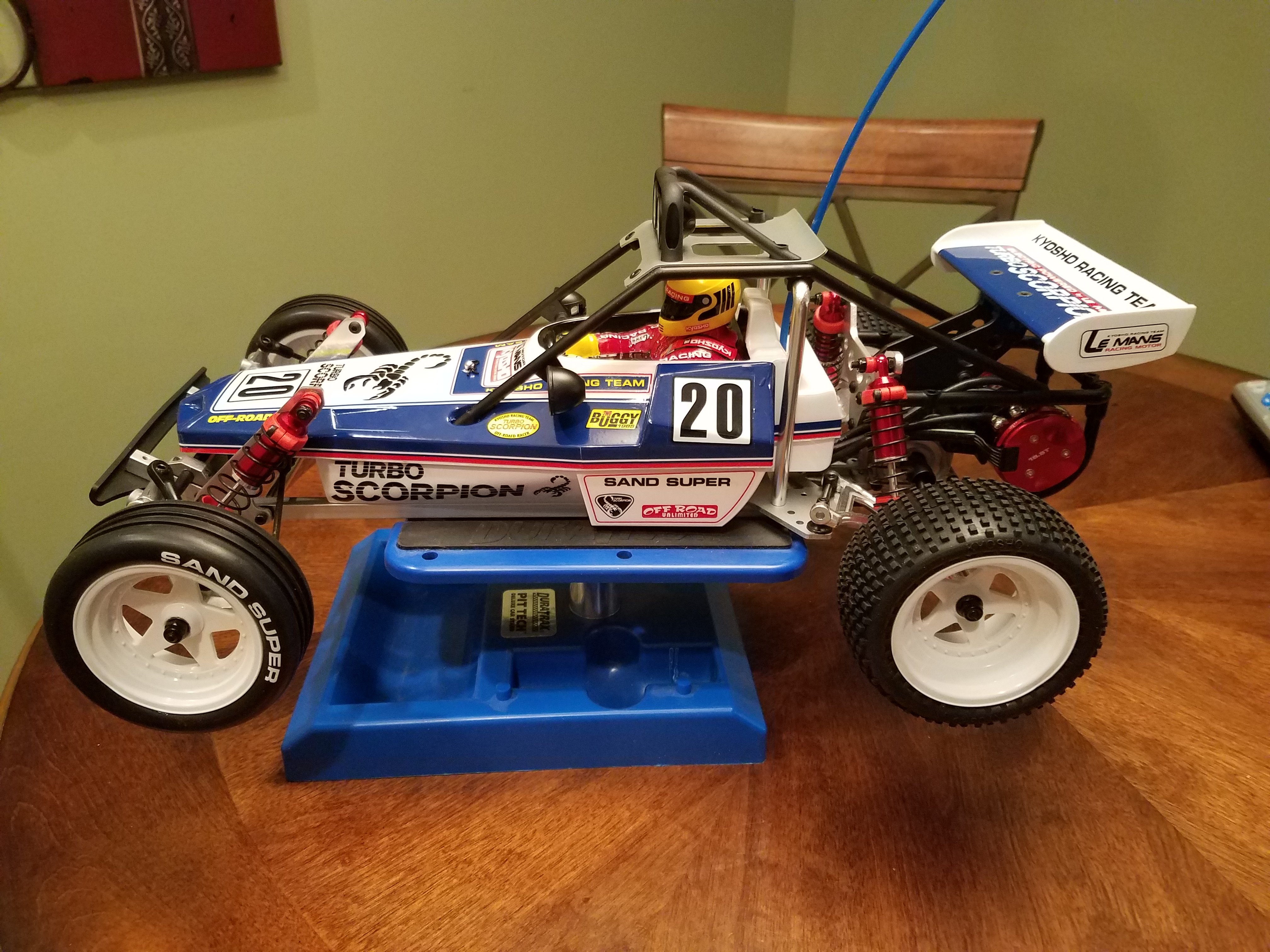

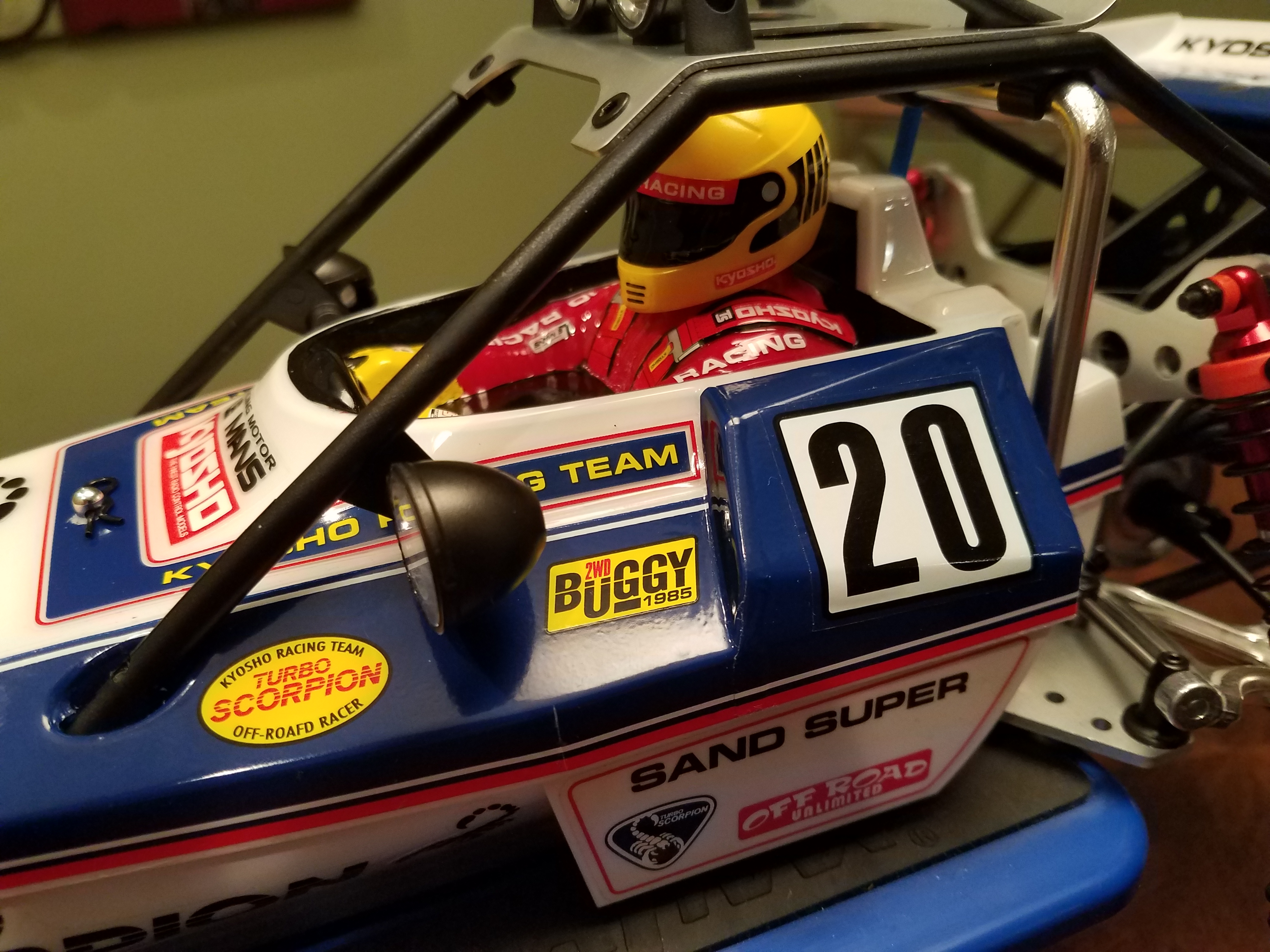

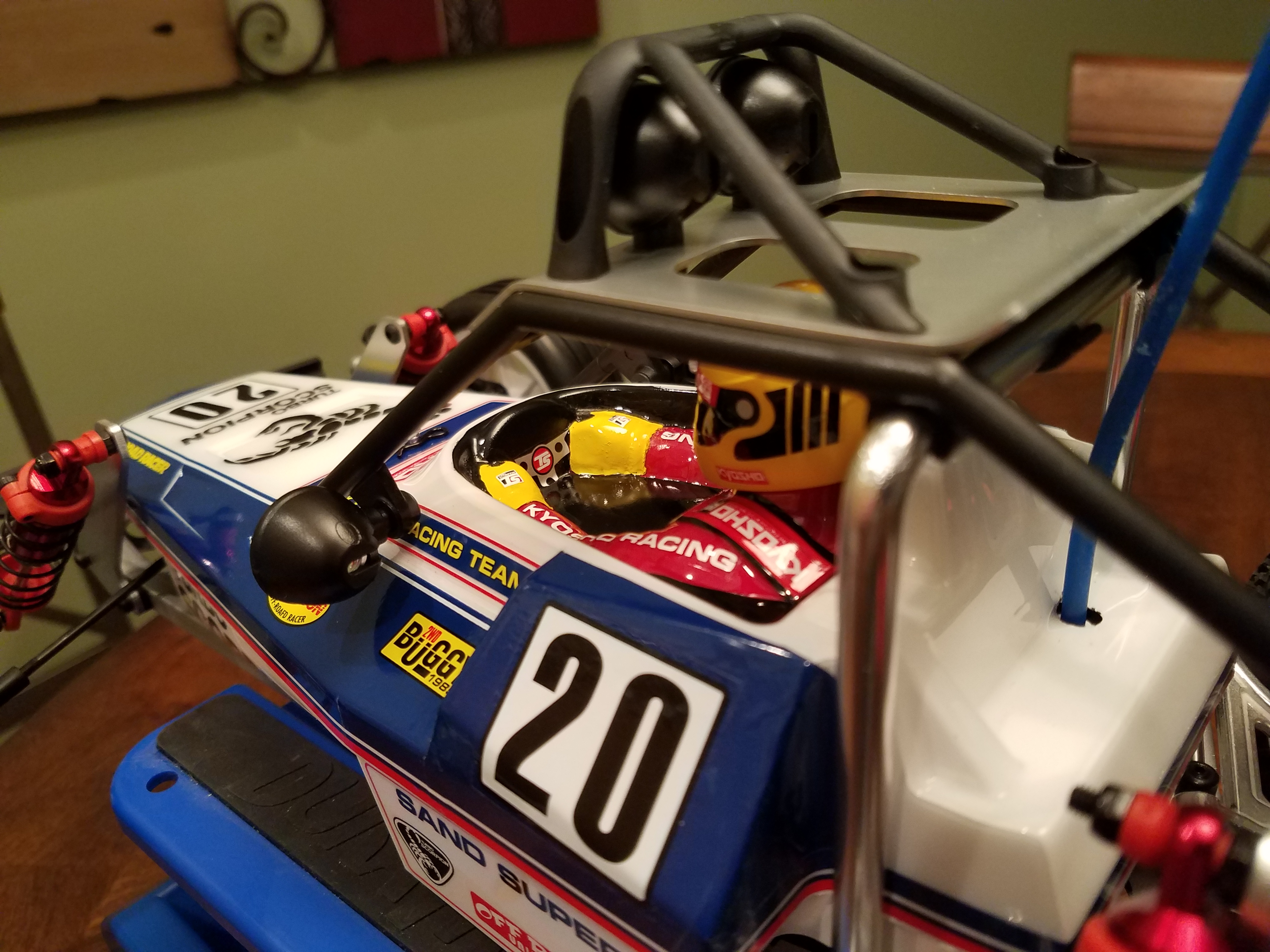

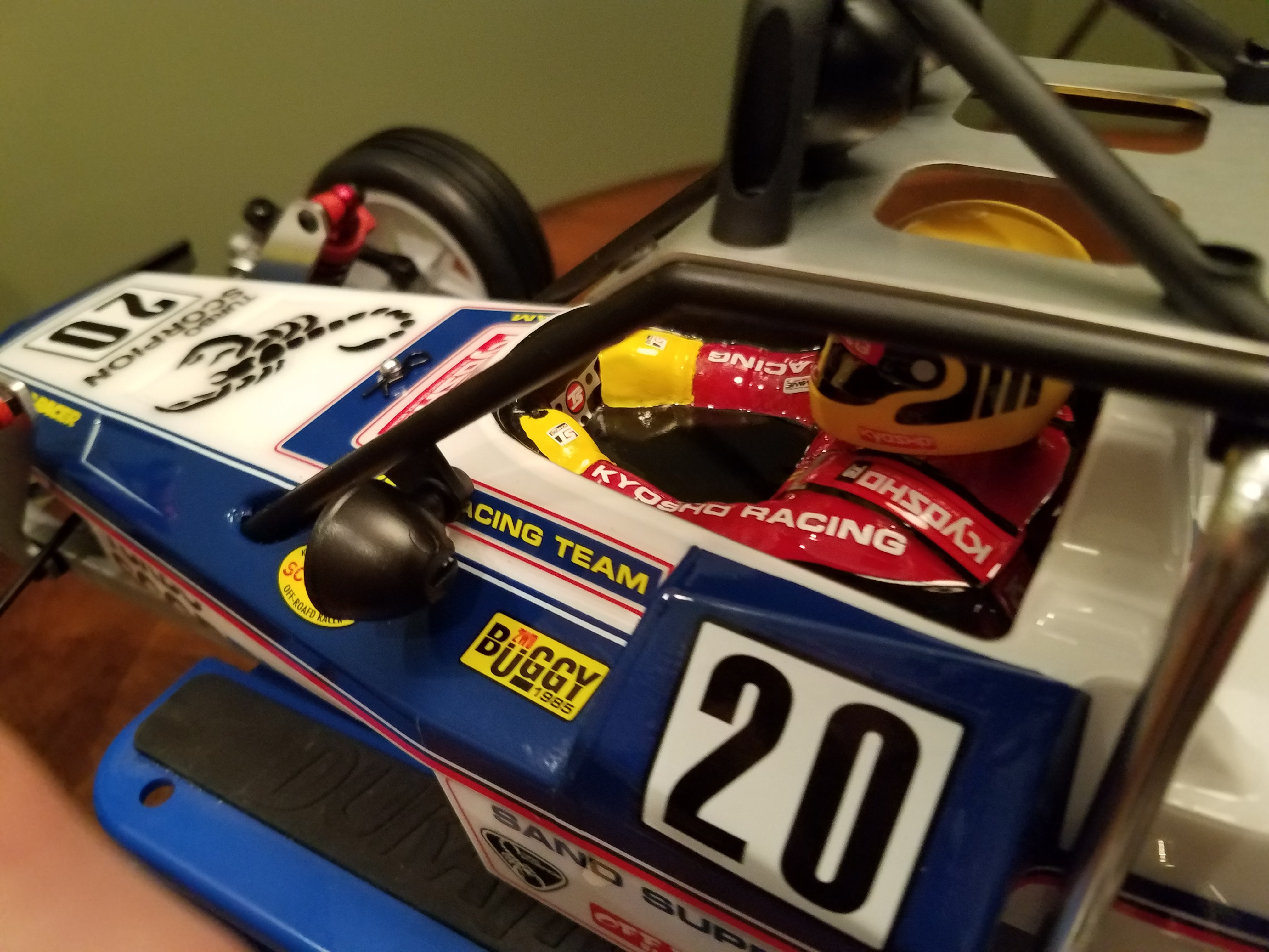

This is how mine came out. The body is simply Sprint White...no blue paint at all...I used only the decals. For the driver, I masked off the interior compartment and painted the red for the driver's suit from underneath. The black for the interior was painted on the outside of the lexan instead of underneath. The body came with an outside mask so it was easy to trim to paint the black. I sprayed yellow into a paper plate and brush painted the gloves. All the rest is supplied decals.XLR8 wrote: ↑Wed Jan 17, 2018 10:38 am For those who have completed their TS kits, I'm wondering if you could chime-in on your experiences applying the decal set. Reason for my question; Nearly every panel on the body (except the top) receives a complete decal wrap. So Kyosho expects us to simply paint the body one color (white) and let the decals take care of the rest. So, at the decal seams, do they fully cover the lexan or are there places where we should strategically brush-on some dark blue before spraying the white? I'm thinking that recessed area around where the roll mounts and those recessed ducts might need a little extra attention or there could be some white peeking through. I've studied the boxart car closely and I'm pretty sure Kyosho has painted the blue panels so everything looks perfect. Anyway, please let us know your experiences with the decals? thanks
Is was a very easy to do & I think it came out great. Then again...this is not going to be a shelf queen. I built it to play with. It's a toy. If I spent weeks painting it I probably wouldn't want to beat the heck out of it.
It is about 75% box art inspired and the rest was simply what looked good to me at the time after breathing paint fumes and after knocking back a few "co-colas".

Anyway...I have to say I was happy with the decals. I used a little soap mixed with water and they were easy enough to apply. If you look at my pics close-up you will see a few bubbles, but those were taken the day they were applied and have since gone away. The decals are thin and very pliable which is a good thing, but if you attempt to apply them "dry" and need to pull them back off it could be very bad. Use soap and water to get the positioned, squegee out as much air and water as you can and then use a hair drier to get them to stick after they are in place. Don't worry about small bubbles...they will eventually permeate out.
