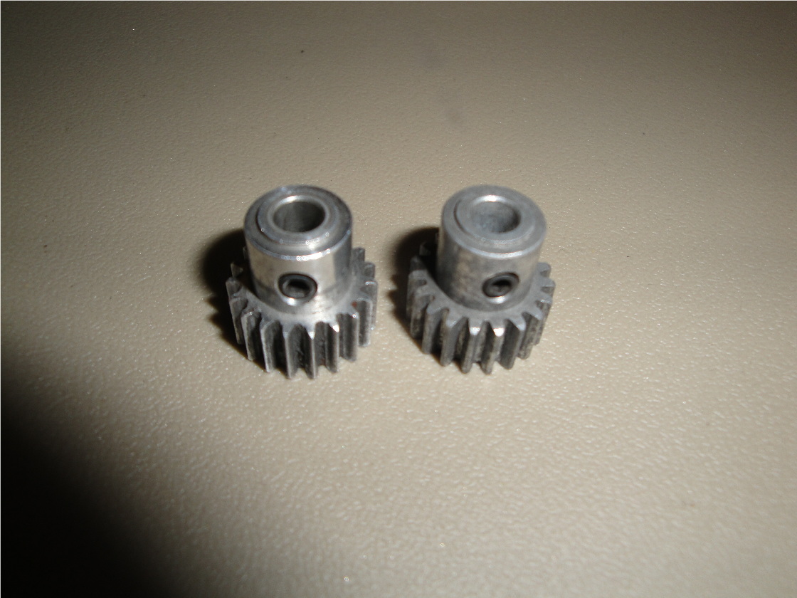

- Posts: 254
- Joined: Mon Aug 25, 2008 11:02 pm
- Location: Georgia, U.S.
Re: Optima 'HARDENED' final pinion gear.
Here are two pinions I have. The one on the left is from a stock Optima parts car. The one on the right is from a stock Optima that had the belt drive and other add-ons (so a hard final pinion would be more possible). They seem different looking to me, is the one on the right a hard final pinion? If not, how do you tell?
Thanks.
Thanks.

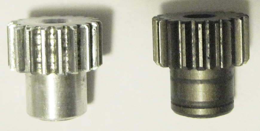

- ROH73
- Posts: 623
- Joined: Sun Feb 10, 2008 12:07 am
- Location: State College, PA
- Been thanked: 23 times
They're both stock aluminum. Hard final pinions are the color of AE hard anodized shocks (gray/olive greenish) and they have a single groove machined in on the non-tooth end (ignore the two shallow scuffs from the chain). See the attached pic (hard pinion is on the right).
- Coelacanth
- Posts: 7421
- Location: Alberta, Canada
- Been thanked: 325 times
My measurements would be nearly identical. I weighed 2 stock alloy gears and both were around 5 grams. The unknown-brand gear I have weighed 15 grams, so it must be a Thorp Dirt Burners gear. I have another but I can't weigh it as it has a shaft stuck through it and it's damn near cemented on with the set screw, I can't remove it and I'd be worried about stripping it out.ROH73 wrote:I put my Optima final pinions on a balance here at work (all sans set screw):
Kyosho Stock Aluminum: 5.33 g
Kyosho Hard (hard anodized aluminum): 5.15 g
Thorp Steel: 15.02 g
It seems lighter than the Thorp one and has a groove whereas the Thorp doesn't, so I'm guessing gear #2 is the hard-anodized unit.
