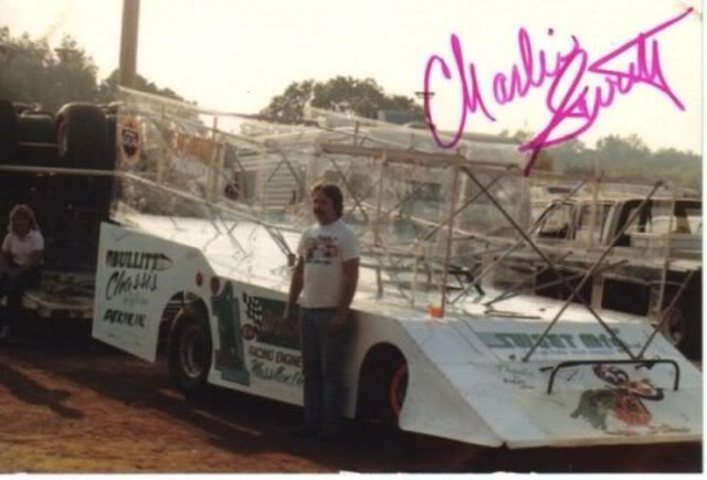

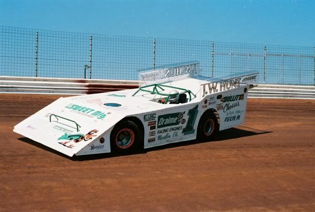

Cool! I have a treasure trove of pics of latemodels my uncle built back in the 80's when he was in business(Bullit Chassis). The first pic is a wild wing set up on a wedge latemodel. The second is something I'd like to emulate with an RC body somehow being able to add the clear wings on the rear.
Sorry for the slight threadjack kaiser!

askbob wrote:Cool! I have a treasure trove of pics of latemodels my uncle built back in the 80's when he was in business(Bullit Chassis). The first pic is a wild wing set up on a wedge latemodel. The second is something I'd like to emulate with an RC body somehow being able to add the clear wings on the rear.
Those pics remind me of the wild dirt late models that used to race at our local track many years ago. This was the most famous car known as the Batmobile. The driver was Mike Blose and totally dominated the field with that car. As the years went on, the rules on side dams became more and more strict until they were completely banned. The last I saw on Speed Channel, that same driver was running with the STARS.
But I don't know which is cooler, the side dam on the car or the cut-off shirt the guy on the left is wearing? :lol:
