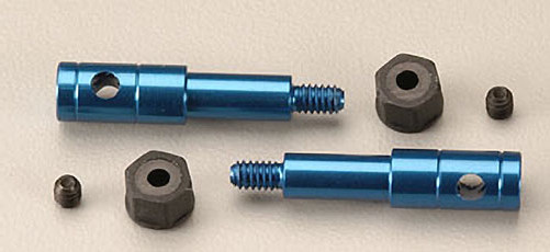

Re: RC10 gold pan OIN build
Instead of the GT front axles, use T4 front axles to get the width. That way you don't have to drill out your B4 front carriers.
ASC7459
Cool, thank you for that...Orange wrote:Instead of the GT front axles, use T4 front axles to get the width. That way you don't have to drill out your B4 front carriers.![]()
ASC7459
