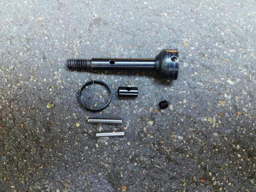

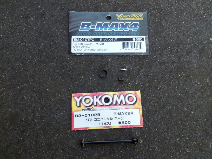

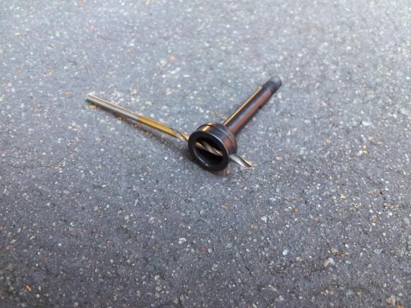

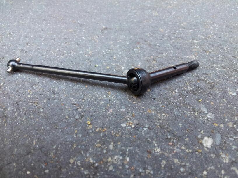

I have found a CVA combo that works excellent with stock rear arms and B4 rear hubs that anyone can put together. I tried the B44 CVA thing and they were still too long. In order to create the CVA you'll need the following parts;
Associated,
9755 Rear CVA Axle
7996 CVA Pin Retainer
Yokomo,
B2-010RB Bmax2 rear bones (x2)
BM-010TPC Universal Joint (x2)
Misc,
5/64 or metric wheel pin equivalent
3mm set screw (optional)
First take your wheel pin and make sure it fits well in the Yokomo CVA coupling, then at least you know it's the right size (the Yokomo ones supplied are too short). Next take the Associated CVA axles and drill out the standard holes with a 5/64 drill bit. De-bur and test with your wheel pin to make sure it slides freely through both holes and that it's not too long or binds. If it's too long grind it down to length.
Next just assemble it as you would a normal CVA using the Associated pin retaining rings instead, the Yokomo ones are too small although they will still work. The pressed in drive pins in the Yokomo bones are ever so slightly too big, so you can do one of two things. You can carefully file out the outdrives (best method) or you can gently grind the pins. Just make sure the bones slide freely in the outdrives at different angles so they don't bind.
Install into the car with all of the spacers on the outside and your done.

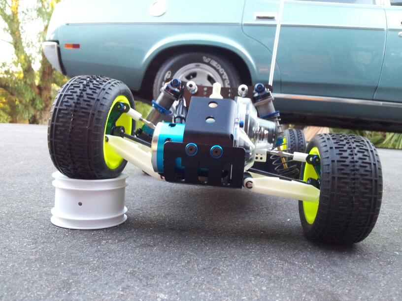

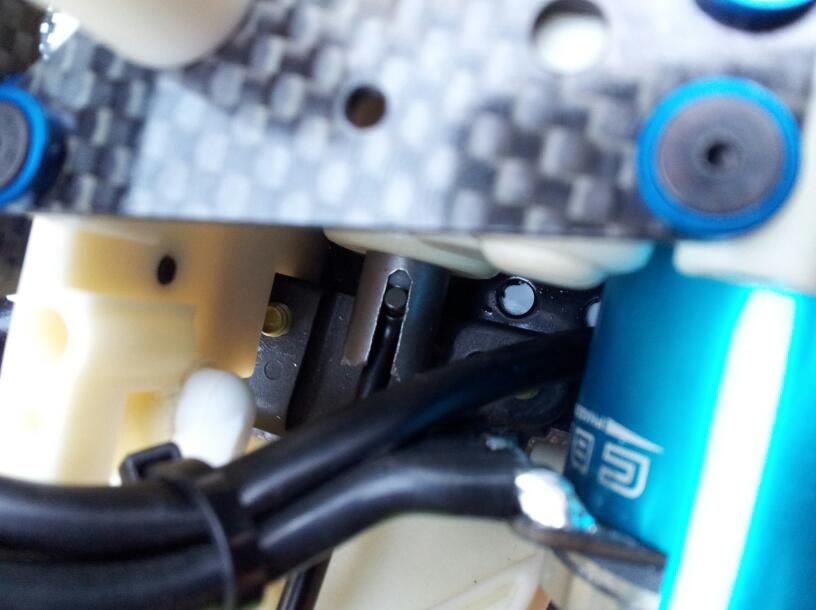

Re: My OIN Worlds whatever you want to call it racer.

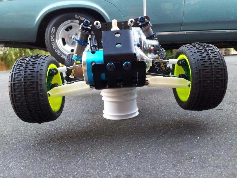

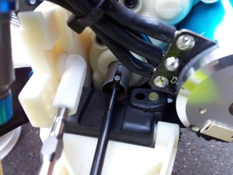

So here is full droop and compression. As you can see there is plenty of room left for the bones if you wanted to run more droop. Don't mind my chewed out second hand outdrives, the replacements are on back order and will be replaced.
I think there is also just enough on the compression side. I think if you skimmed 0.5mm or more, depending on how much material you could take off the inner axle race, you could possibly gain a little more up travel. It just depends if the bone will interfere with the outdrive before the bone bottoms out in the cup.
I should mention that I had to run up-travel limiters as the big bore shocks have too much travel.

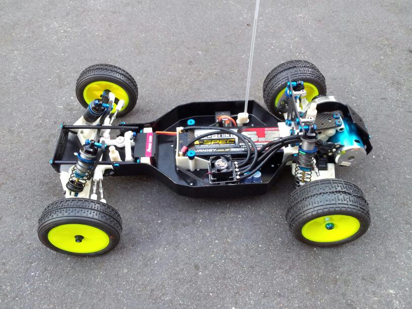

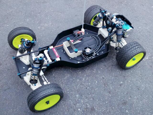

Nearly finished, just need to paint the body now. Worlds chassis are back in stock so hopefully I'll see it in the next two weeks then I can call it done.

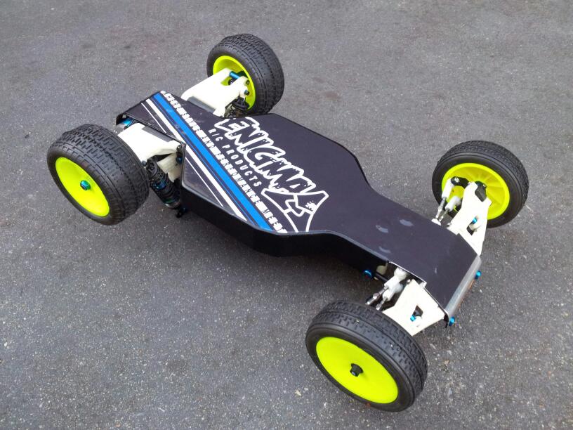

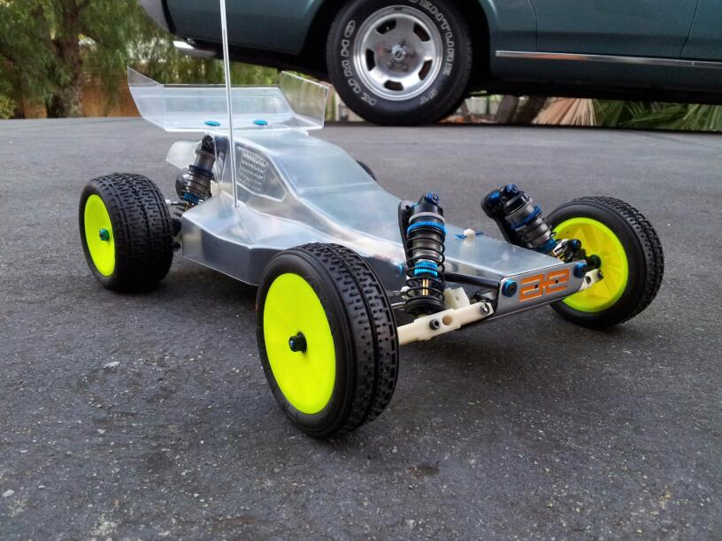

Small update, worlds chassis and nose plate came about two weeks ago but I finally got around to updating this. The body should be done soon and this car should be ready to hit the track.
Hey a quick question, is that a chassis skin/protector on the original chassis, and have you put one on the new chassis?
- RC10th
- Posts: 4761
- Location: Australia
- Has thanked: 52 times
- Been thanked: 1548 times
1300GT wrote:Looks great RJ. But will it hit the track?
This is where I'm torn
Yeah, that is a chassis protector on the old chassis, I peeled it off and stuck it to the new worlds chassis. I used some lower profile screws so it sits flatter. I didn't feel like re-countersinking the chassis, so the screws were the next best thing.mtbkym01 wrote:Hey a quick question, is that a chassis skin/protector on the original chassis, and have you put one on the new chassis?
I'm building my rere-Worlds now with same steering setup. Seems to work nicely.
Sweet build! You mind telling what gear cover you used? I am going with the VTS slipper as well on a build and I like that clear cover.
- RC10th
- Posts: 4761
The clear cover is just a standard B4/T4 cover. You will need to drill a new hole in the motor plate for the bottom screw, or you can just use the top hole but it's not as secure.
