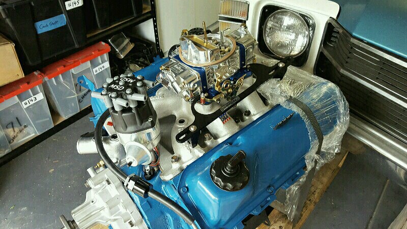

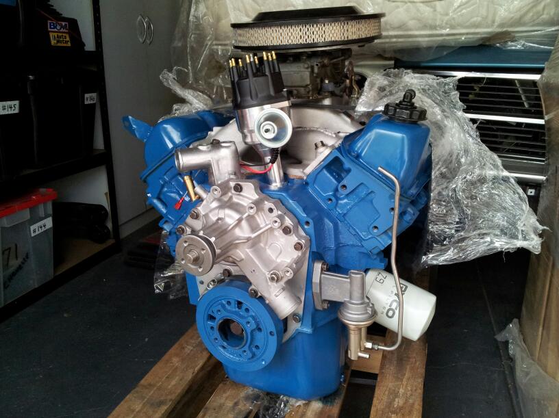

I got the engine back from the builder today and hopefully this little package wakes the car up a bit. The 302 crank has been replaced with a 351 crank, compression bumped to 10.1, rebuilt heads with mild work, a nice cam and edelbrock air gap intake. The engine builder said it should be a good engine (it should for the price).
I'm not going nuts with making everything show quality but it has been fun cleaning and giving parts a coat of fresh paint like the fan and brackets etc. The engine will look good but the rest of the car wont, lol. There is still a bit of work ahead of me as I need to replace the steering box and want to replace the engine wiring harness with one that hasn't been cut to pieces.
We should be back on the road soon.

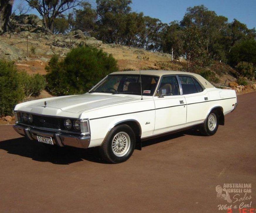

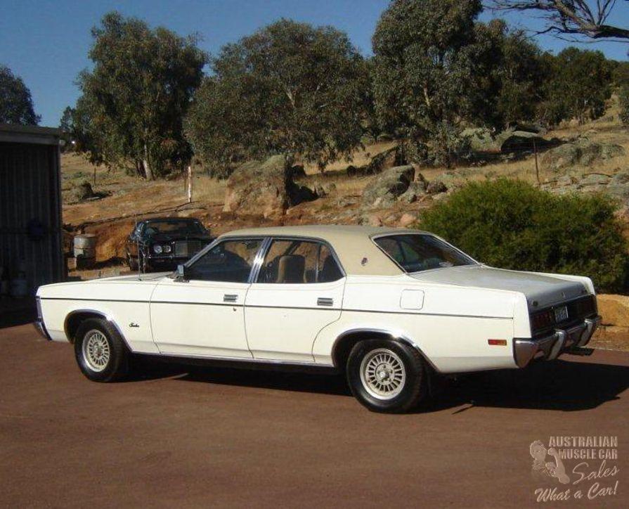

I'm really stuck on the sleeper thing and although this isn't my car I'd love it to look like it. Stock grandpa mobile but will give most new cars a run for their money.
Luckily my car is already white so I just need a set of stock wheels, mud flaps and hood orniment.

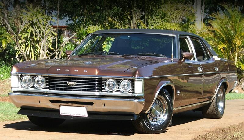

The picture of my car isn't the best photo but it still looks a bit sleeperish now. It looks like an old beat up car, a bit dented and rusty. Currently it has 245/60R14's on the back which grip up pretty good.
The paint on mine is terrible but adds to the patina. It's not supposed to look fast if it's a sleeper.
I'm not a fan of brown cars but this one could change my mind, lol, it's the same model.

Brown isn't bad looking either, the bumper valance on that brown car would look nice on yours too. I still think the color scheme on your car is more fitting than the other two examples. Something is just right about it. It's your car though, as a car nut I just had to put my two cents in.
Glad you chose to put it back on the road instead of selling it off. Wish I had kept my Impala and just put it aside for another day.
Your car with the white and a turquoise pebble grain top would look really nice.

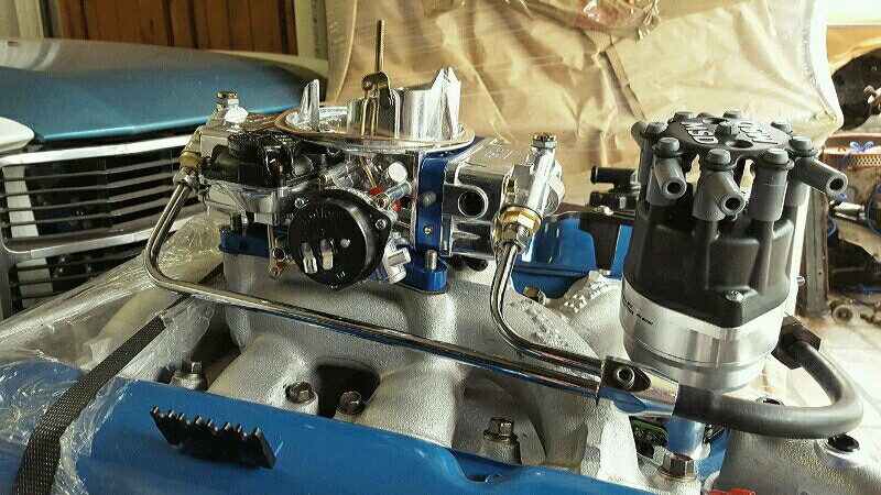

Today I got my carb set up, lines, dist clamp, throttle bracket etc. The carb is a work of art and looks like a jewel sitting on the engine. I mocked everything up and the gas mixer just clears the float screws by about 1/8"! Hood clearance is going to be close as the gas mixer sits higher then a drop base filter, it should fit as I checked and checked.
I wish I bought the Holley throttle bracket instead altough they both look identical. I think the Holley bracket would have been quite a bit more expensive for the same thing. I was also worried about having to re-route the throttle cable to pull from the back side of the carb. Upon fitting it all up I think I can make it all work, hence the throttle cable and return spring adaptors are on the bottom side. The throttle cable pulls from the front side of the carb.
Now that I have the hardware I can bolt the flywheel to the crank and marry the engine/trans on my next day off hopefully.
