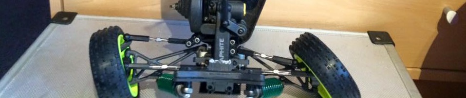

Awesome project! You are in a tight corner up in the front there! To add to GoMachV and JK's notes, it is by design that one can draw imaginary lines that begin at the steering knuckle pins, go right through the tie rod balls, and meet somewhere near the center of the rear axle. It is ackerman and it keeps the front wheels tracking properly around corners.
You can see how it relies on a straight tie rod (hence jk's recommendation). Now the bump steer occurs in the vertical dimension, and will become more and more exaggerated as one shortens the tie rods/spreads the bellcranks...
The tie rods need to be relatively level to angled downwards and not pull or push (steer the wheel) when you compress the suspension. It rc, the most common adjustment is to put washers under the ball studs to modify the vertical tie rod alignment. But as you may see in the drawing above (if you stare at it long enough), the upper a arm (tunbuckles in our case) also come into play. Keep at it!
At days end, your tie rods lengths and alignments are going to be more critical/unforgiving than the drive bones. ie the tranny may need to move in v2

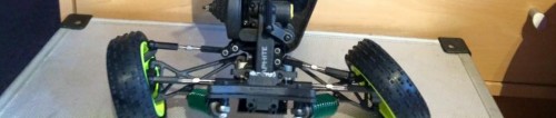

I raised the ballstuds 3mm on the steering block, removed the washer on the bellcrank stud, and moved the upper tie rod inwards. A considerable amount of bump steer has gone, although not altogether.
As for the bellcrank linkage, attempt number eight is the best it's going to get. The trade off being I had to move the connector 3/16 back as the U shaped tie kept hitting the transmission. The bellcranks need to remain where thery are in order for the ballcup to tuck into the notch of the gear housing and the output shaft. You can see from the pic, it's tight in there.

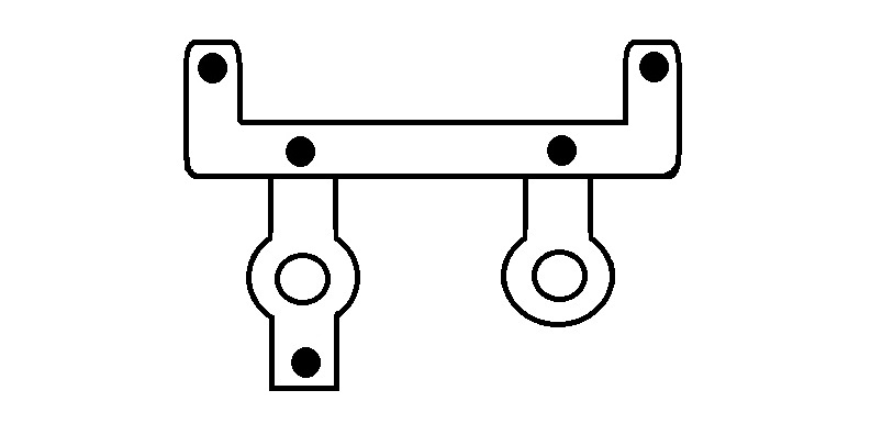

It appears in this photo you could go underneath the shaft input?
Pardon my crude MS Paint drawing, but hollow out the center (or relieve the top or bottom only) and put an ackerman link here? Use thinner CF stock, maybe 1mm or 1.5mm?

You can drill two small holes behind the tie rod ball ends and run a simple z link made of music wire, like a yokomo yz10, and put a profile in it to curve under the trans. The closer you put the tie link to the front will reduce slop.

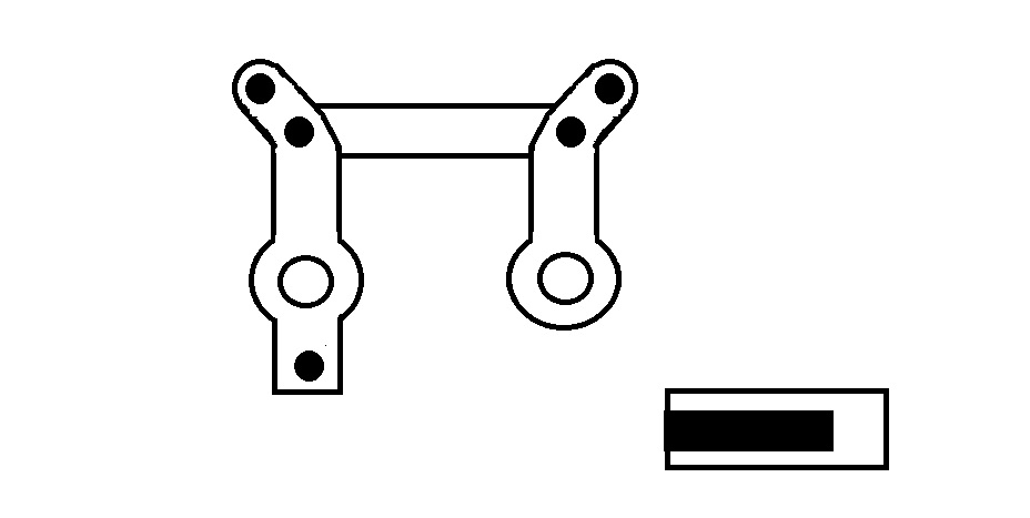

Yeah Bubbleboy if it were me I'd play around with a design more like an A&L kit, where the CF bar is the center link and direct tie rod connection. The one that Daryl has that's got the bend in it (I believe intended for 10T's?) may even work. The last steering kit I got from him came with like 3 different linkages but it's pretty easy to cut your own, as you've already done.

Taking Brian's advice and idea...and I had a few minutes, I revised my drawing some...

Thank JK. I might give that design a go on the next one of these I build.
